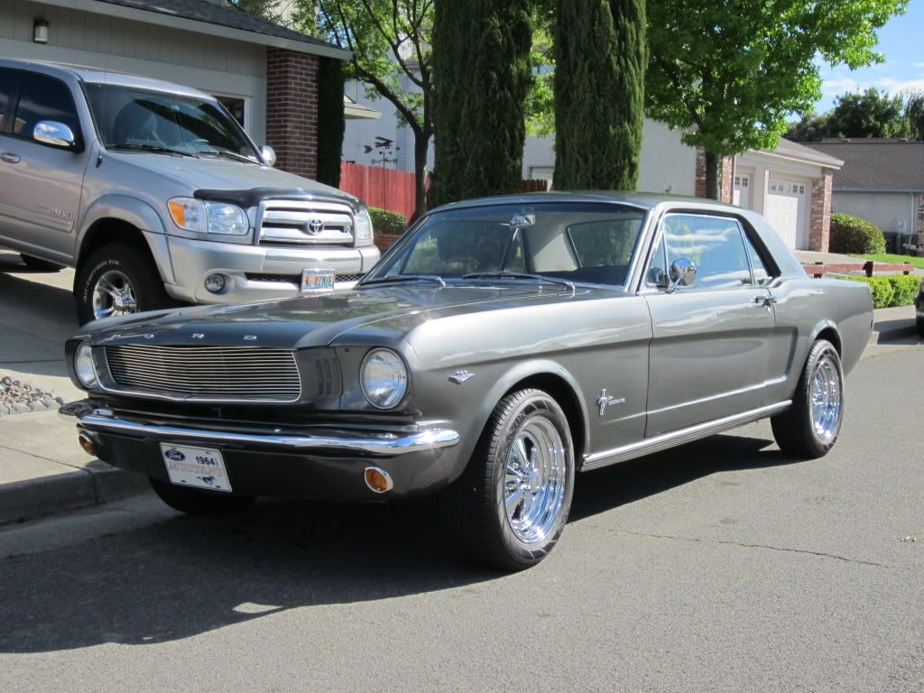

Also, it might just be a bad reflection but in the first pic it looks like it has disc brakes on the front wheels. :roll:
