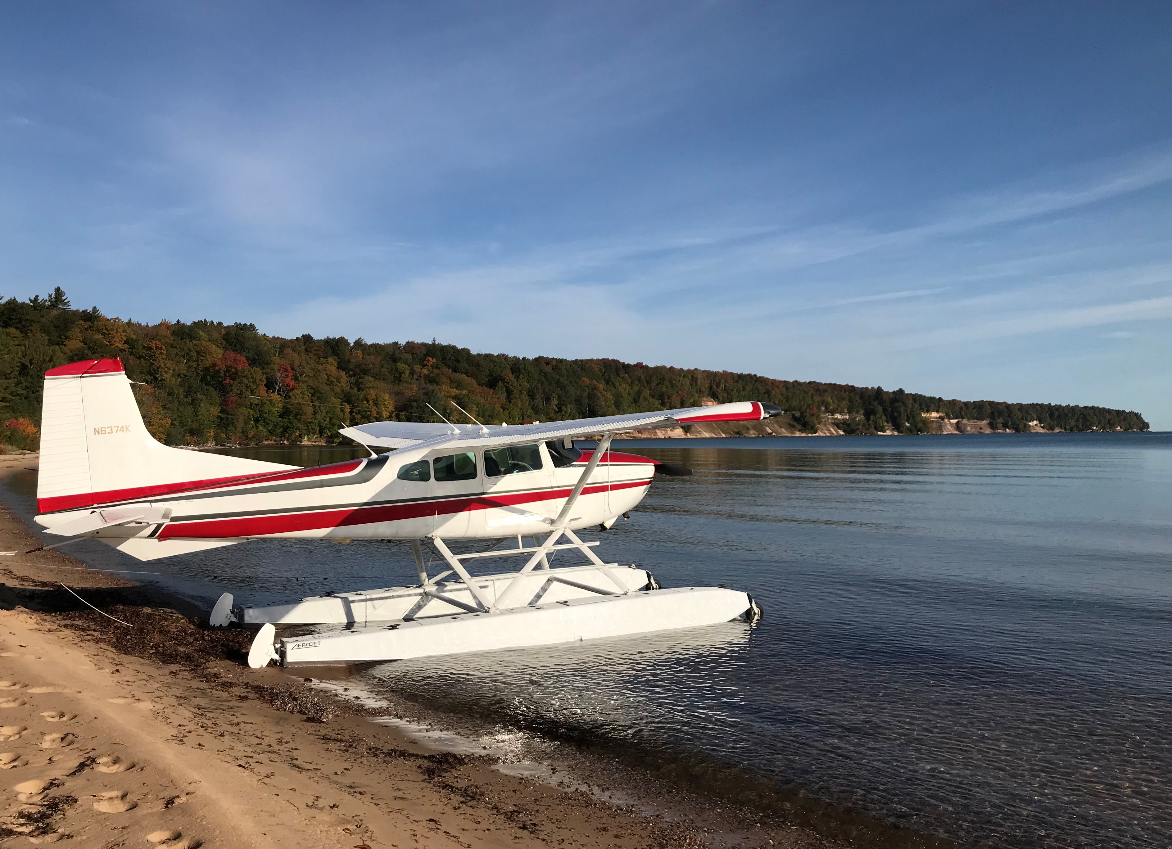

Grand Island Michigan - Lake Superior 30 Sept, 2021
I have wonderful thoughts on the 180K, every day!
180K - O-470U Aerocet 3400 driver, here. Almost always at max gross in Wisconsin & Michigan (1,000' MSL). If you know-how, you can do it. If not, it just takes more time on the ground/water. Climb is climb and '47K doesn't have it. This plane is wanting a PPonk in the worst way but I'm extremely happy with what I have. Engine logs say it's time but engine performance and oil consumption says why now? I would not shy away from this platform and if you can grab one with 520 cylinders already mounted and the prepurchase throws no big flags, jump!
Also, thank you all. I've been a long-time viewer of the site and have learned a lot from your experience and wisdom. There's also been some entertainment, too!
