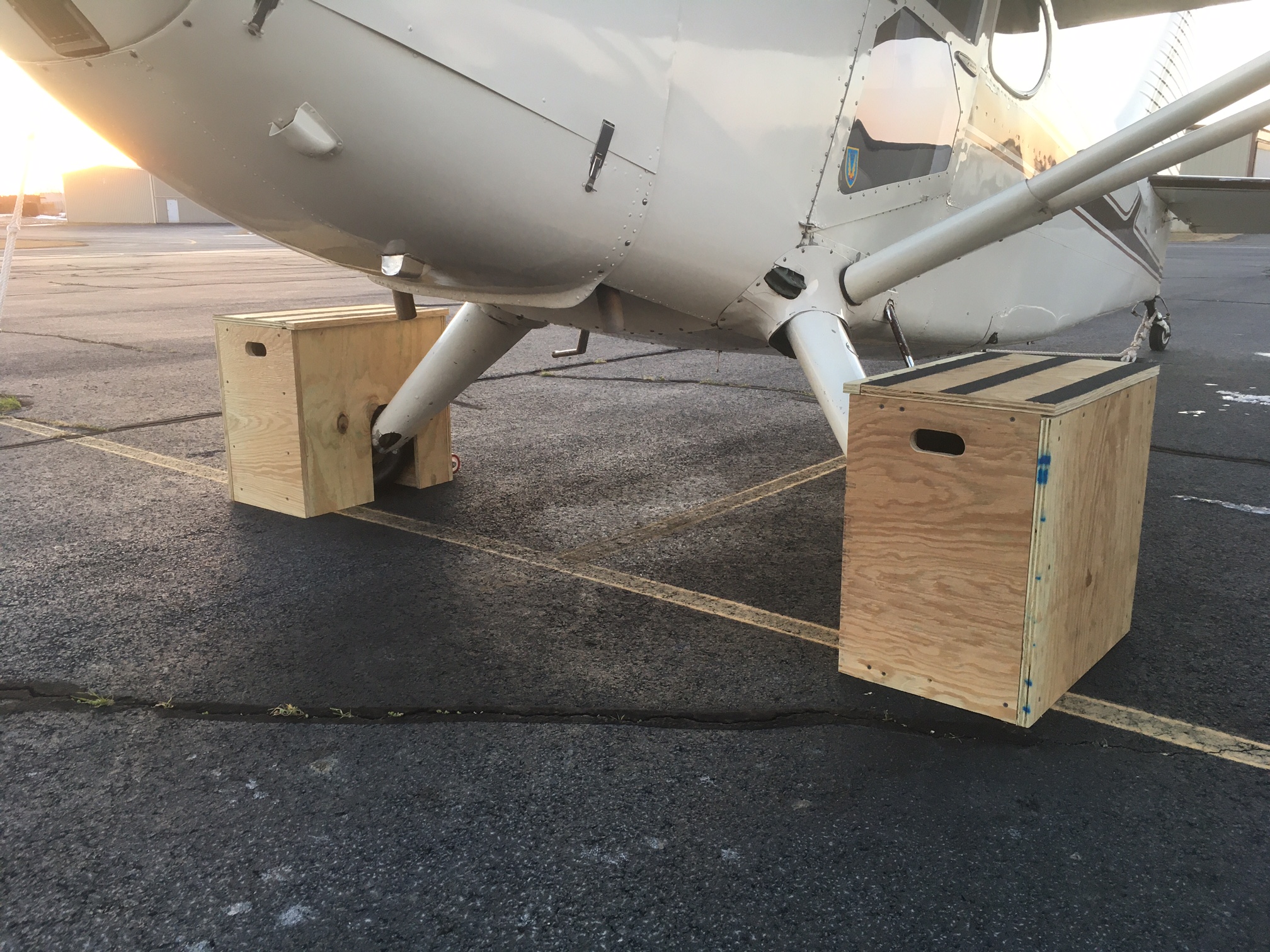

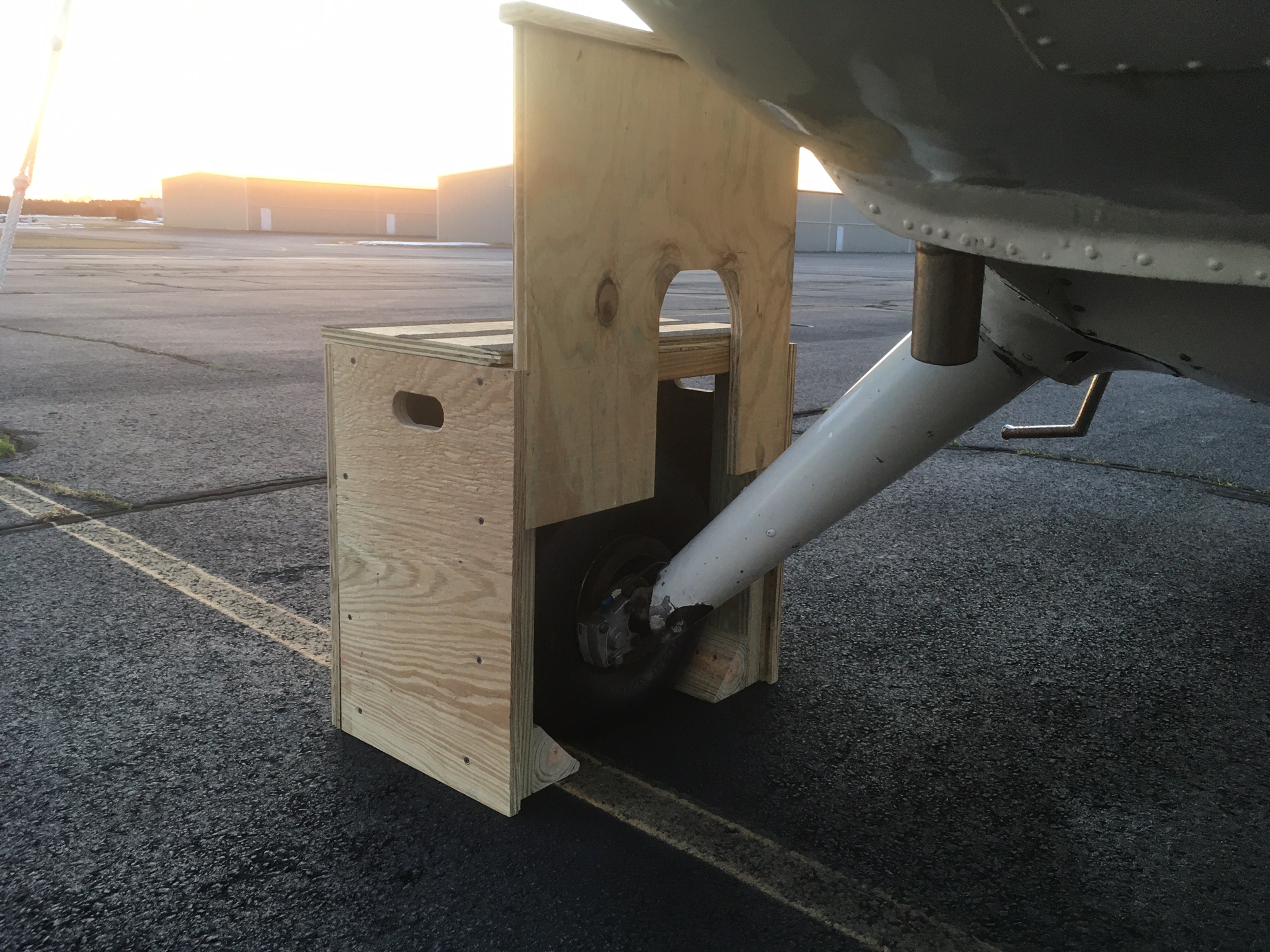

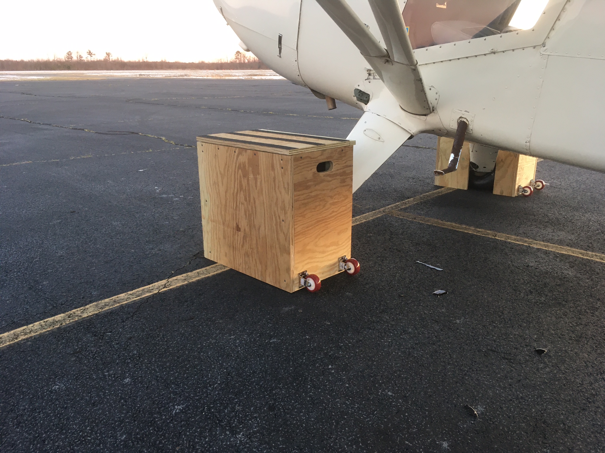

Wanted to follow up with some pictures of what I came up with. Hopefully it will help someone else interested in something similar.
I built in chocks to the boxes, so the boxes slide in and then a back panel that is tongue and grooved slides over and covers the backside. Casters on the end make it easy to roll around and they work great as stands to clean the top of the wings.
Super happy with them and thankful for the inspiration I got here!
