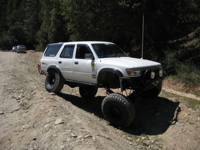

I'm looking forward to the combo. I currently have 8.00X6 carlisle tires on there and people have commented that my plane has "huge tires" wait till they see it now. The Yota is my other toy. It has a straight axle out of an 83 Toyota. Those are 37" Goodyear MTR tires. It also has dual transfer cases with a final drive of 223:1 with 20 forward gears and 4 reverses. Chromoly 30 spline axle shafts, cryoed inputs and outputs, full spool detroit lockers, blah blah blah.
The "note" on my plane was a spec sheet. This pic was taken at our open house last year.
The Runner flexes okay I guess.... :D

Sweet ride! My co-worker is in the process of modifying is Toyota FJ so he can run the Rubicon Trail one of these days.
Re: Worth the effort to cover gear legs?
Very nice 3rd gen, I know what it takes to get it that way too. I'm sure you have good stories about running the Rubicon. Moab much?
mountainmatt wrote:I know what it takes to get it that way too.
A smaller airplane and....
$$$$$$$$$$$$$$$$$$$$$$$$$$$$$$$$$$$$$$ :lol:
