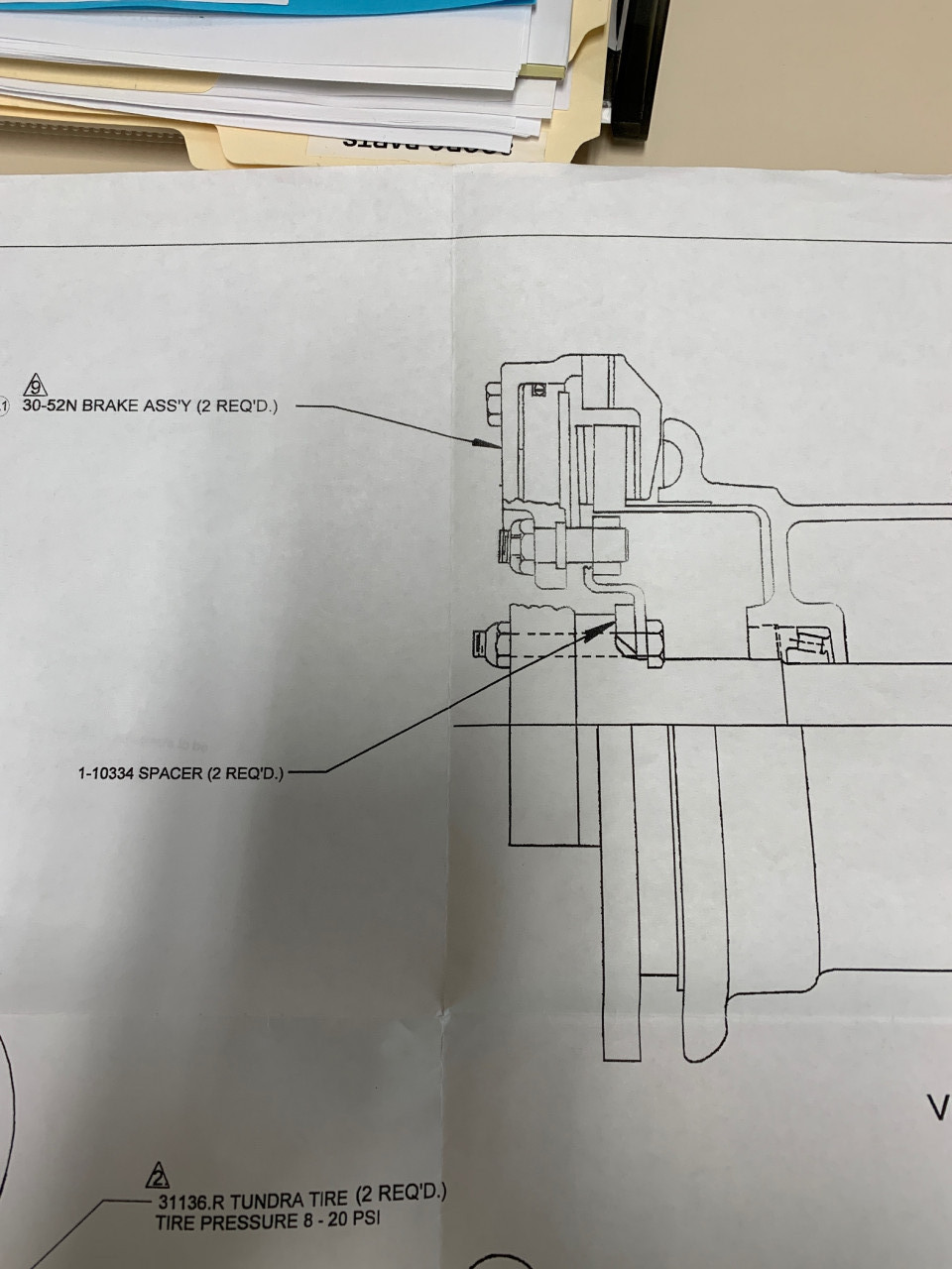

The ACA drawing for bushwheel installation has the correct axle and spacer P/Ns:
Old:
New:

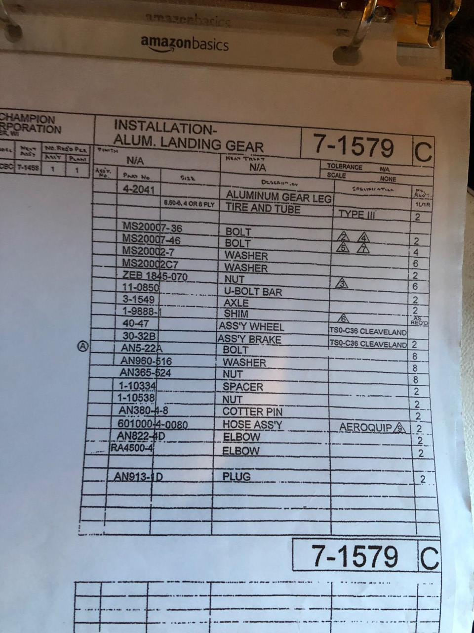

Drawing BOM for your current setup. You can see the different axle and spacer setup.

Bigrenna, yes those tires are approved. You can't see it but that drawing ASA attached has those tires listed in a note.
