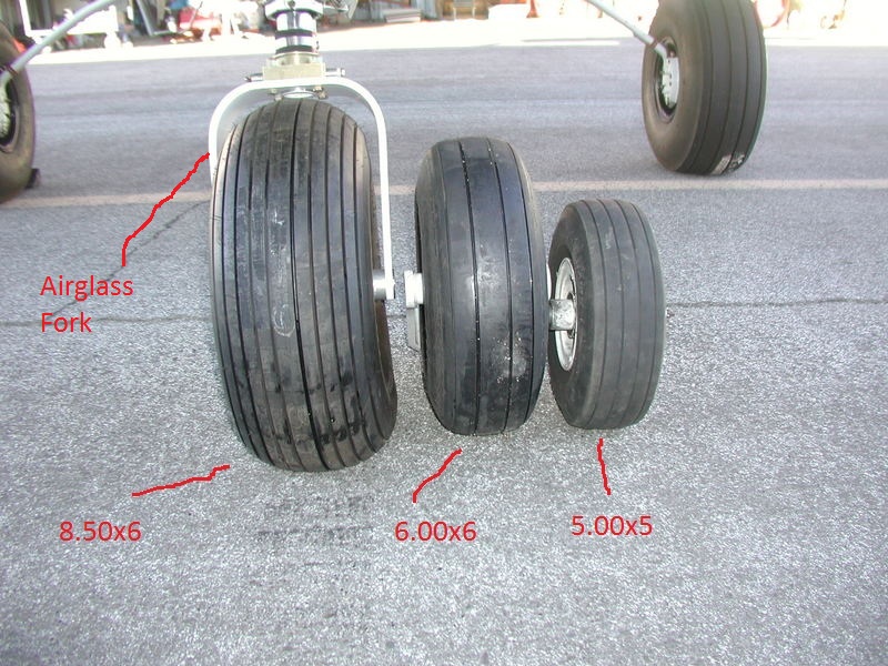

Airglas nose fork for big tires all around

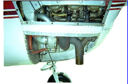

The remote oil cooler that fits in the nose gear tunnel is a good mod. Really keeps oil temps from running near the top of the gauge. It did for the turbo models anyhow.

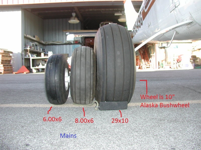

10" Alaska Bush Wheels

Do you have more information on the intercooler and oil cooler mods? I did some looking and couldn't find much.
macica wrote:10" Alaska Bush Wheels
Thanks macica, what advantage do the 10" wheels offer?
Thanks macica, what advantage do the 10" wheels offer?[/quote]

I’m pretty well sold on needing the oil cooler relocation kit. I have an email out for pricing.

Probably a Cessna 310 nose fork. Best for that purpose is the Airglas nose fork, because: a) It is STC'd, no field approval required, b) It's STC includes a wide range of tire sizes for both the nose gear AND the Mains. Again, try getting a field approval for bigger tires in most FSDOs these days.

Airglas Nose Fork, with 8.50 x 6 mains and 8.00 x 600 nose tire.

I have field approved 8.50 mains and 7.00 on the regular HD nose fork. I doubt I will go any bigger than 8.50s on this plane unless I get another just for XC since I fly XC 80% of the time.
That said, does it make sense in my case to get the STC fork? I could see maybe going to an 8.00 in the front, but is that worth it?

if you want more of a slanted look. a few lbs more weight way up front and more fw CG. or you want to land on softer stuff. Get the expensive steel fork an 800.
otherwise the 700 sounds good. im putting your same fork and a 700 on my 206. appears I have tin foil thickness of clearance between the fork and tire...
