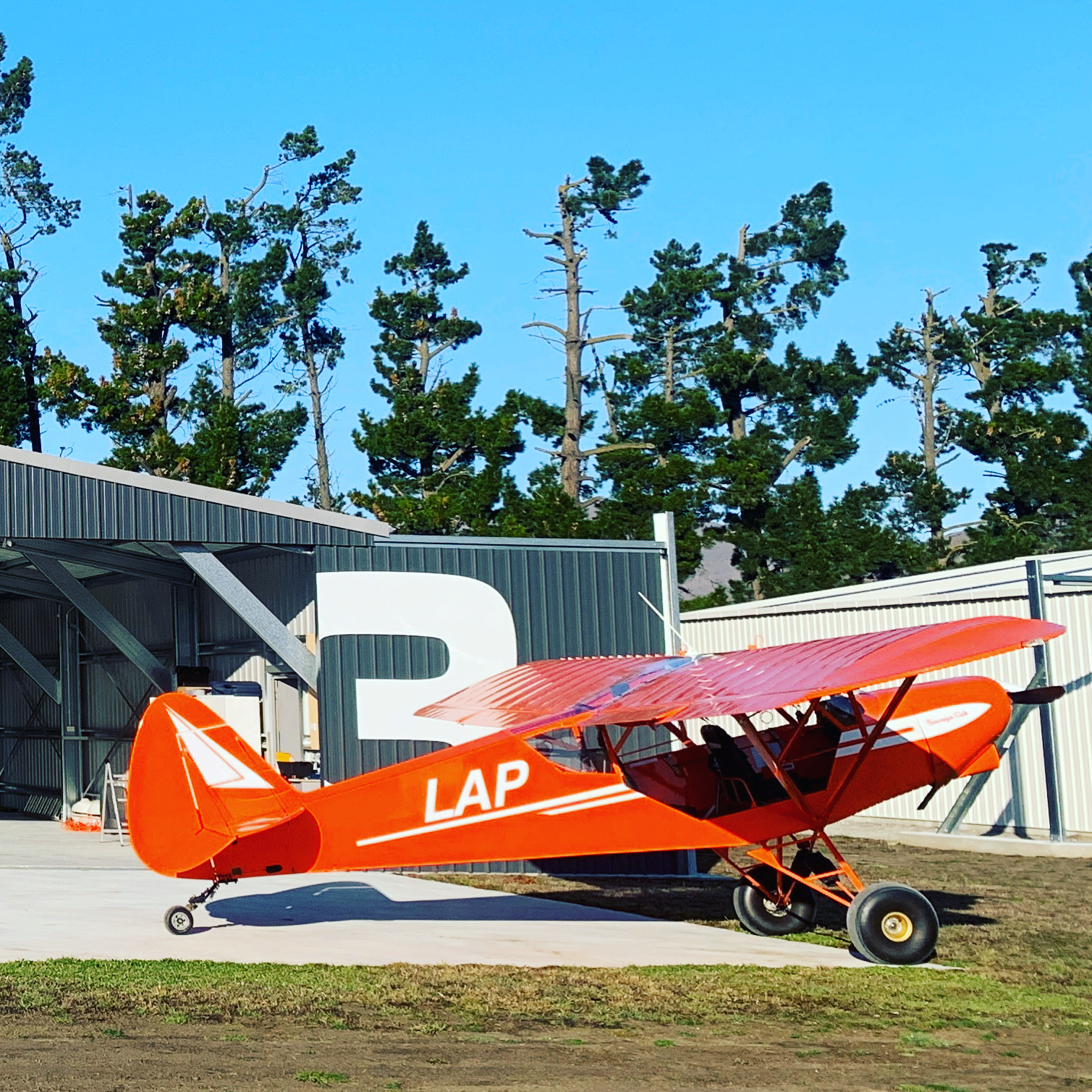

Hi, I have purchased a near new Savage Cub, it’s pretty much in stock form except for extended landing gear. I’m currently working through my tail wheel rating in New Zealand. At some point in the future I want to upgrade to 26 Alaska bush tyres, acme aero shocks and the T3 tailwheel shock with a larger tail wheel.
Can some one recommend in what order would be the best to do the upgrades as I need to spread the cost over 12/24 months??
Thanks for any help

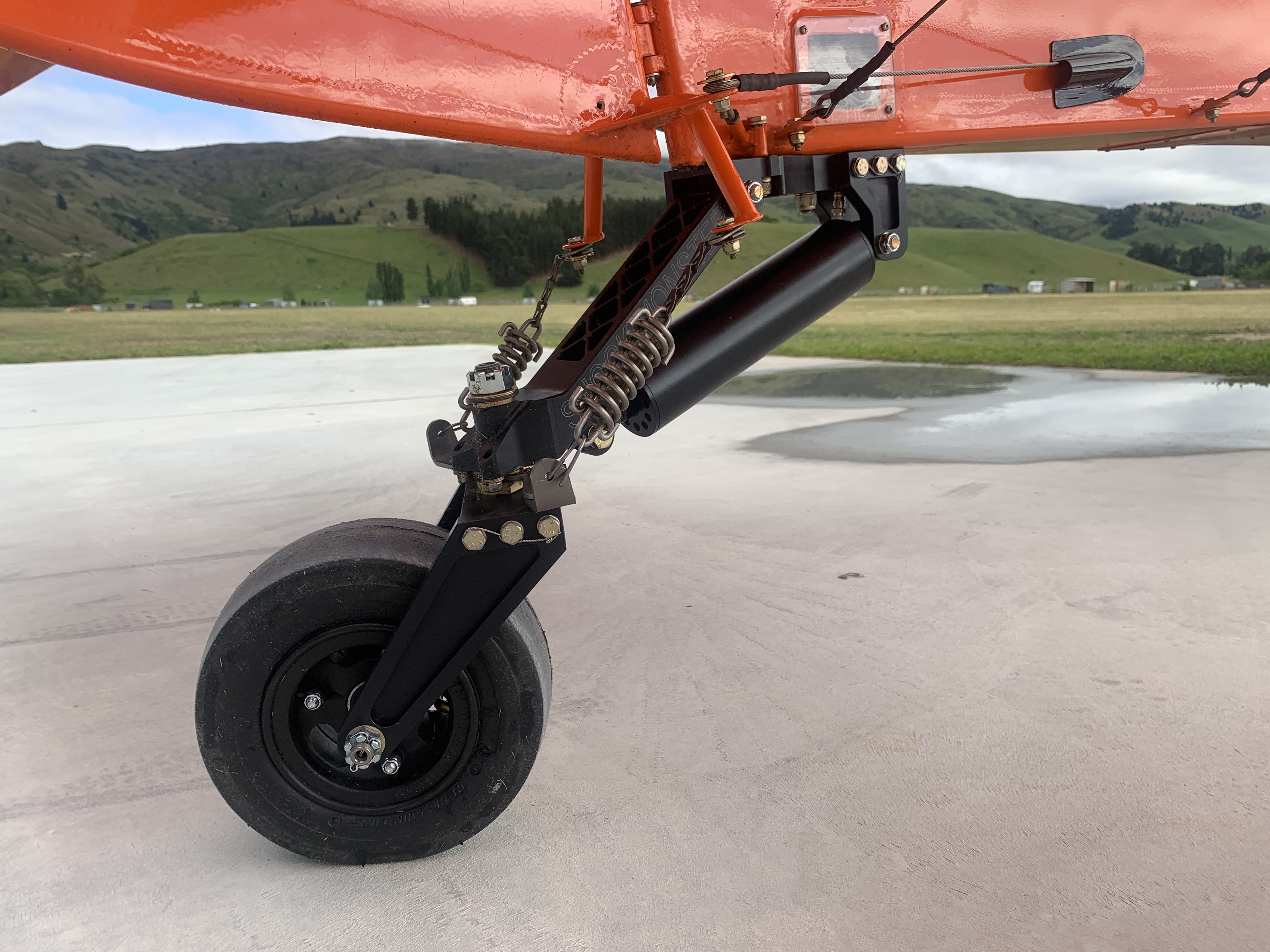

Have now installed the tail shock and wheel. Had had to delay the 26 tires purchase with the way the US exchange rate as gone vs NZ….
