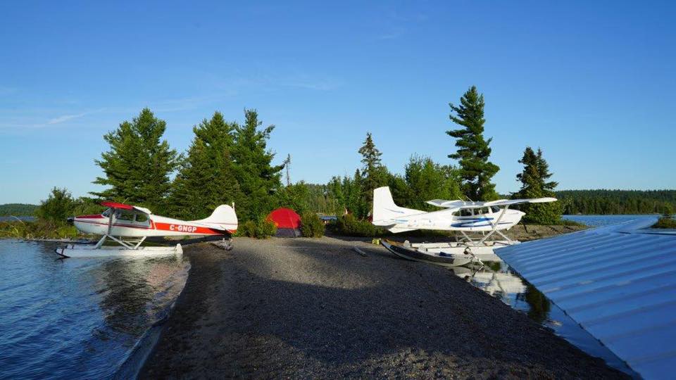

Lady Evelyn Smoothwater.jpg (63.64 KiB) Viewed 2466 times
My 0-300 hasn’t let me down yet but I have some friends to carry the extra "necessities" for me :wink:

So do you drag people around on the SPLASH ZONE with that 170? Looks like that could be a hoot!
