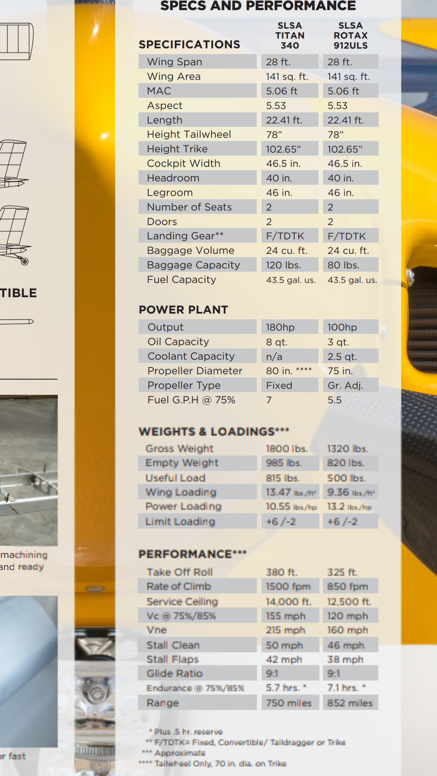

Did some research on the rans s21 outbound. Awesome looking plane. Love the cruise capability. Had a question that maybe someone will have an answer for. When looking at the specs , Titan vs 912, the plane actually loses range and stol performance with the larger engine. The range is understable I suppose. In a perfect world that would not be the case. But the roll? Does anyone know how they rate there take off distance at rans? Is this just no brake full power? Or do they brake it up and take off proper stol style and still end up in the 300ft range somewhere? Seems as though the larger engine is only good for 30mph on the cruise and you are punished almost everywhere else that matters if stol is your game. 30mph cruise increase is a very large jump and would be nice. Considering 4 cylinder turbo Yamaha power. In the 240hp range. While saving weight over the 180hp Titan. Anybody with a similar plane and power/weight ratio have any real world numbers? Stol and cruise? I'm sure engine package with turbo will be in the 190-210lb range depending on some factors.
Any info greatly appreciated. Email to sans would probably be appropriate. Just don't want to bog them down with questions until I'm a "right now" buyer. Sounds like busy folks over there.

Msmithabr wrote:Did some research on the rans s21 outbound. Awesome looking plane. Love the cruise capability. Had a question that maybe someone will have an answer for. When looking at the specs , Titan vs 912, the plane actually loses range and stol performance with the larger engine. .
Thanks,
Mike
M:
Not sure that I am looking at the same specs as you? Looked on Rans website and takeoff roll is better and landing distance is about the same with the 180hp?? They are projecting empty weight goes up about 120lbs with the Titan (hard for me to believe that it is that much heavier than the Rotax???) and that with increased fuel consumption will translate into less distance, but I think the STOL capability is probably better or at least as good.
I talked to the RANS guys in OSH and there is not yet a flying S-21 with the Titan Engine, just the Rotax. So, as of now, it is speculation. They do have flying versions of the S-20 with both the Rotax and the Titan to compare to and considering the similarity of design, their numbers are probably pretty accurate. However, as yet, they haven't got a flying example.
I agree with you it sure seems to be a good combo of speed and short field capability. They seemed to think they would have a flying version of the S21 with a Titan later this year. Will watch that with interest.

These are the specs I was referring too. Downloadable PDF on there website.

M:
That is weird. When I log into Rans, this is what I get
https://docs.wixstatic.com/ugd/6e941e_a391c0c96a5f4f35a720e06bccef3d91.pdf
At any rate, have a real hard time believing you won't pull out of the hole quicker with the Titan. Will be interested to watch the results of this plane as some are built.
Also will be interested to hear more about Yamaha engine. If you decide to go that direction, let us know how that works out.
Regards, L

I'm thinking they do the numbers at gross weight, which is 480lbs higher with the Titan from what I'm seeing. I've been wrong many times before though, so......

Hozer wrote:I'm thinking they do the numbers at gross weight, which is 480lbs higher with the Titan from what I'm seeing. I've been wrong many times before though, so......
That's what I was wondering. If that's the case then I believe the roll data.
