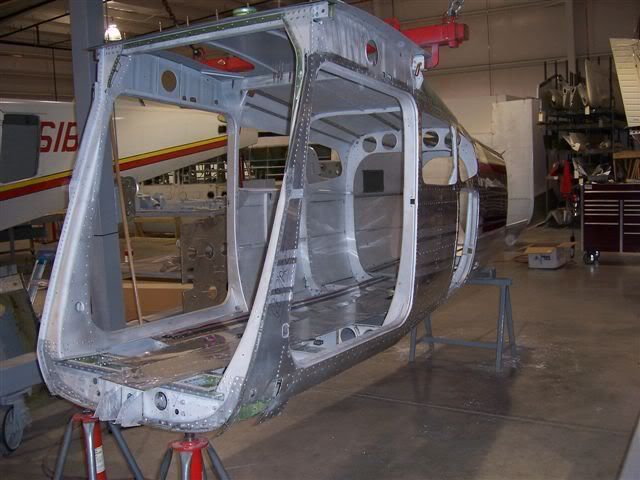

These skylights and stiffeners look a little different. This is George Mandes project.
Correction,
That was George Mandes's project that is now finished and flying. Probably one of the nicest 185 Cessna's that you would ever see. I think the skylights on that were an option. I am going to research the 170 and see if they were an option.

What I was interested in is that the 2 stiffeners are in the same place as one with no skylights and the SL's are farther outboard. The top skin is similar for 170,180 and 185 I think.
