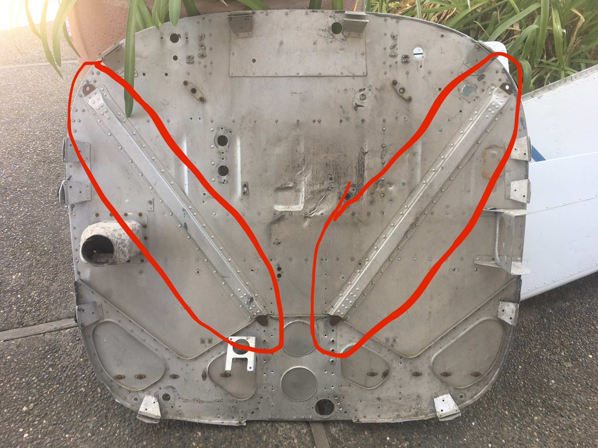

Hey CParker,
Did you ever figure this out? I will have the engine off this week and am putting together SK182-44c for a 182A which has similar parts as the kit you listed. I cant find both of the stiffeners but did just find this salvage piece that I could take them from but the plane model and year isnt marked on the firewall... Sooo I have no idea if theyre the right parts.
Did you piece together the kit? What model is yours?

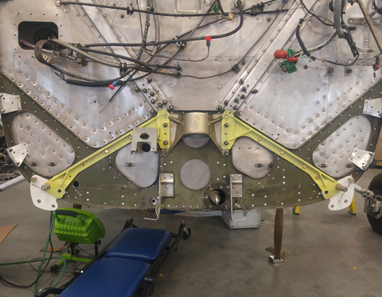

Mine is a set of doublers for the parts the drop light is shown resting on in the photo above, including matching the rivets through to the other side of the firewall, with a top plate as well added to the tunnel.
Never certified. The Denver FSDO said they wanted people to use the existing STC designs instead of looking at something that was new, easy to install without the yard sale required for the existing STC's, and effective.

There is a photo of the engine side stiffeners in this thread.
https://backcountrypilot.org/forum/182- ... 9?start=80
Page 5

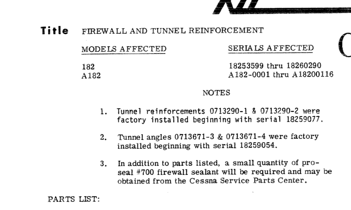

Re: 182 Tunnel stiffeners / firewall bracing
Well it looks like my 182A (#51212) doesnt fit for SK182-44c. Do you guys know anyone who has beefed up the firewall on a straight tail? Acorn sells a kit that I believe adds some more material on the inside of the firewall, but is there a service kit Im not seeing to reinforce the tunnel/ firewall on an early 182? Im not finding anything and Ive searched all corners of the web. Finally have the engine and mount off for the PPonk install but now at a roadblock. Any help would be greatly appreciated. Thanks!
Screen Shot 2021-08-09 at 1.38.17 PM.png (309.52 KiB) Viewed 2482 times
