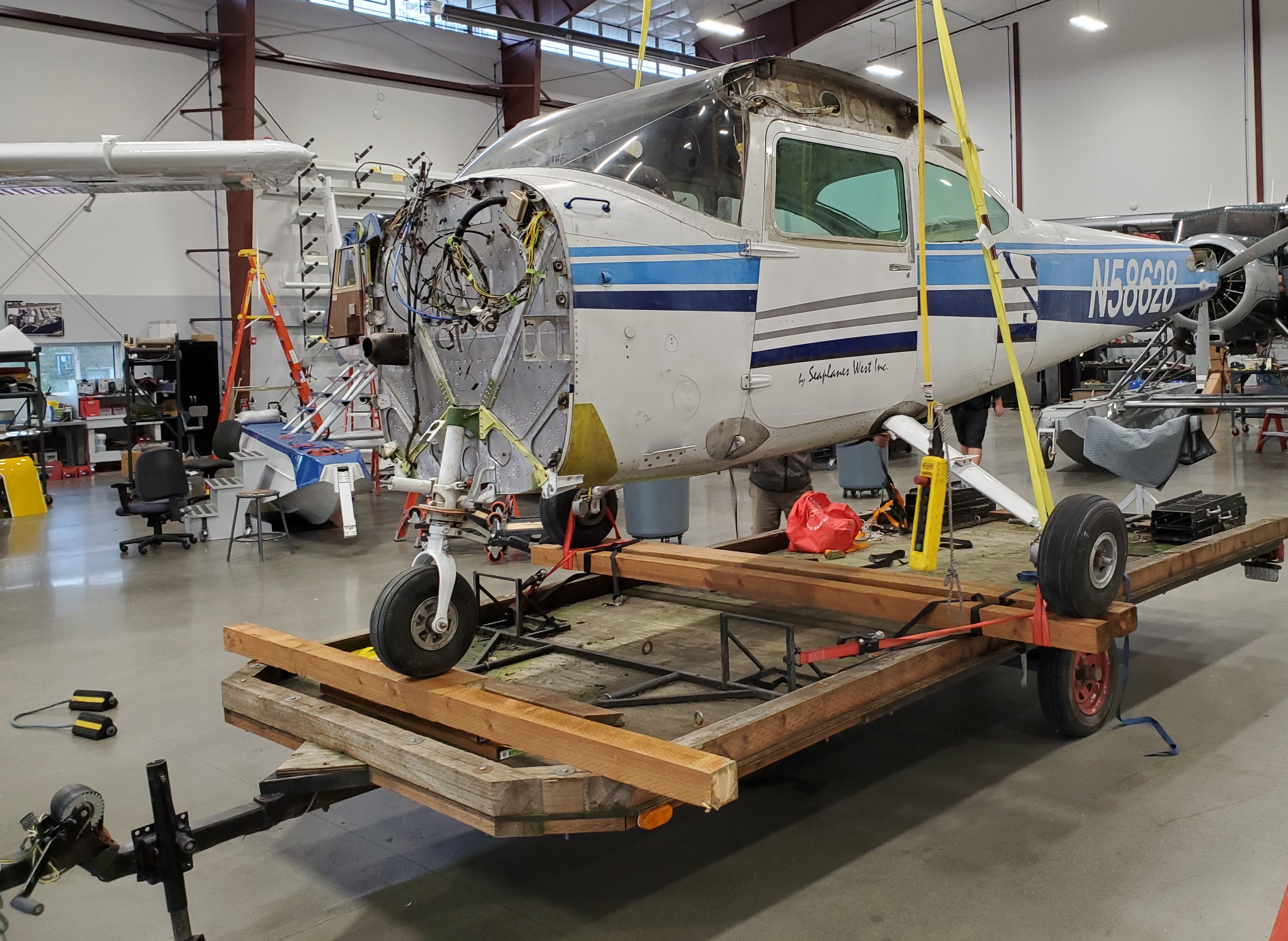

Takes a lot of Clecos to put your chin back on. Photos coming soon.

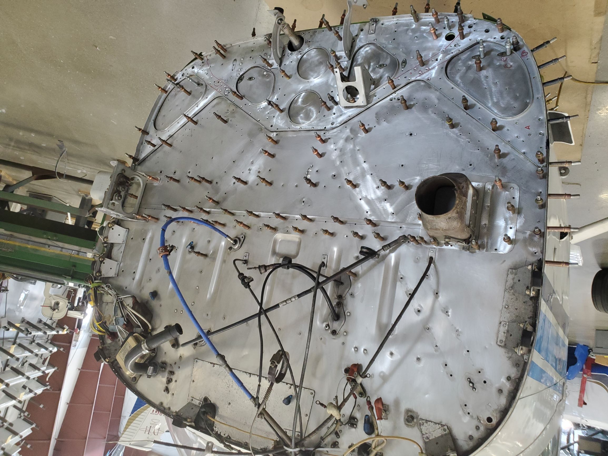

Why do these come in upside down?
Ready for rivets

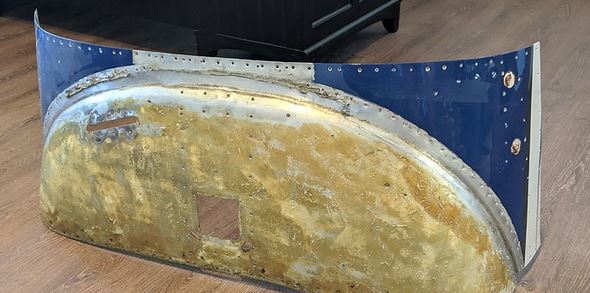

And any guesses on what a boot cowl is worth?
Boot cowl.JPG (45.16 KiB) Viewed 1543 times

PNW Flyer wrote:And any guesses on what a boot cowl is worth?
Way too much.
I was kicking around the idea of field approving a late model boot cowl onto my early model 185. Turned out too not only be a difficult approval, but almost cost prohibitive. Besides, I want to spend that kinda money on other cool things like exhaust and some new titanium landing gear.
If you're interested, I was able to get the best price from AirPower Inc ($5,400+).
One of those things that’s kind of worthless unless someone actually needs it, especially if it’s already full of some other airplane’s holes. That’s why aircraft salvage guys have so much real estate, need to have one or 2 of everything lying around in wait.

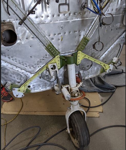

A little chin surgery to add the SPW float kit and we are ready for paint.
