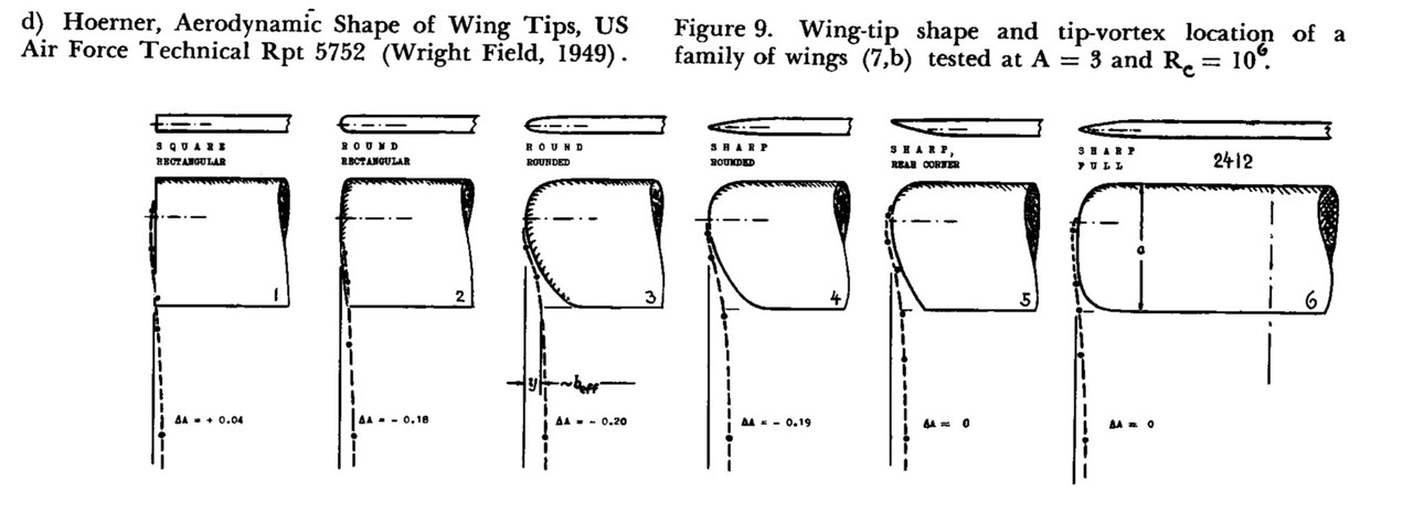

I was clicking around looking for something completely unrelated and stumbled on these, also started reading up on the German dude who started this tech
Is this a thing for post 1974 Cessna 185s, do our factory a185f tips already have the designed, and/or is this an upgrade?
https://www.knots2u.net/cessna-hoerner- ... two-metco/
“ This is the story of an accomplished wartime aerodynamicist from Germany, a former Douglas Aircraft aeronautical engineer and self-professed "Character" from California, an invisible corkscrew, and a revolutionary wingtip.
As an aerodynamicist for Germany's Fiesler Corporation, Dr. Sighard Hoerner, Ph.D., worked on the Fiesler Storch (Stork), a short takeoff and landing (STOL) reconnaissance and liaison aircraft.
During the Second World War, Hoerner worked as head of design aerodynamics for Junkers and later for Messerschmitt. After the war, he was invited to come to the United States to work on aerodynamic research at Wright Field, in Dayton, Ohio.
There, while working on new concepts for high performance for Navy fighters, Hoerner designed the wingtip that bears his name. He was one of the first aerodynamicists to acknowledge the existence of the wingtip vortex, the corkscrew-shaped wake that forms on a wing's outboard edge, and the Hoerner wing tip was specifically designed to minimize the effects of wingtip vortices on the lift, drag, stability, and control.
