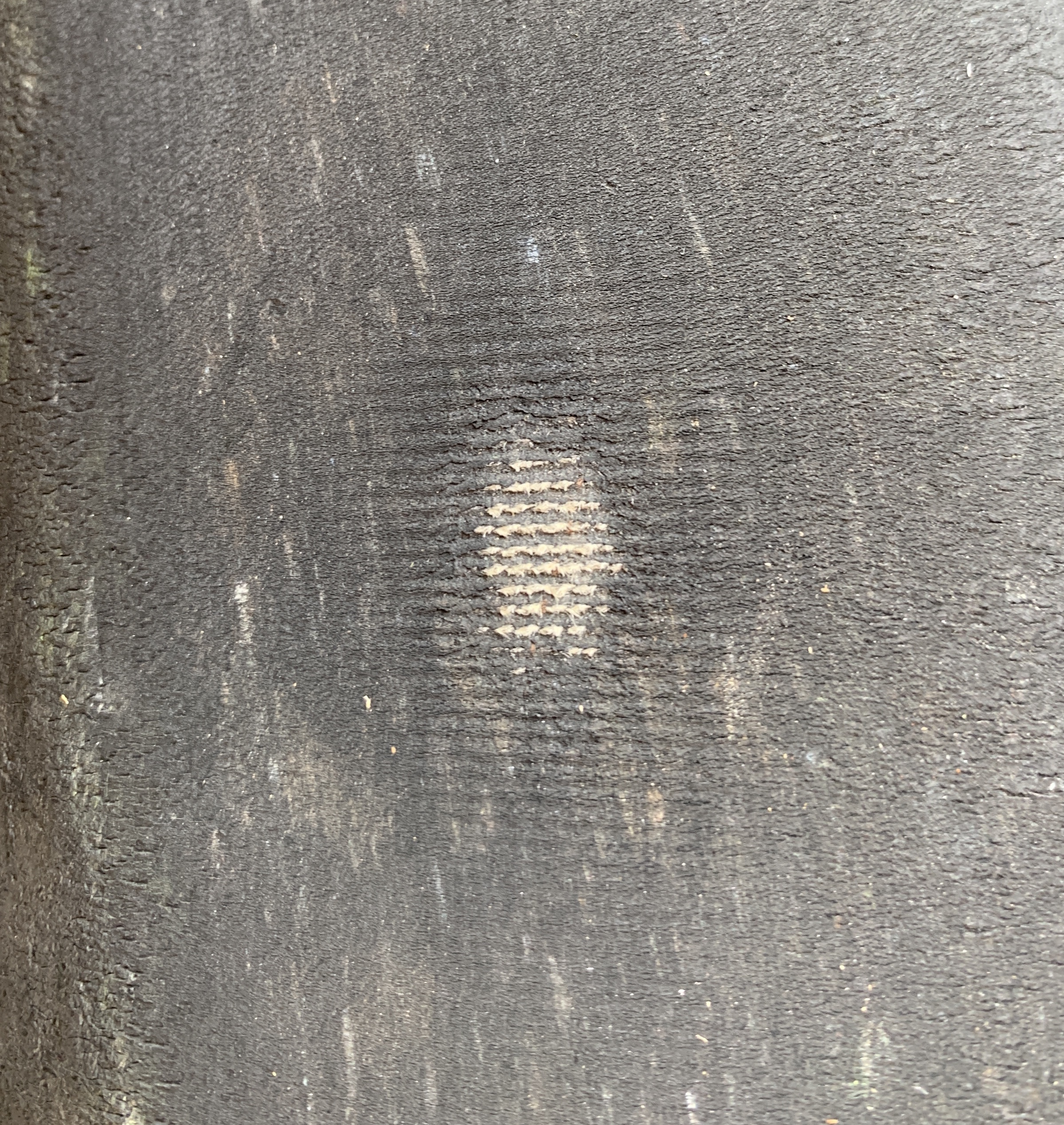

26" ABW, four years, 300 hours, based out of a paved airport, probably 60% of landings on pavement. Just found the first cord showing. Too bad ABW (or anyone else) can't recap. Hesitating on a new set with the heavy tread at $3300 for the pair when I've still got a pair of half-worn 8:50's that I could compromise down to.
If the cord hadn't showed I would have said they have plenty of thread left :wink:

So, are you certain that those tires are in fact Alaska Bush Wheel tires, or could they be Goodyear 26 inch blimp tires? Your initial post says “26” ABW” which refers to Alaska Bush Wheels, but lots of folks confuse the two.
Even the company (ABW) will tell you that their tires don’t wear as well on mostly pavement use.
As to gravel/dirt, that stuff can be tough on horizontal tails, but doesn’t do much harm to tires, even fairly sharp gravels.

I'd sure like to know how's he doing that. Wore out a pair of ABW 26's in 130 hours ($23/hr! #-o ). Granted almost all pavement, and a lot of driving up and down the runway at high speed with the tail up and on one wheel or the other trying to get the rudder figured out. Yeah yeah smart I know. Anyway my answer is two sets of wheels, ABW 26's for summer dirt and 8.5's for winter on pavement.
