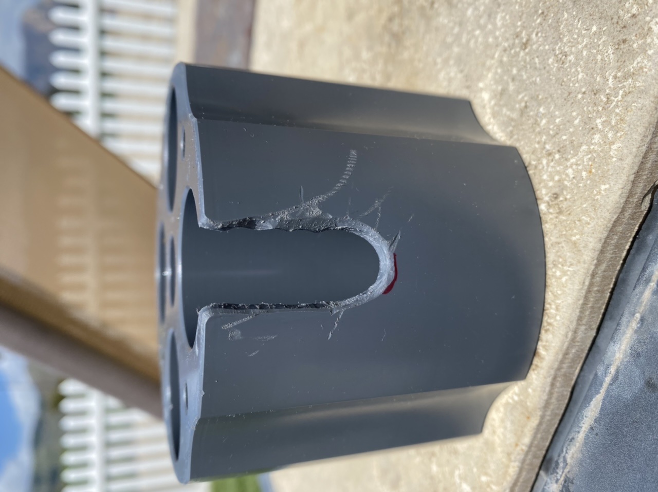

I just ordered the parts for this tailwheel upgrade. Would you mind posting some more pics of the process and tube? Thanks!
Posts: 1533
Re: 26 Inch tires on pavement

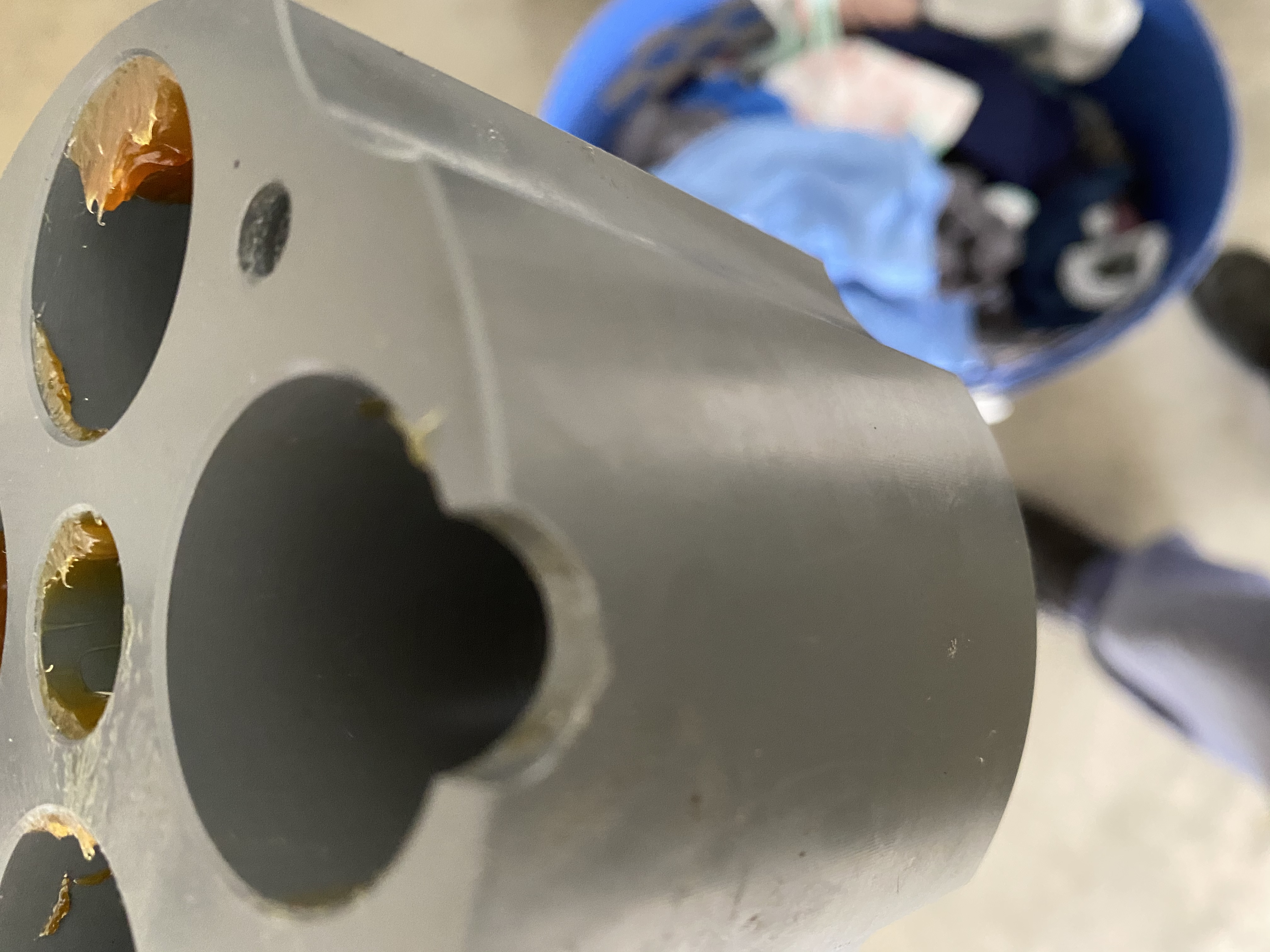

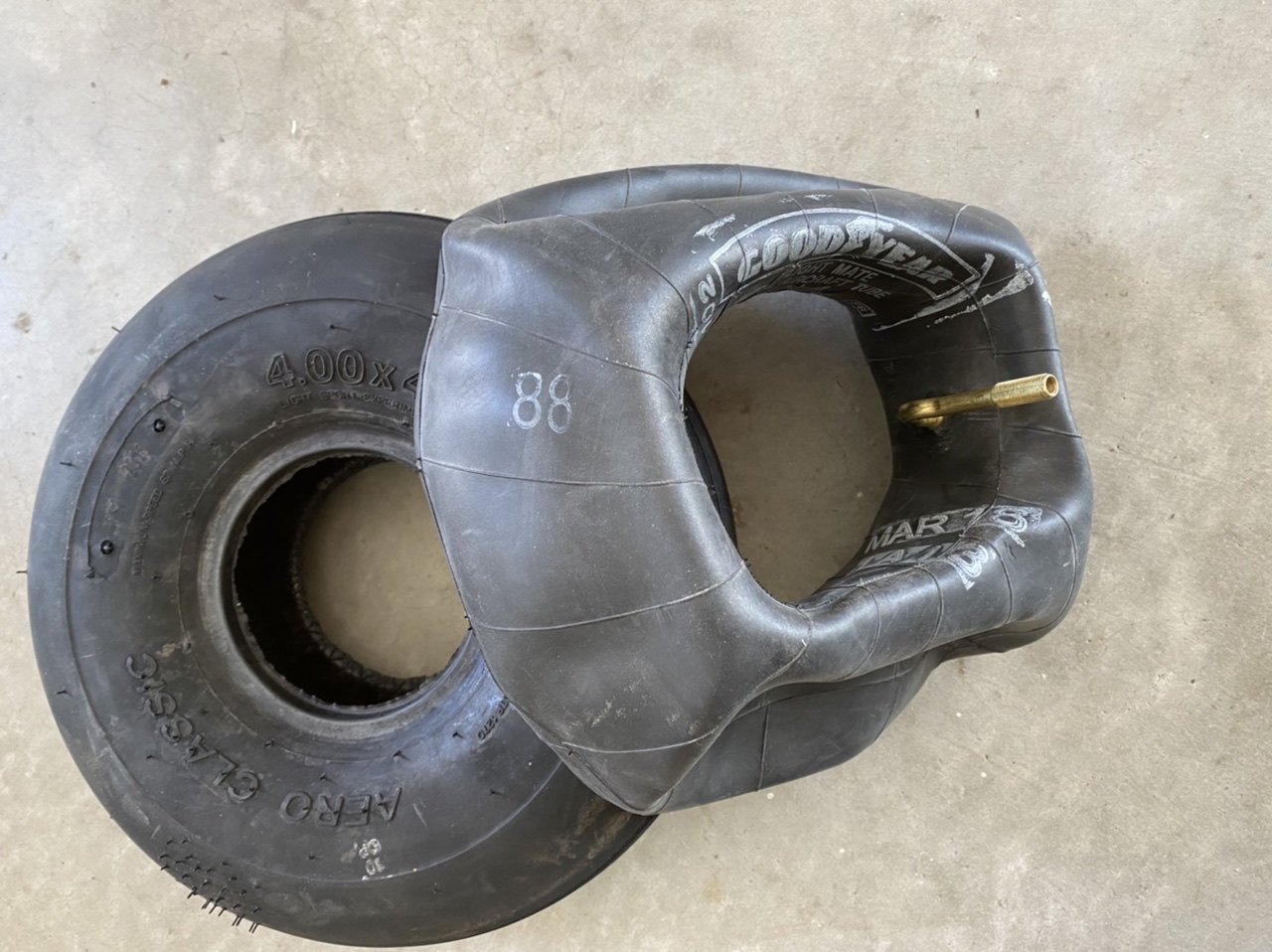

First pic is the spacer that goes between your stock Scott tail wheel halves. You can see the notch for the valve stem. This notch works for the stock aero classic 4.00x4 tube but that tube is cheap ,thin and won’t hold up
So you need to order the 5.00x5 beaver tube
Goodyear part number 302-005-400
Next you have to notch the plastic spacer more because the Beaver stem is longer
I’m about to start putting it back together so I can post up more pics as I go

404 tire with Beaver tube. Note the stem
sierrasplitter offline

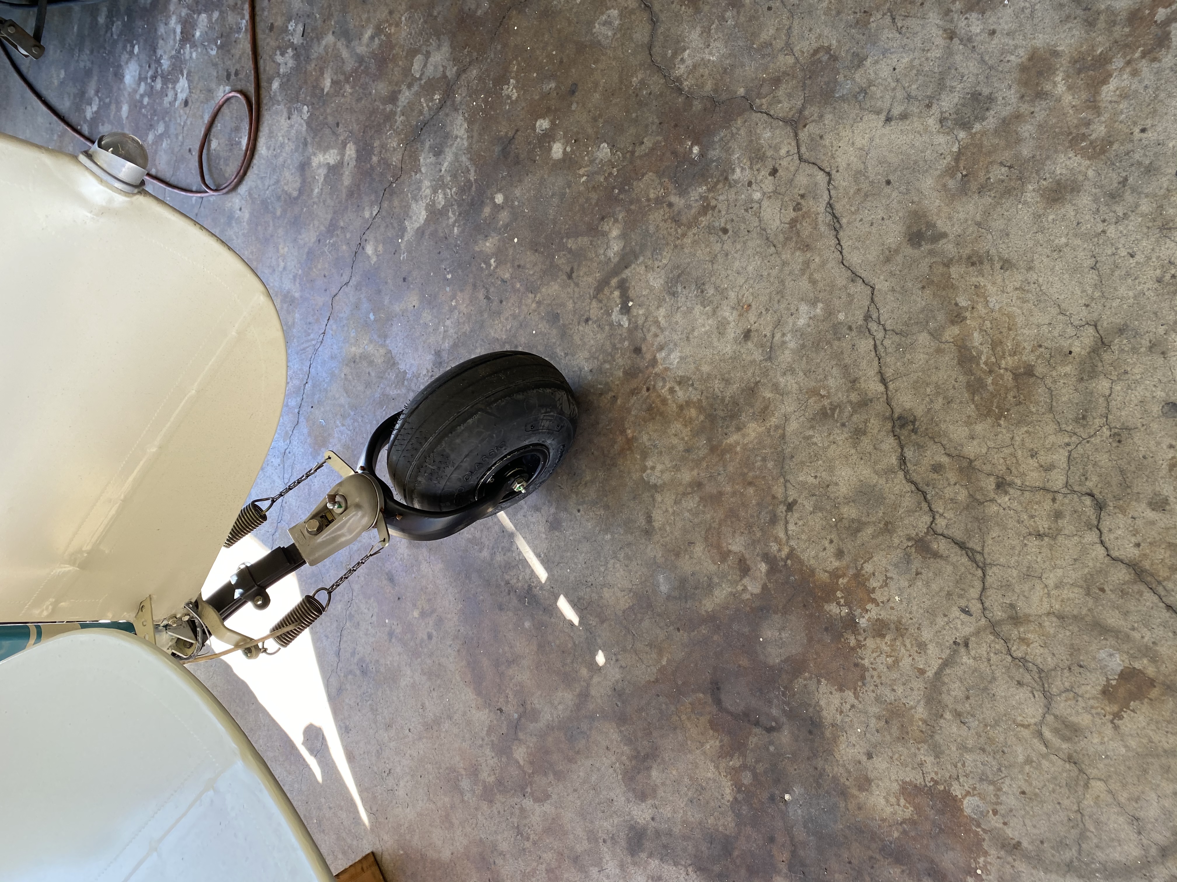

This is what it looks like on the plane
Posts: 203
Location: Lakeside
Aircraft: 56 PA 22/20

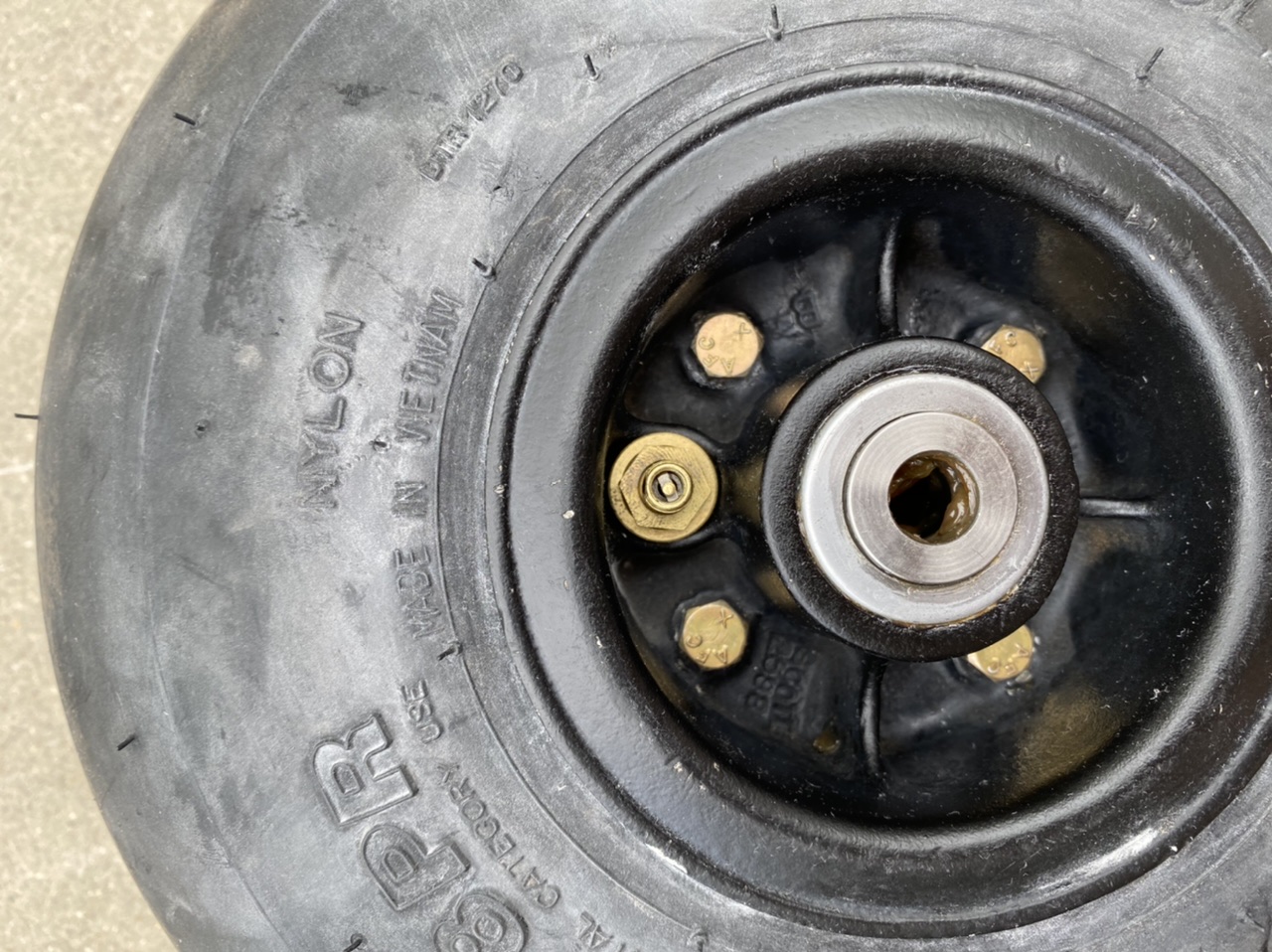

Tube is inflated and holding at 50 psi. I will install later tonight
I did end up using the brass washer and one brass nut on the stem to hold it in the correct spot
