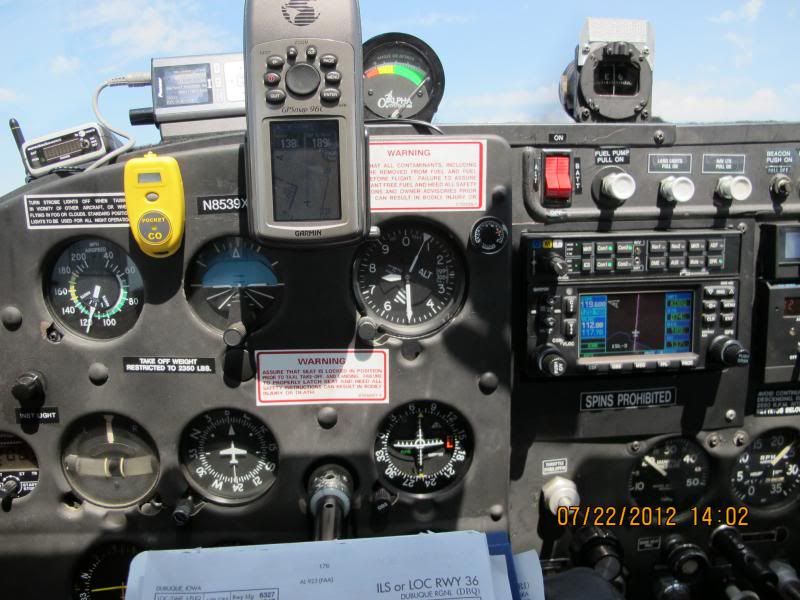

I have an Alpha Systems analog/mechanical AOA in my airplane. After flying with it for several years now and about 250 hours or so, I'm sold on it--it was not a waste of money, at all. Here's an older pic of my panel (I have recently replaced the Airpath with a SIRS compass) showing the AOA, centered in the pilot's line of vision:
At different weights, if I just keep the needle in the middle of the yellow, I'll be at a safe approach speed. The airplane stalls as the needle approaches the bottom of the red, so whenever I get into the red, that's a bit too slow for short final. Since I typically fly with just me and my dog, my approach and landing speeds are typically slower than they were before I installed the AOA. Fully loaded, my approach speeds are just about at book speeds with the needle centered in the yellow.
Calibrating this version is trial and error, adjusting the vane on the wing on the ground, then testing it. It took several flights to do that. The electronic versions use an "in the cockpit" adjustment. It's calibrated so that when the needle is at the red/yellow mark, the airplane is being flown as slow as possible in level flight with full control of all controls. Although there is some difference with flaps extended or retracted, there isn't much.
With the gauge located where it is, it's easy to see during a short approach without taking my eyes off the runway environment. The only downside of it is that it isn't lit, so at night I can't see it--then I have to rely on my airspeed indicator.
I should mention, before someone says that any experienced pilot knows what his airplane is doing without such gimcracks to help him, I'm no newbie. After almost 41 years of flying, instructing, SE charter, etc., I can feel what a 172 or 182 is doing as well as anyone--but using the AOA, now I can do it better.
