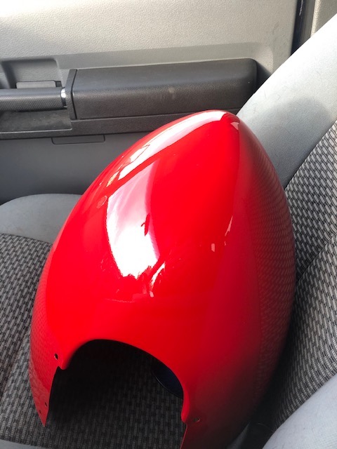

How bad is the crack? During my first annual my mechanic did not like the patches / repair on my spinner and wanted me to source a new one. Instead I sent it to https://www.spinner-repairs.com and for $500 they fixed it and sent it back. A little filler and paint and the spinner looks new. I would give them a call and save some money. They are an approved FAA repair shop and includes all appropriate paperwork.
post repair...like new
