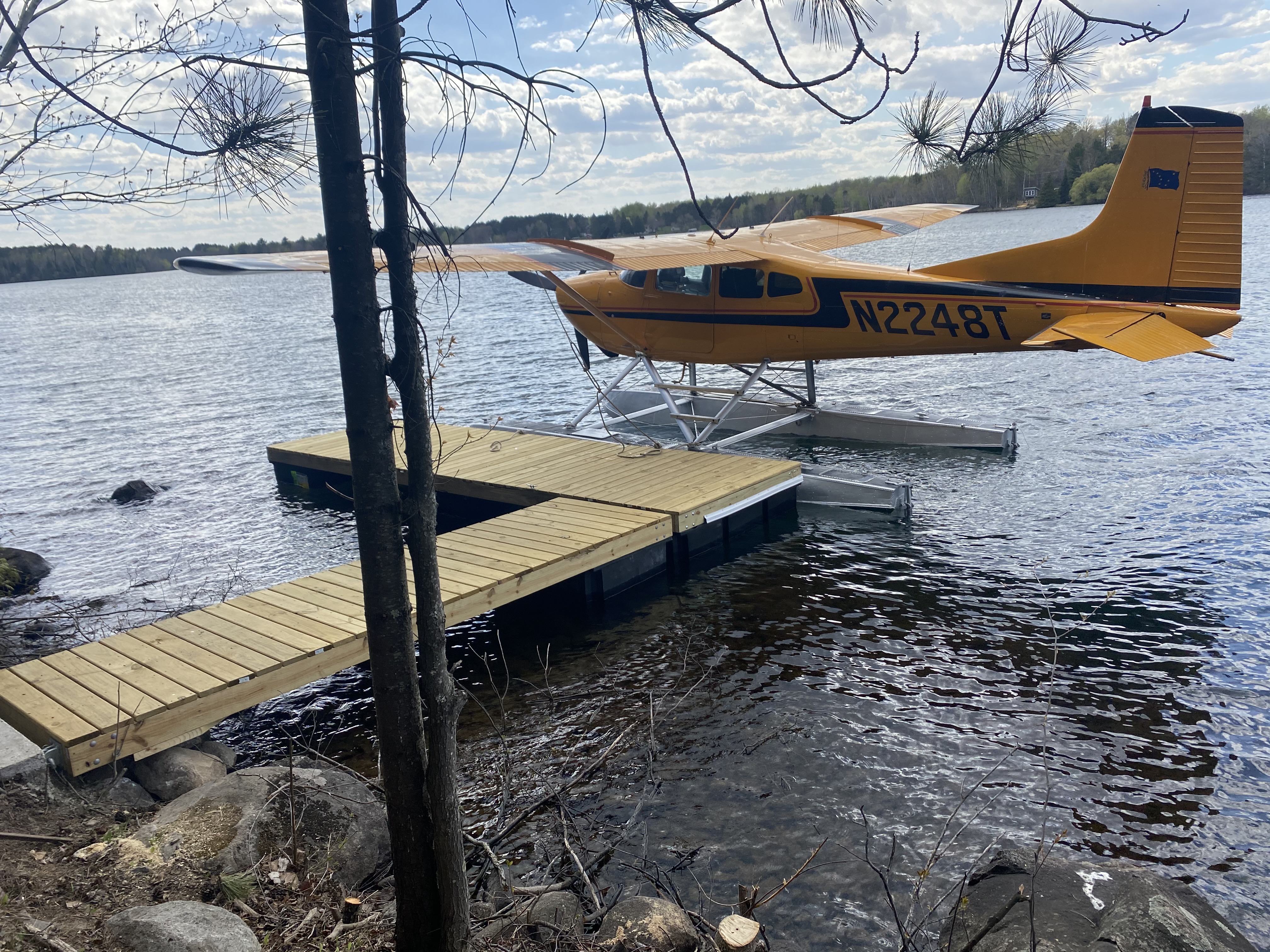

Here's a view of the existing dock. I wish I had measured it, it seems too short for the airplane currently. Otherwise its in a great spot on the island, sheltered bay just south of the boat house. You can get in from the north or the south.
One more dock picture.
What is the ideal dock shape? What are comfortable dimensions for a 185?

Brad, I personally like the dock configuration that you already have, if it is wide enough for your plane and deep enough water, you have a great base to work from. Once you get the plane in between those two docks it is not going anywhere, plus it allows getting in and out of the plane from either side. Like you said, it is hard to tell from the picture how long the existing dock is, if it needs to be a little longer you could add a floating dock to each of the two existing docks, or put in a rock crib and just extend some more dock out. You will probably want to attach some sort of bumpers to the docks to protect your floats.

What you have looks pretty good. That said, I can’t tell if there’s a hinged ramp mounted between the docks for the plane to slide up on. If not, I would absolutely add one. Weight the outboard end (attach weight under the outboard end) so it sinks a bit. Then, when you arrive, you can drive the plane in either with idle power or just some remaining inertia and “stick” the floats on the ramp.
With that kind of setup, when you’re ready to leave, slide the plane off the ramp aft, with line attached of course, spin it around and heel the floats up on the ramp. Now, load the plane, untie, climb aboard and fire up. Power off. So, no dancing with the plane coming or going.
My kinda dock. As to length of the two piers, adjust based on the above description…..can you load/unload with the plane on the ramp, toed up and heeled up?
If not, extend the piers to make that functional.

mtv wrote:What you have looks pretty good. That said, I can’t tell if there’s a hinged ramp mounted between the docks for the plane to slide up on. If not, I would absolutely add one. Weight the outboard end (attach weight under the outboard end) so it sinks a bit. Then, when you arrive, you can drive the plane in either with idle power or just some remaining inertia and “stick” the floats on the ramp.
And now, I am officially jealous!
I should have added that the front of the ramp that's in the water should be hinged to the dock, so the ramp can pivot up and down outboard, but fixed inboard.

Only thing
I’d make the center a ramp, or even a lift
Use the outer sides for short term mooring
I’d also add mounted bumpers all the way around, ether tires or if you want something pretty they make lots of screw on fenders for docks
Also might want to make sure the top doesn’t let too slick, I’ve had to pull off some ninja moves hopping off a float only to eat shit on wet wooden docks lol

One alternative to running fenders or tires all the way around is to nail vinyl-d-rubber on 4 2x4s and sink them vertically into the bottom, nailed at the deck-level on your dock. The float chine will rest on the vinyl below the water level, preventing the float skin from hitting the tire or dock edge.https://backcountrypilot.org/me/my-phot ... toid=61293

Awesome spot & if you haven't figured out the dock size I bet you could count the boards & then multiply by 5.5 to get a pretty good idea of the length in inches as the boards look like 2x6's. You are living the dream :)

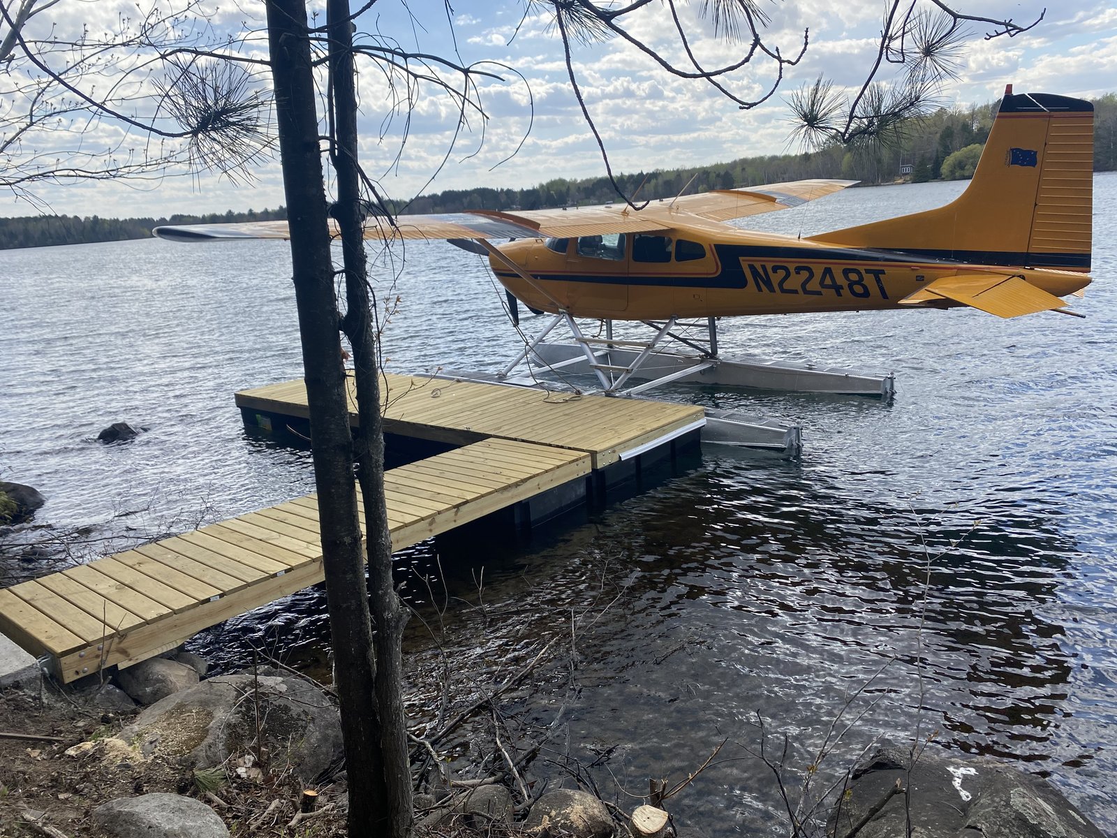

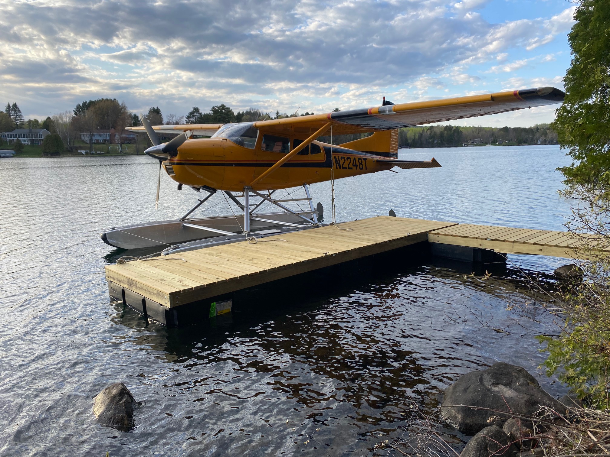

Thread resurection- with a pic of what we built. Still looking for advice-
Hi All-
So we had a great season up north. The dock configuration of course changed from the last plan. We decided we wanted the plane near the boathouse. Its were the gas is, tools, electric etc. We had an L shaped dock built to shelter the float plane. The system I eneded up using for securing the plane is a combo of static lines and bungees. You can see in the photo the plan is secure but able to rotate 10 degrees or so in big weather which I think keeps the strain on the dock slightly less?
We are planning to add 2 more dock sections to make the inside of the L bigger, the boathouse is a bit too close for comfort when rotating the plane inside the L.
My question is- any other configurations I should think about? The floating docks can be re-arranged however I want. I will have a gas line coming out of the boat house wall next year.
The plane is facing West, which has the biggest opening for weather. Prevailing wind is southwest, but big north blows are possible, there are natural breaks for wind and waves all directions except straight west.

Re: Buying an Island- Need Seaplane Dock Advice
Durango Skywagon wrote:Thread resurection- with a pic of what we built. Still looking for advice-
Hi All-
I wish people would stop posting photos of skywagons with the skylights, every time I see one I go back to should I do that or not lol
Dock looks nice, just curious why you went with a C shape vs the more standard U?
The L dock is pretty good for the float plane and really good for other stuff as well. Its nice to have the outside of the L for starting and finishing a trip, and the inside for parking, boats park on the outside of the L when visiting.
I am open to other configurations- this seemed to check alot of boxes.
The downside is getting the float plane into parking or out for a trip when I am solo on the island, it takes some rope work.
