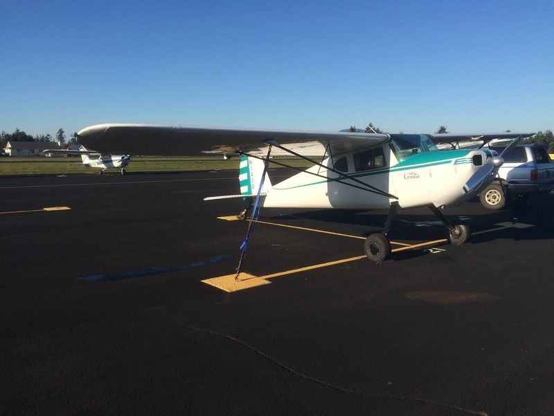

Thanks for all the comments. I ended up with the 140. It does indeed kick butt - climbs at 1500 fpm near sea level. Impressive performance for a 140. Still working out take-off and landing numbers - need more practice to get them nice and low. It is a bit nose heavy which makes landing slow a little tricky as it runs out of elevator early in the flare when slow. It would definitely benefit from a higher angle of attack on the ground. Tail hits first with a slow landing, and it won't pop off the ground until well above stall speed because the angle just isn't there. But I think larger tires and practice will fix this. Upgrades in the future will be Desser 8.50s, VGs, and a flatter prop.

SamIntel wrote:.... It is a bit nose heavy which makes landing slow a little tricky as it runs out of elevator early in the flare when slow. It would definitely benefit from a higher angle of attack on the ground. Tail hits first with a slow landing, and it won't pop off the ground until well above stall speed because the angle just isn't there. But I think larger tires and practice will fix this. Upgrades in the future will be Desser 8.50s, VGs, and a flatter prop.....
I put a set of Micro VG's on my C150TD and was under-impressed, but some others have out them on Cessnas & really liked them. The 150 VG kit put them on the vertical stab but not the horizontal stab, I see the kit for the 120/140 has VG's for the bottom of the horizontal stab but not for the vertical. Hmm. Under the horizontal should increase your elevator effectiveness if they live up to their claims. One good thing about the 120/140 & 150 kits, they're only $700 vs $1450 for the 4-place Cessnas. Kinda handy for you that Micro is right on the field there at Anacortes.
Looks like you don't have the wheel extenders on that 46 model. They're not the greatest, but if you wanna move the wheels forward they're a lot cheaper than a set of later-model wheels-forward gear. Since it mounts in back, I'd suggest that you keep the stock heavy battery, but you might think about a lightweight starter and alternator (if you don't already have them) to get that CG moved aft a bit. I see you have single-puck brakes, better than doubles for not putting you on your back.
