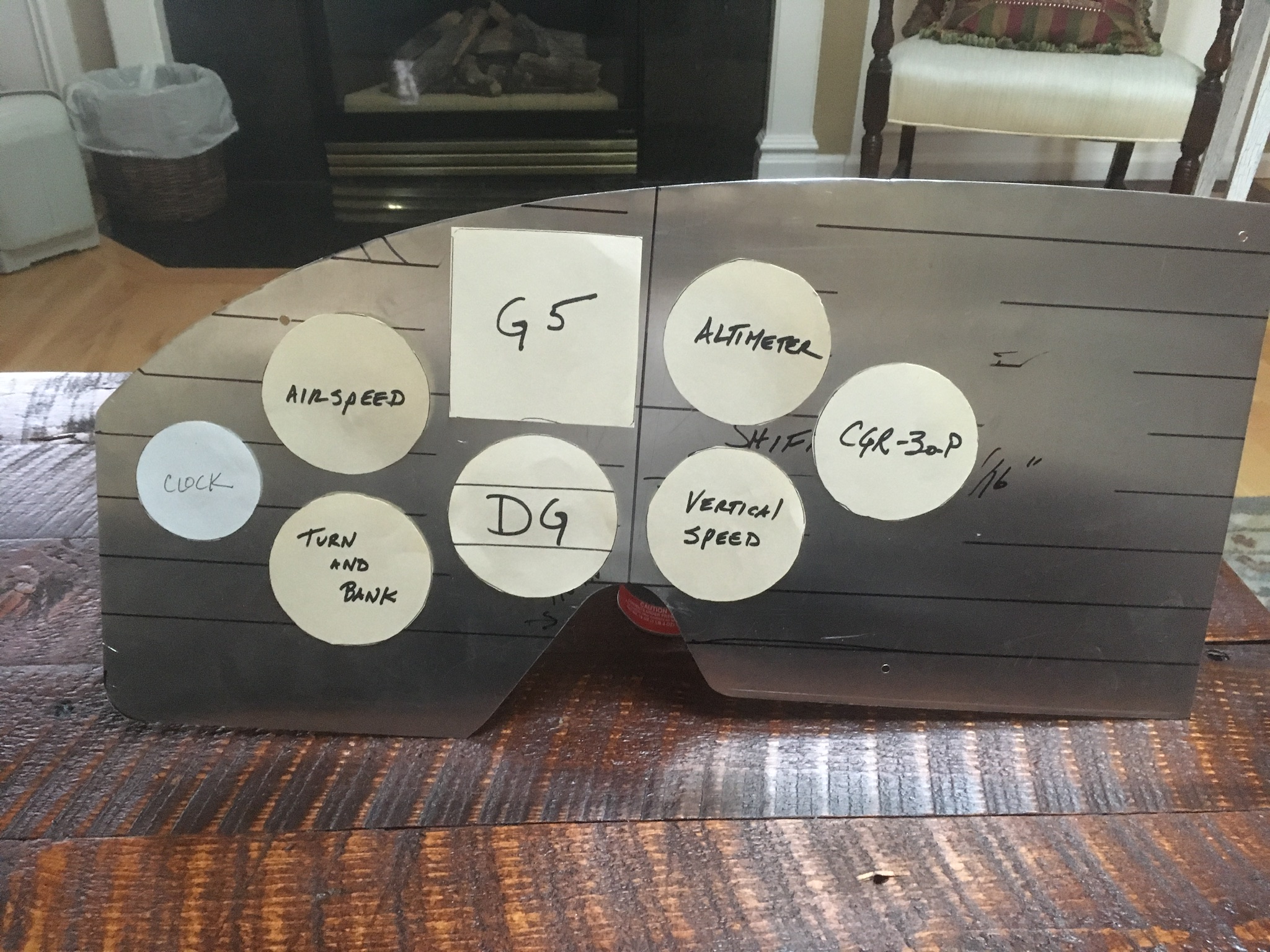

Most of you probably know this but I found out that I can use the fuel gauge portion of a CGR-30-P with my old resistive fuel senders. That seals the deal for me. EI did say that if they are a primary gauge replacement they have to be displayed on the main page. Also, they just started one of their rebate programs yesterday.
The panel looks crazy simple now. Still struggling with getting around the brace that runs from above the pilot control rod back to the firewall. It’s very inconveniently located if one wants a DG below their attitude indicator. Any creative solutions out there other than just off-setting those 2 instruments right or left? I notice many people put shorter instruments below the AI. Here’s a mock-up of what I’m considering. I’d actually like to move the CGR to the right side of the main cluster so the co-pilot can help out with monitoring things. On the metal mock-up I cut the right section of the panel off so i can see behind for spacing when I shove an instrument in the hole. This is just .032 that I can cut with snips and try multiple arrangements.

Engine instruments on the right is much better IMO.
It’s not as important as you’d think to have a perfectly symmetrical 6 pack layout.

Larry at Saircorp was able to center the 'six pack' with respect to the yoke for the new panel on my '57. He has a CAD model of the structure behind the panel, not just the panel itself, which greatly helps with instrument placement/mechanical interference avoidance.

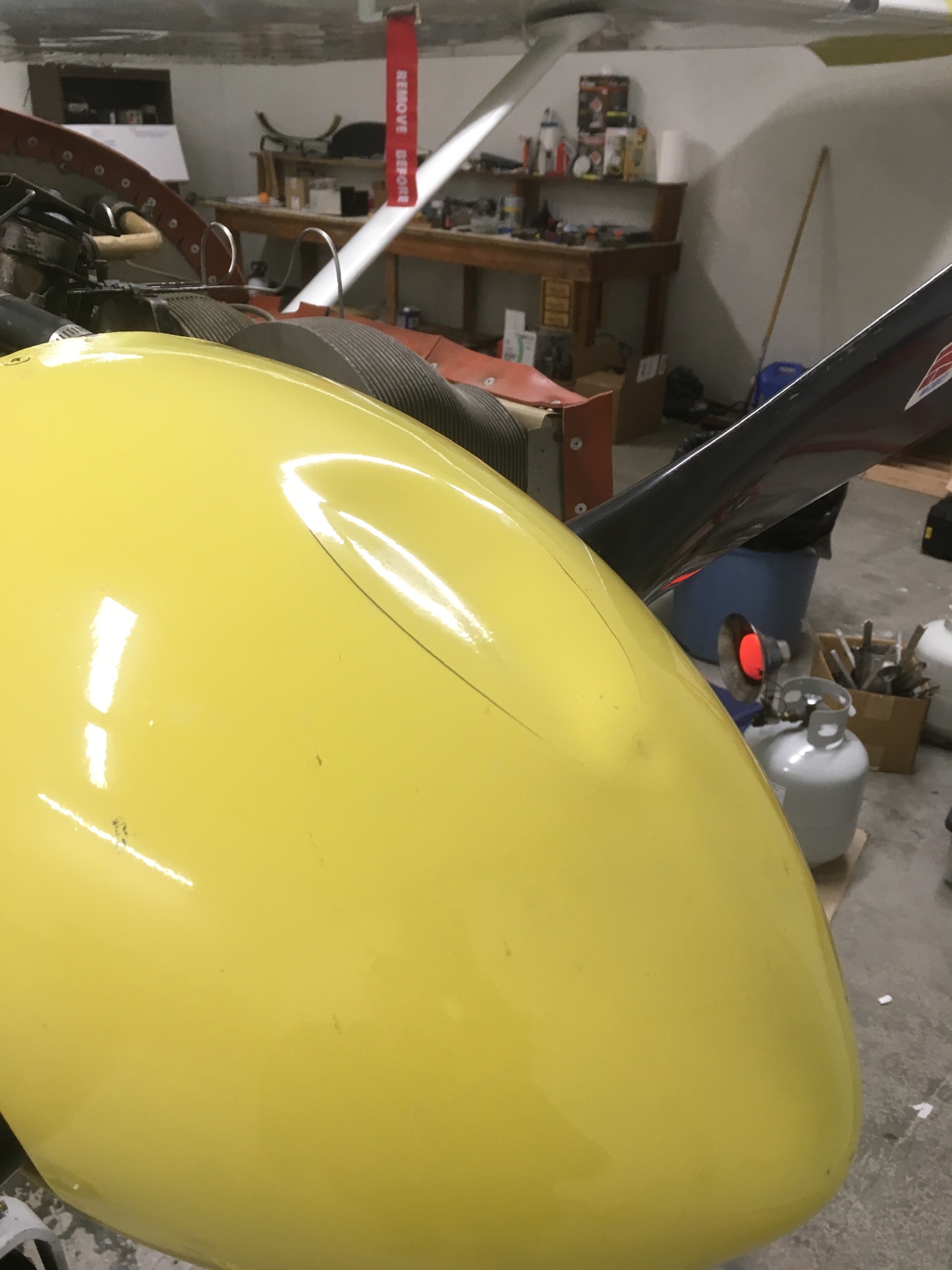

It looks like I will need a spinner repair (Is that possible?) or replacement on my ‘58 182. While replacing my motor mount bushings at the firewall I accidentally hoisted the spinner into the hoist arm. Crap.
Attached is the pic of the damage. Is repair possible or is replacement inevitable? I think the backing plate should be find. It was a pretty gentle “squash”. The dent looks pretty deep but it’s probably about 1/4”.

Looks like the spinner should be repairable. To bad that you went with the rubber firewall mounts, the newer aluminium ones are much better.

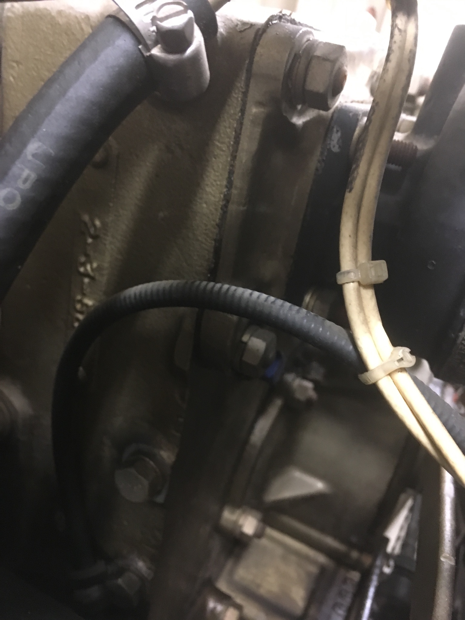

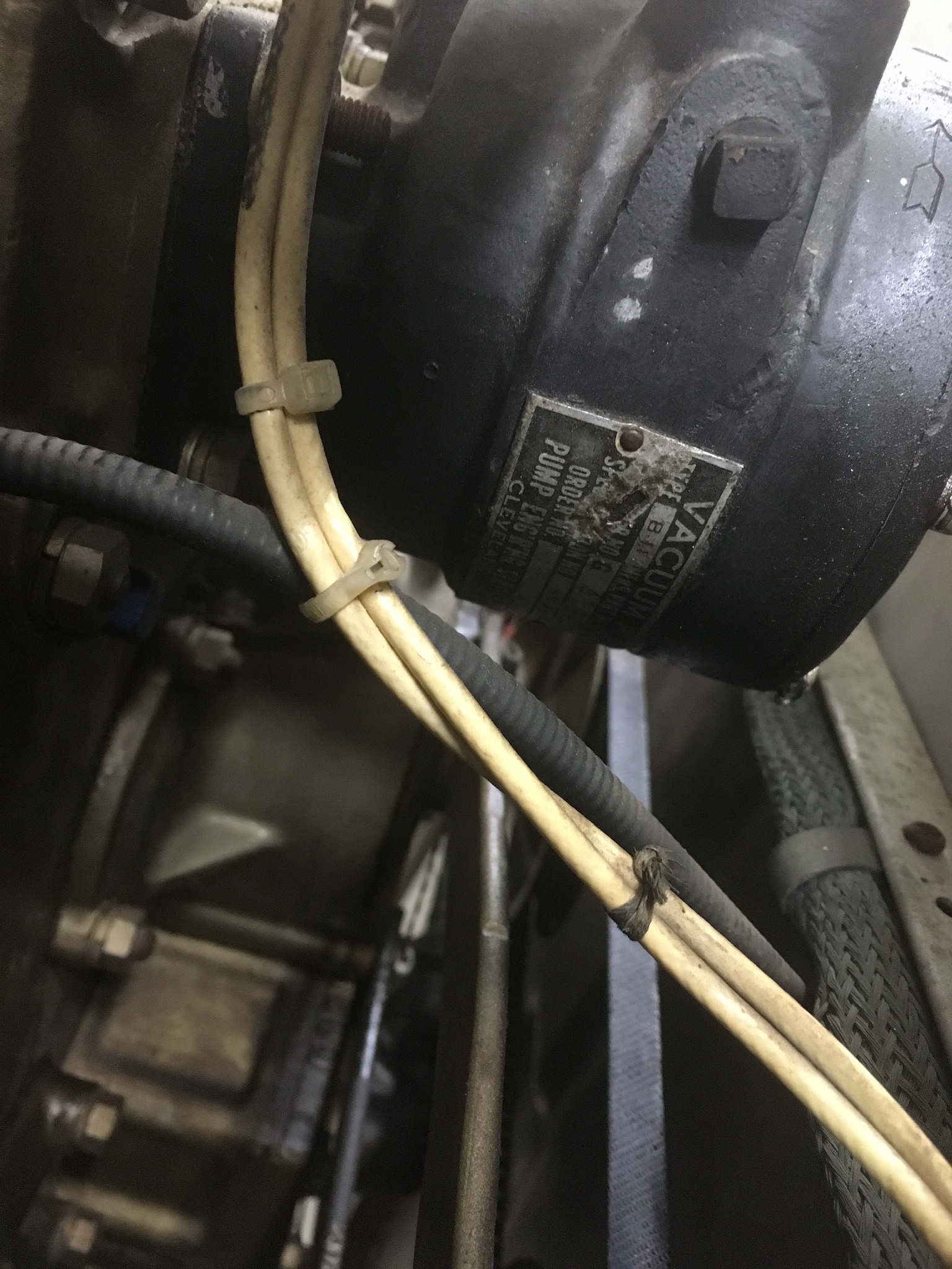

Ebag...so I found a couple pics of where my old throttle cable came through the firewall and down to the carb. My memory was incorrect in that I thought it turned up and went up alongside the vacuum pump and then made a loop back down. Not correct. It just exited the firewall and went over the tensioning arm of the gen and through a clamp on the side of the case. Since there’s no loop over/near the vacuum pump the cable I have from McFarlane (42”) may be long enough. This look familiar to you?

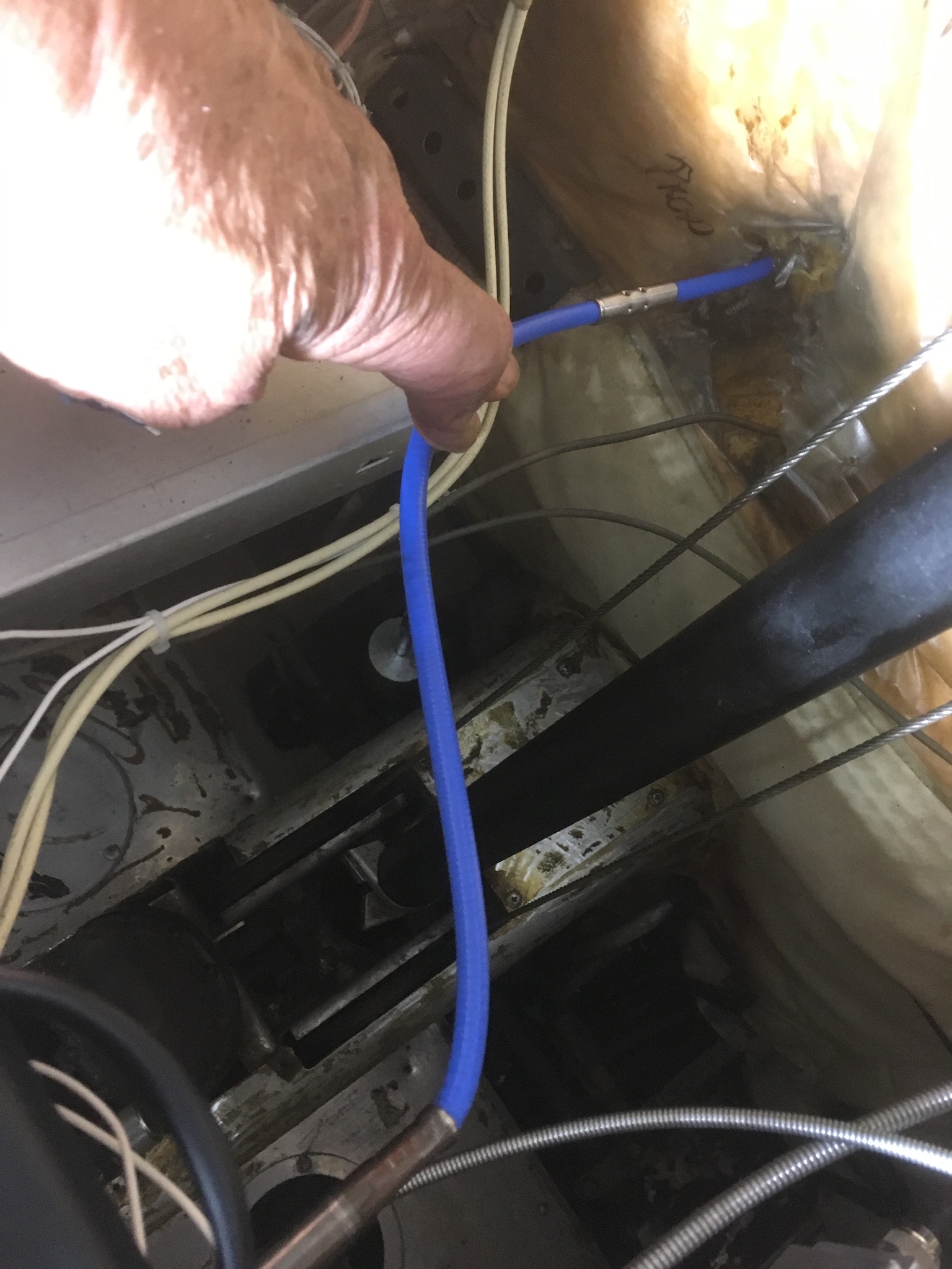

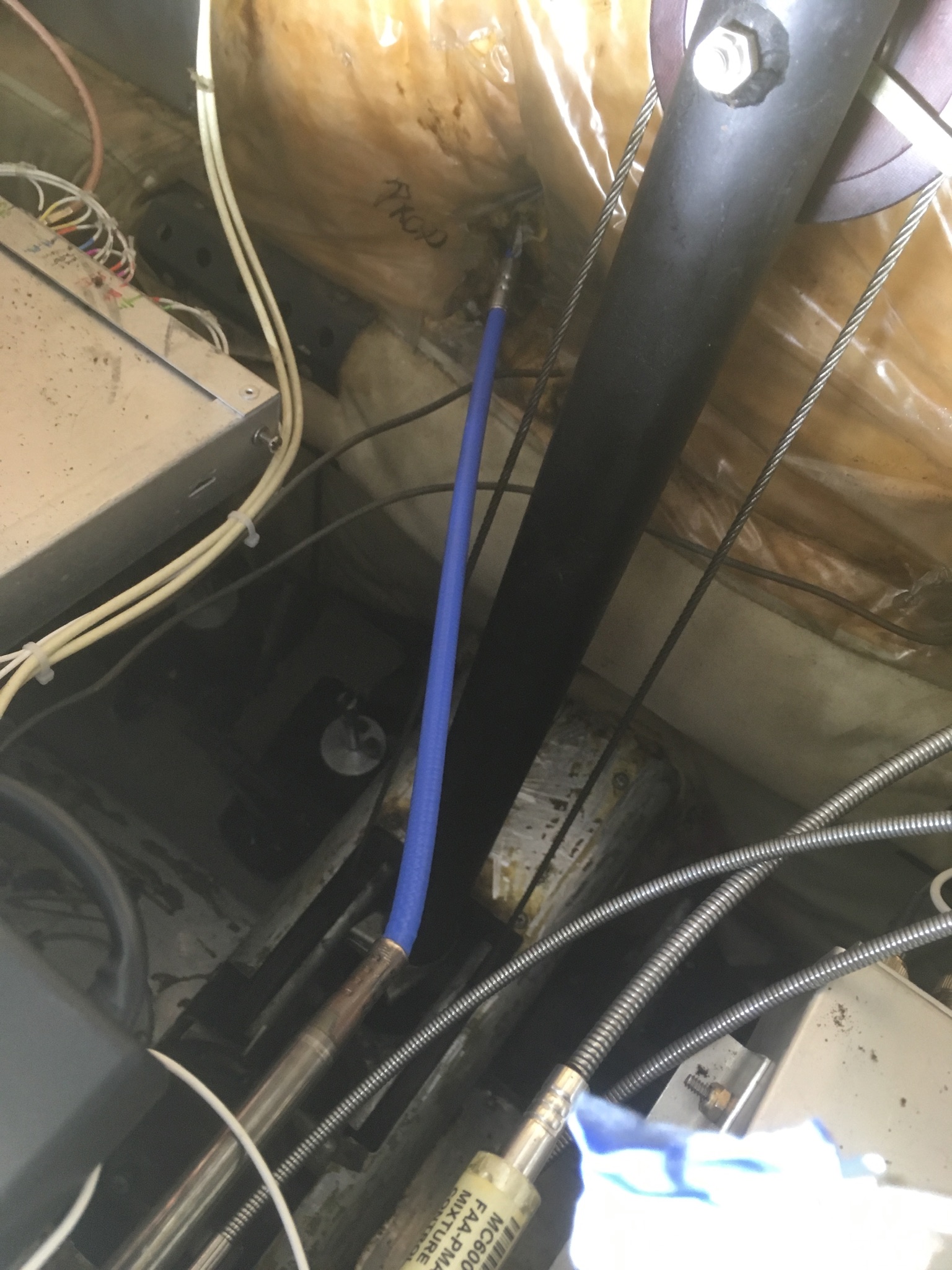

Also, in trying to route my prop control cable from the stock position in the panel, it conflicts with the T-bar coming back, unless I make what feels like too radical a left turn withi it and then back toward the firewall. Almost 2 90 deg turns. It just doesn't seem right. Does the routing of this blue sheathed prop cable look familiar to anyone? Bigrenna....I’m thinking you ought to know. Is it even possible that the prop control cable should be routed around the back side of the yoke? When I put the 2 bends in the prop cable like the pic shows it comes out to the correct length at the governor.
