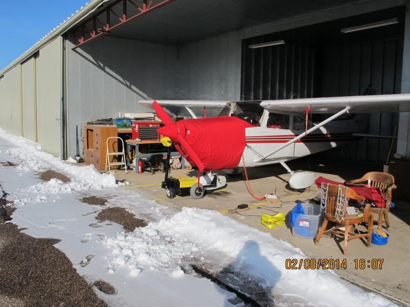

There isn't any doubt that it's useful to be able to preheat remotely. I don't need to leave my Reiff system on for more than about 4 hours in near zero temps in the hangar with the cowl cover on, though. The hangar is as cold as a witch's you-know-what, as it's uninsulated and unheated, but it stops the wind. The cowl cover is by Kennon, and it's thick. It makes a huge difference in both how fast the engine heats up and in how warm it gets. I also have prop and spinner covers, and I think that makes a difference, too. The prop actually gets warm all the way to the tips. I haven't measured the oil temp, because my standard Cessna oil temp gauge has only minimal markings, but it's off the peg, and the engine starts like a Spring day.

Cary, looks like you had the preheater working on the hangar roller doors, too :wink:

cubscout wrote:Cary, looks like you had the preheater working on the hangar roller doors, too :wink:
Thanks. cubscout
I wish! I had to yank them open with a tow strap and my car. Hate those doors in the winter!
