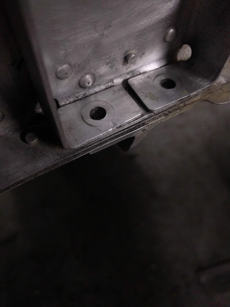

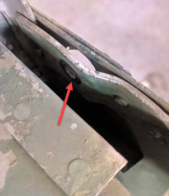

I got almost all the way through the inspection unscathed. Just as I got the last spec of paint and grime off the aft attach fittings a little crack showed up coming out of the bolt hole. Just ordered replacements from Yingling. At least these parts are reasonably priced at $85ea
Also, I do have some wear on the aft attach fittings. The spacers are rubbing up against the fittings and fuselage back there. We blended it out for now and seemed like a good place for a crack to start. I don't have a picture but will add it to the post when I get back to the hangar. I'm not sure what ordering new parts would do given that the parts in there look like they are in good shape. Seems like there should be a washer in the assembly but there isn't one in the IPC.
(scroll down for the crack)

Re: Cessna 180 Jackscrew & SEL-55-01
This picture shows the gouges caused by the spacer rubbing before they were cleaned up:
