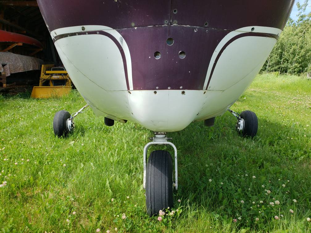

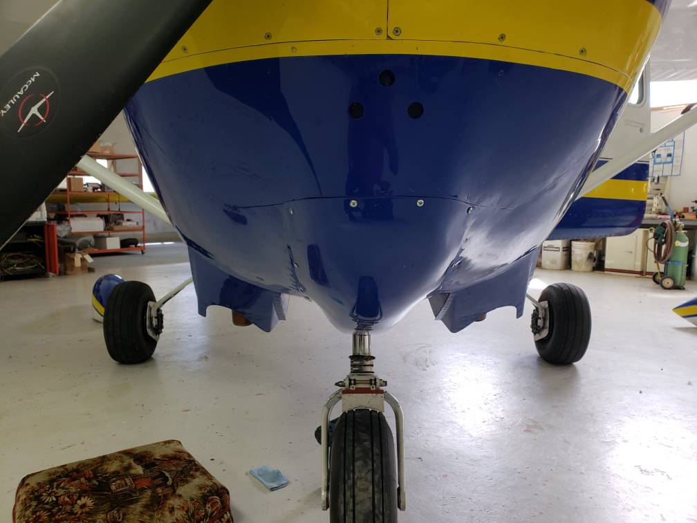

I think hes talking about the chin bump in the center. Same as the early 206s have. We've put the knots2u ones on a couple early 206s and it looks a lot better. Easy install, just remove the old one and match drill the new one.

Interesting. The curvature begins before the actual split panel (gear doors) and continues farther up, so I figured he was wanting to get rid of it all. Do you have any pics? That would be interesting to see. And it would interesting to hear what they think the difference was.

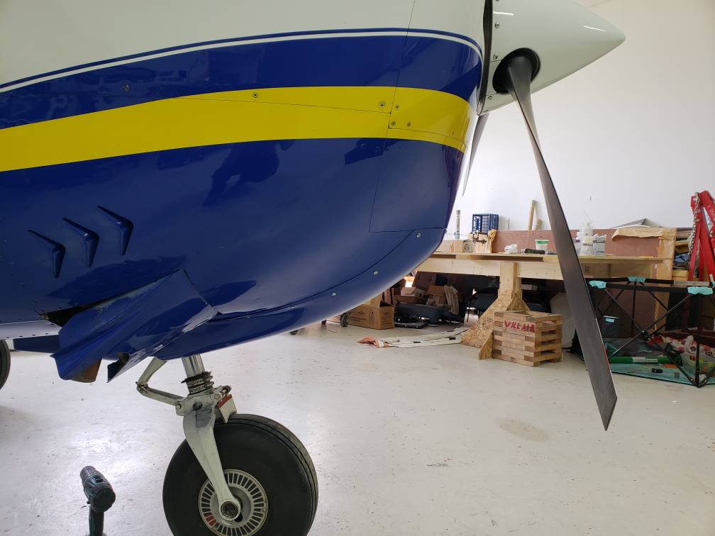

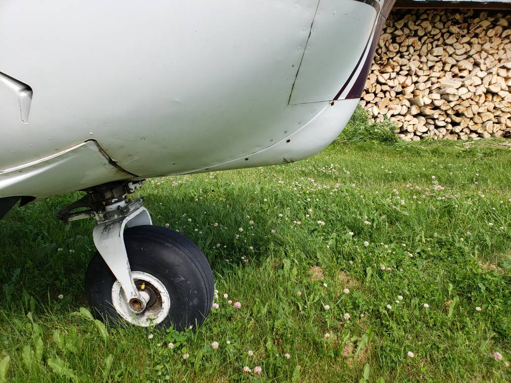

Here's a picture. The purple one picture is my old P206 and the blue is of another 206 with the knots2u fairing. The fairing also fits around the nose strut tighter and hides the shimmy dampener, but I didn't get a picture of that. Just the reduced bulge. It definitely looks better IMHO, and I'm sure it would help cruise speed a bit.

Interesting. Thanks for posting the pics.

It is interesting. I'll ask th owner is h noticed a speed difference. Personally, I can't see it being worth it. I'd rather put the money towards Quasar tips.
