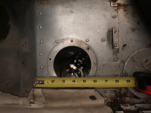

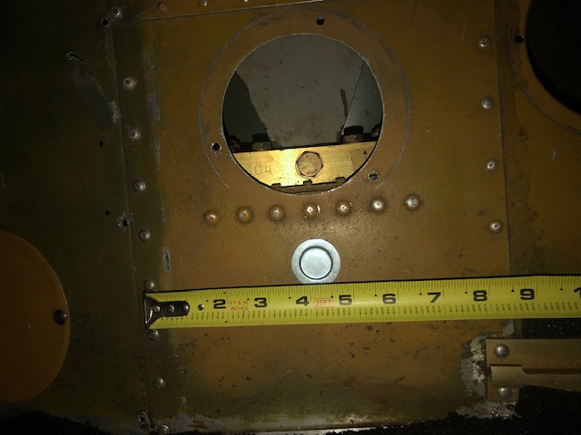

Re: Floats on a '56 model 172?!?
To learn, one must listen.....
Verify, THEN speak.....
No gear boxes forward on '56 172. Partially similar bulkhead rib structure to my ‘55 170.
Maybe that was the conversation. It was a year ago.
Thanks for sharing some wisdom.
