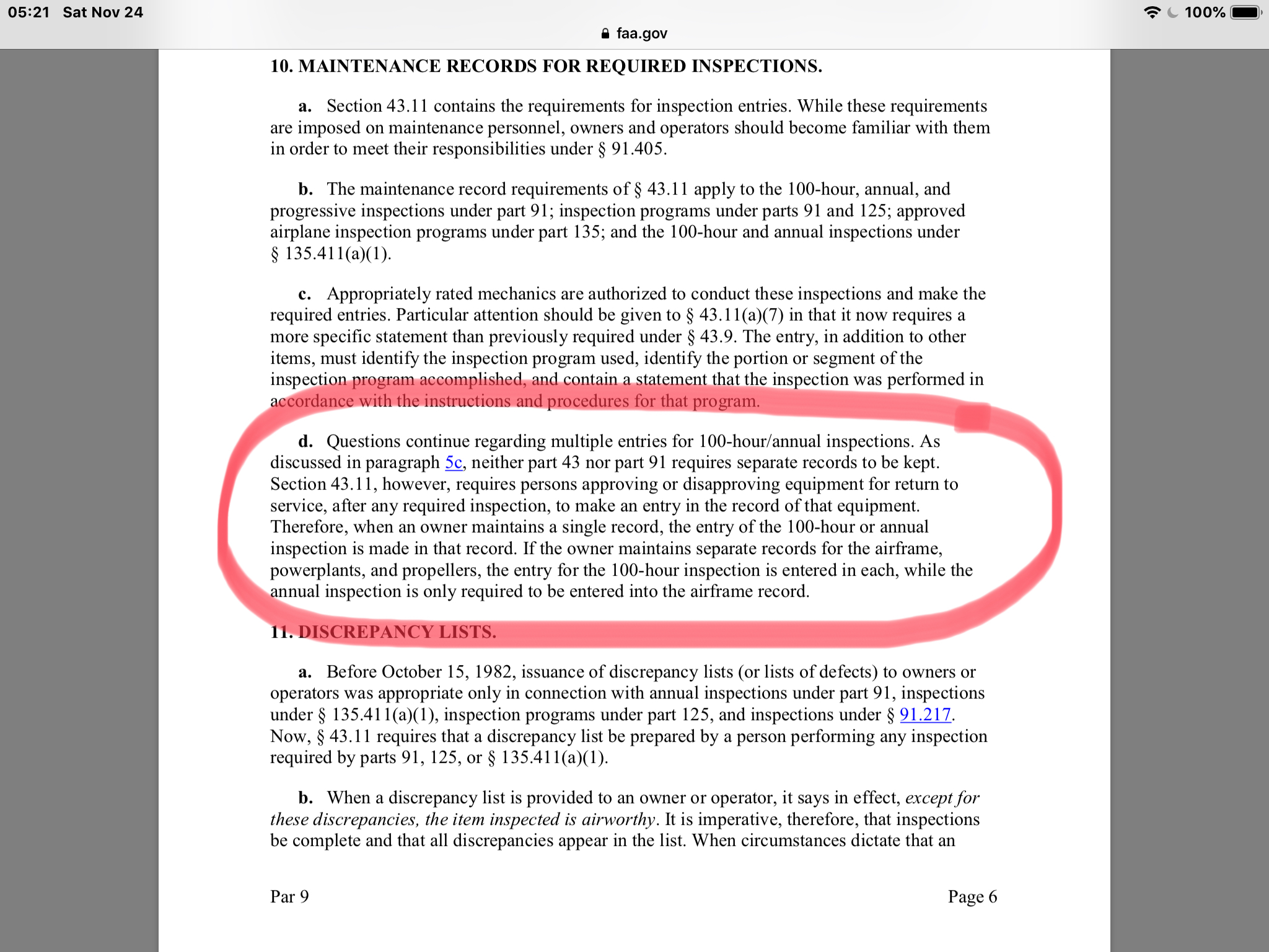

Here's a popular link that discusses "may" vs "required" when documenting annual inspections:
https://www.askbob.aero/node/3966
As an aircraft record keeper that has met with the Administrator's representative (the local FSDO) regarding records falsified by a local A&P (who was not yet an IA), I can assure you it's best to have documentation of the work performed on the airframe, engine, and propeller. Another aircraft owner complained to the FSDO so they brought in others that had dealt with the A&P, me included.
FSDO: Please show me your records.
Me: Here they are.
Later after review > FSDO: Ok, thanks as an owner you've complied with (something like this link):
https://www.faa.gov/documentLibrary/med ... _CHG_2.pdf
End of story.

Jumping in here to help beat the dead horse.

Let me at that horse, I'll give it a few more licks!
From the linked document (AC 43-9C):
"If the owner maintains separate records for the airframe, powerplants, and propellers, the entry for the 100-hour inspection is entered in each, while the annual inspection is only required to be entered into the airframe record."
"Is only required" are the key words here,
nothing says you can't enter the annual in the powerplant & prop logs.
"100 hour inspection" entries in the engine & prop books,
coinciding with an "annual inspection" entry in the airframe book, doesn't quite seem right.
But I can see why some IA's enter them as 100 hours.
I can even see where the one IA I know that doesn't enter them at all except in the airframe book has a basis for doing that--
after all, it's an annual, not a 100 hour.
Everyone else can do as they see fit,
but I think I'll stick to having "annual inspection" endorsements in all 3 of my logbooks.
