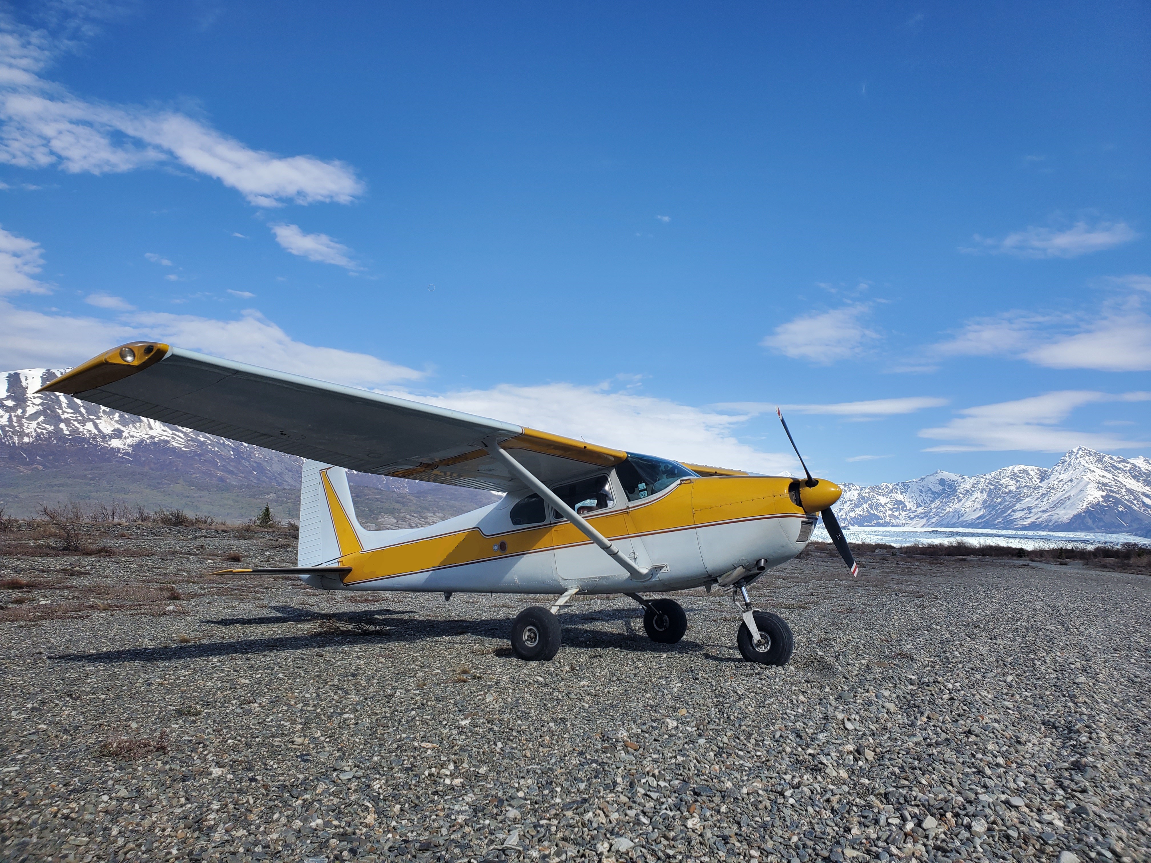

I got brave enough to fly into Picnic Strip @ Knik in the 182, which is why I ask. First time I've ever landed any place that isn't an official "airport" (in an airplane anyway). The plane does have 8.50x6's all around and the 206 airglas nose fork, landing and stopping was no problem and the strip looked to be almost half a mile long, it was the condition of the surface that was the concern, very loose "pebbles". Mud strip was a lot better even though it was only ~1000 ft or so!
I tried to find a good spot to park off to the side. Airplane would not really budge by hand after parking, just skid on the loose rocks whether I was pushing from wing struts or with the tow bar. Eventually just had to fire it up and power it out. Prop was fine after, and it probably took about 1700 rpm to get moving, but I was definitely worried about it at the time. That said, the airplane was based on a gravel field for decades and the 82" McCauley definitely has some nicks that have been filed out before.
