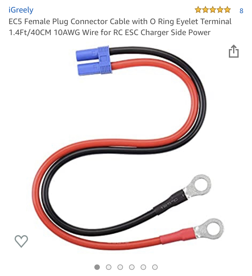

I’ve thought about this as well while out and about with the family and not with another pilot. In line with MTV’s comments, I decided a jumper box would be the safest option, but the alligator clips can shake off upon start up, so I purchased one of these cables. I tested out a routine and it works great. Could probably even run it through a firewall grommet and start it from the cabin?
