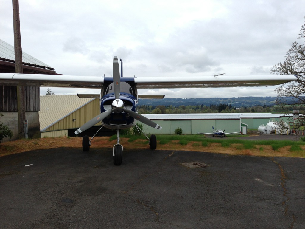

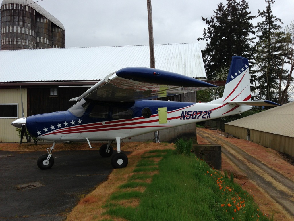

Had a sighting of the rare tricycle Courier this weekend at the airport:
Re: Helio Courier
Zzz wrote:Had a sighting of the rare tricycle Courier this weekend at the airport
That looks so wrong. :mrgreen:
