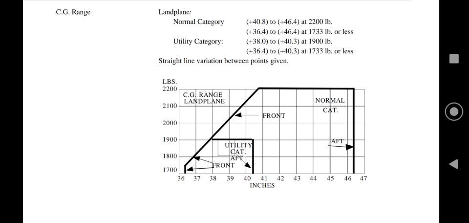

Wow, with a BBW already installed and battery aft, where's all the weight in the front? My 170 had MT prop, std tailwheel, battery on firewall, and I never considered it to be forward CG.
Or, are you trying to get the airplane close to the Aft CG limit while basically empty?

What is the current empty weight & CG?
Also, what is your W&B when loaded for your usual mission?
Intentionally moving the CG aft might make for better handling, empty,
but might also limit you when you want to load a bunch of gear for a camping trip.
Here's what the TCDS shows for a 170B:
