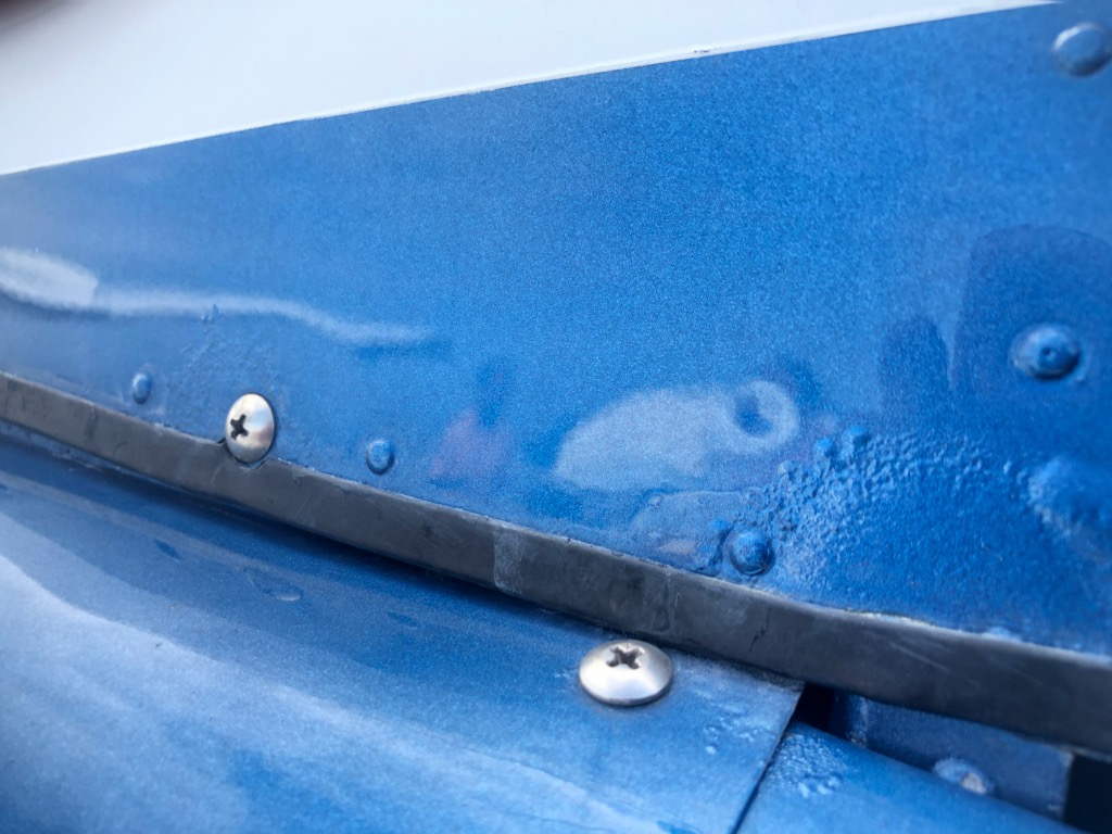

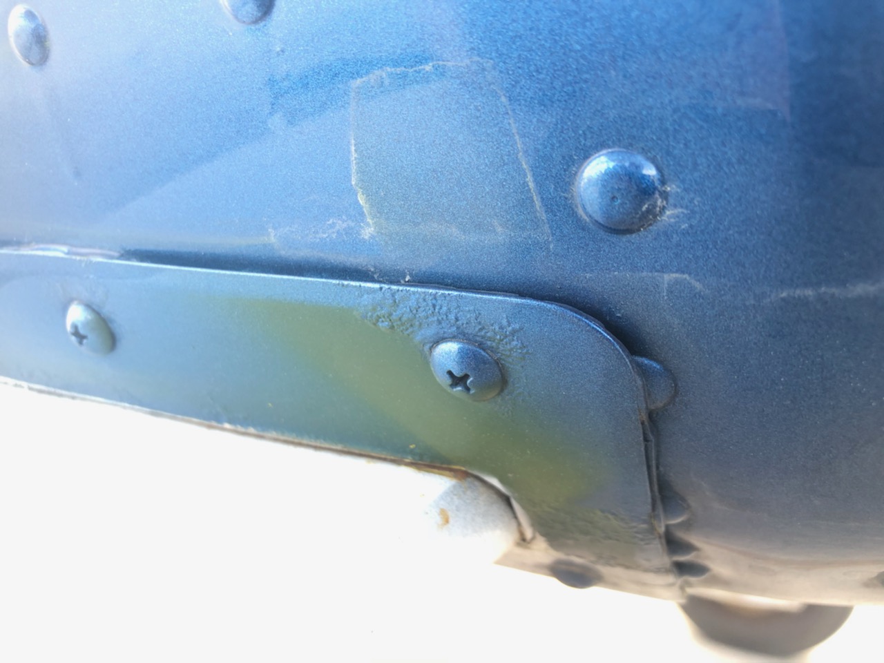

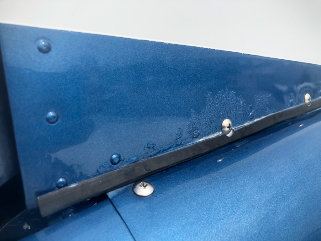

What do you guys think? I just got up to Florida to look at this plane and maybe take it home. The plane was supposed to have no corrosion whatsoever, but I can clearly see some signs just from the outside. What do you guys think? Im going to have it brought over for a formal and in-depth pre buy inspection today. Should I keep looking for other airplanes? Engines, props, interior, things can always be changed, but Im aweful afraid of a serious corrosion problem.

I would look in the tail and pull a section of carpet to pull a floor plate. I suspect you just saw the tip of the iceberg.

As the old saying goes "You can take the plane out of Florida, but you can't take Florida out of the plane!"
Of course every plane buyer wants a "No Corrosion, No damage history" plane, but in reality that's pretty hard to come by.
Hard to tell but is the paint fairly recent? I have seen some paint jobs with shitty prep done. They look good for a few years then start bubbling up under the paint. Also depending on the plane it may have zinc chromate on the inside which may help.
Get it inspected and make the decision from there.
It may not be bad or you may want to run away!!!

Where there is smoke, there is likely a fire.

I think I'd walk away and not even inspect. Clearly this aircraft is grossly misrepresented at the outset. That appears to be more than just a bad prep job on the surface. I suspect there will be many more surprises should you choose to inspect and move forward.
Curious what the sellers' response to your question of "you said not corrosion" and point all of this out to them.

He said "thats just surface rust. A little sand paper and paint will fix that". He also told me there was no damage history but I found 2 accidents in the past, one of them nose gear collapse, when doing my paperwork search. He also told me the engine was overhauled in 2015 but after under contract told me 2004. So it is timed out. He has been reluctant to work on the price with me at all. Soo...... walk away?

After all those lies - RUN! Don't waste a frickin dime more on any professional inspections. The seller is an absolute crook obviously. Why would you even consider a Florida plane? Especially when you live so far from there?
DON"T FALL IN LOVE or try to justify since you came all that way ready to fly it home.

I’ll echo what the others have said. If the seller doesn’t even know that rust doesn’t form on aluminum I would seriously suspect his other claims.
