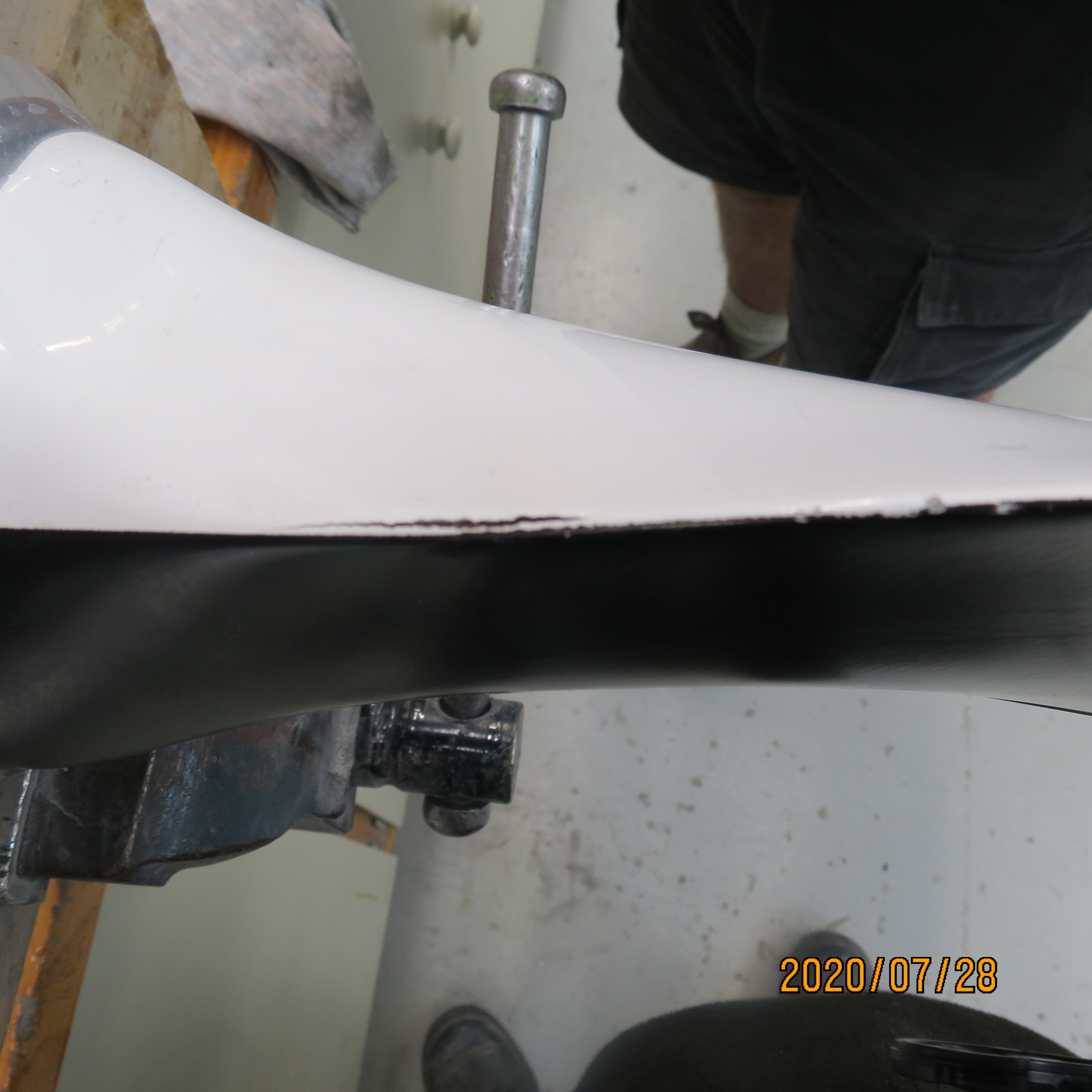

We love our MT but at 1100 hours we have had leaking blade seals and a small crack in the fibreglass on the in board trailing edge of one blade that was taking in moisture. No biggie and easy enough to repair, but just saying.
