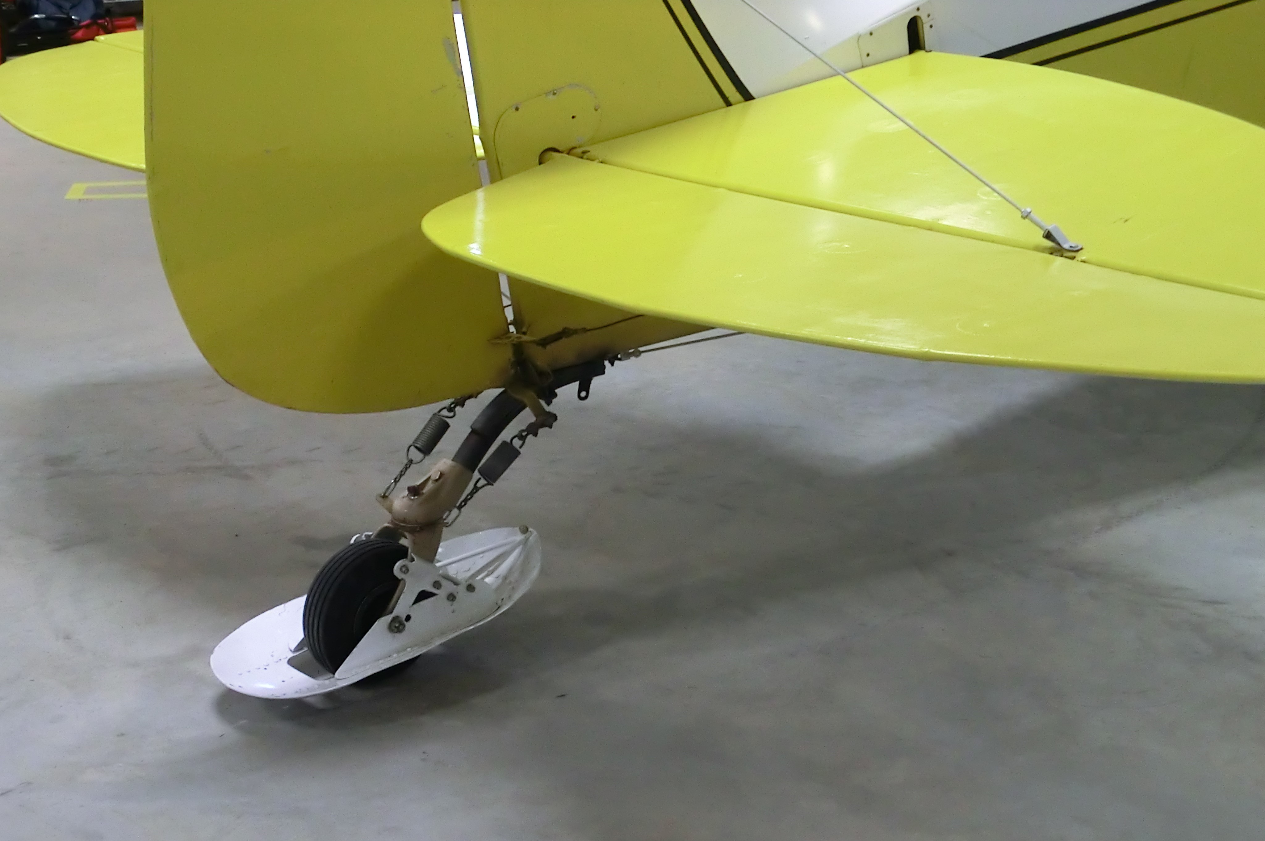

I definitely need a tail ski on my PA-16 Clipper. All of the short wing Pipers have pretty heavy tails compared to the long wing pipers. I find that my penetration tail ski is ideal because it works on hard packed snow and the fluffy stuff.

mtv wrote:Just buy one of Burl’s tail skis. Bad news is, there are no tail skis that fit a BBW.
Which is a message: Lose the BBW.
Am i dreaming? Pretty cool.... (when did they start polishing the fork arms?)

Hmmm, that's interesting. How to add weight waaaaay back aft, I reckon.

About 4 pounds, which every Pacer I've flown would have more than benefited from.
