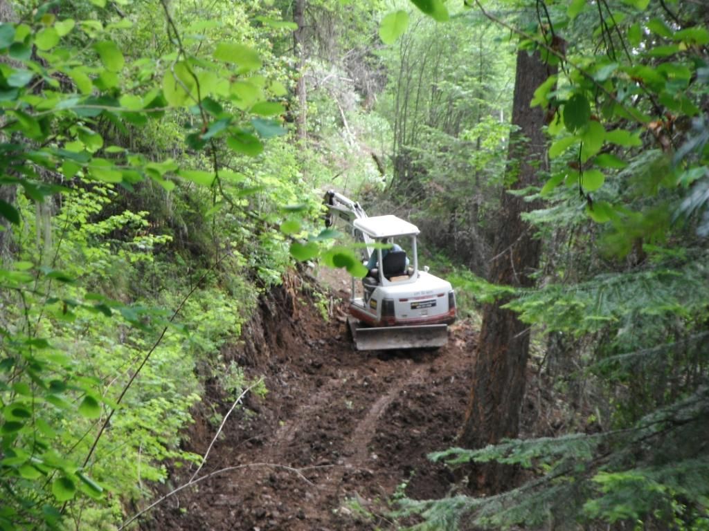

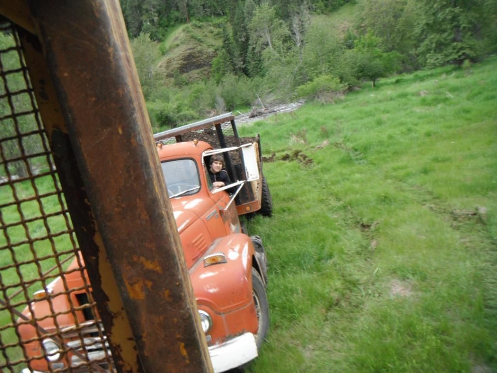

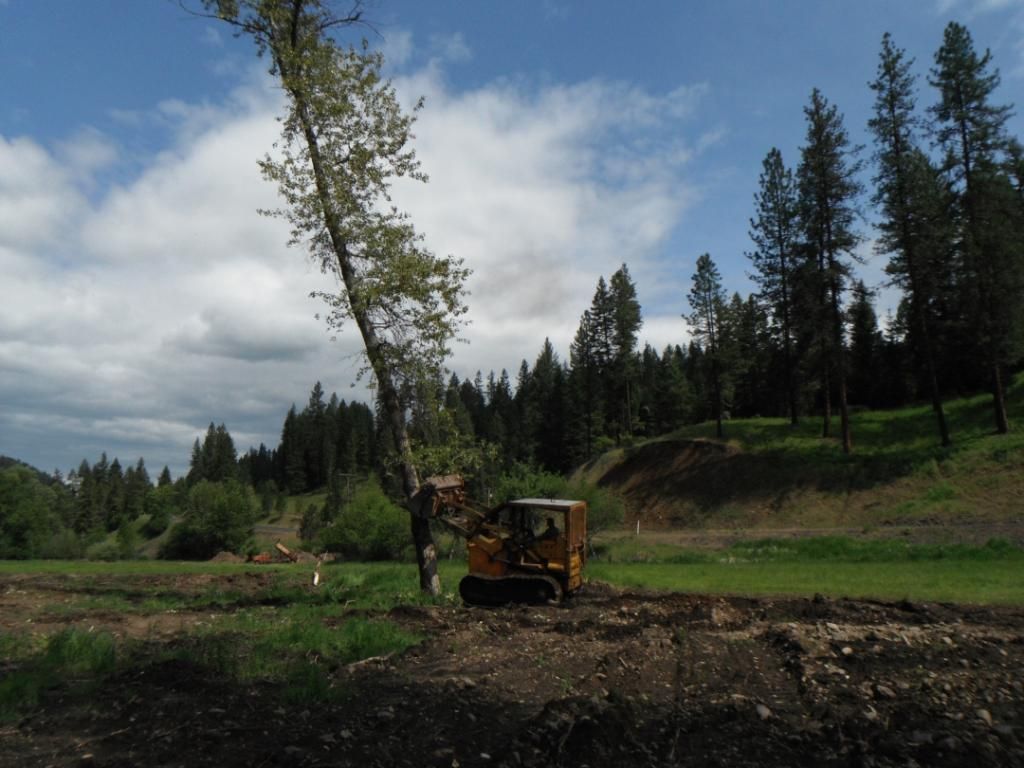

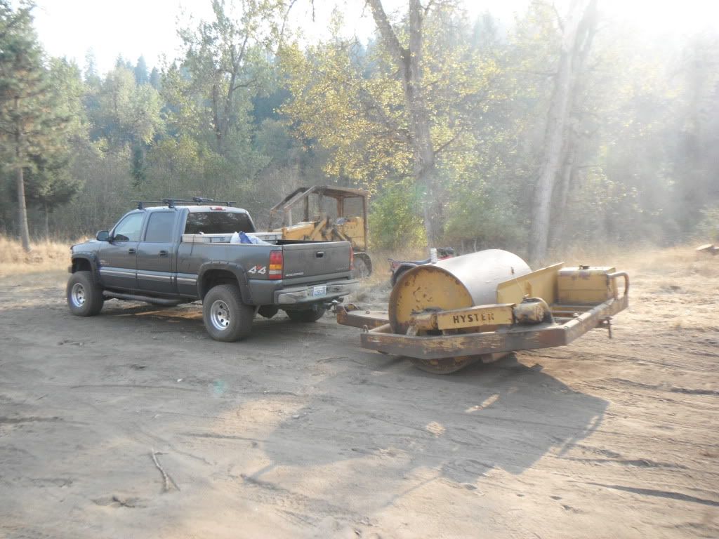

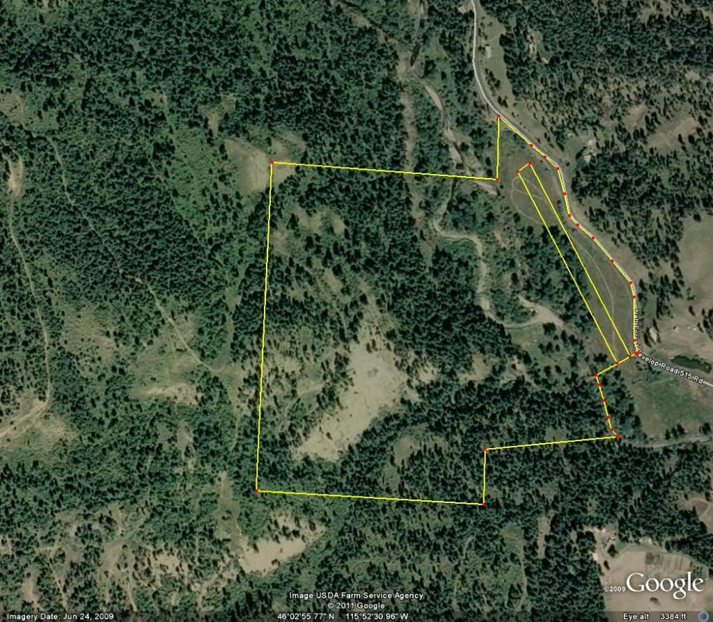

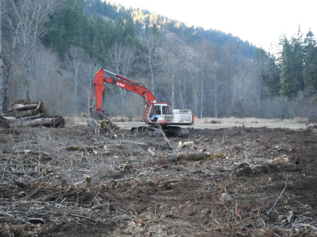

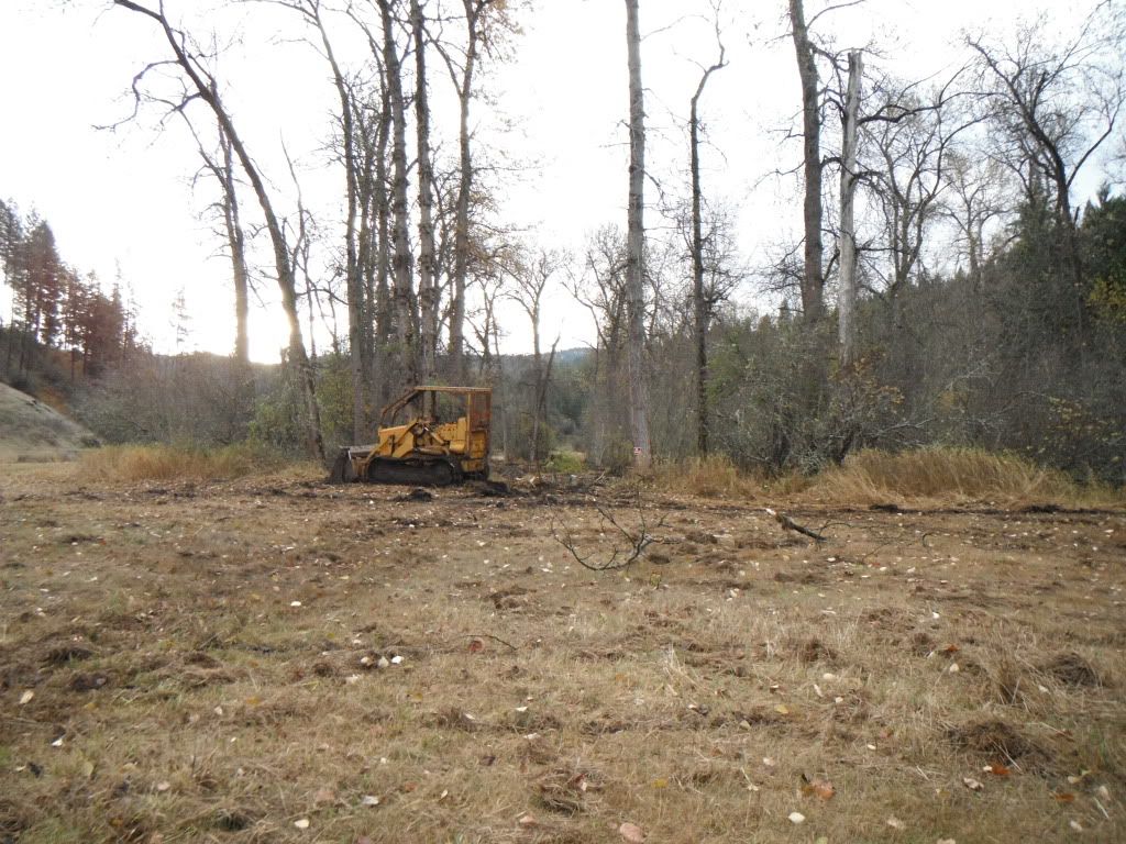

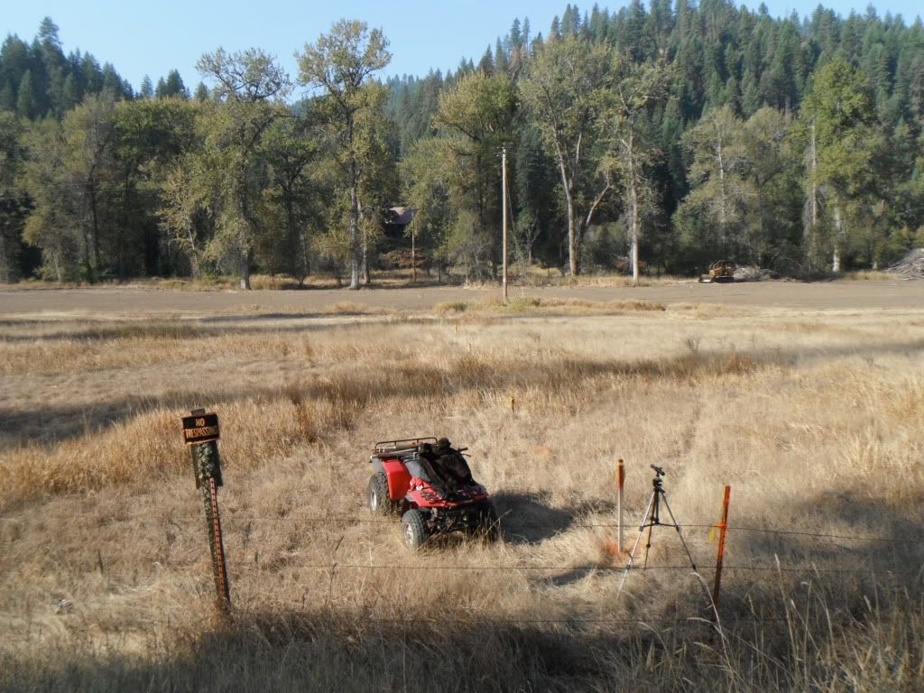

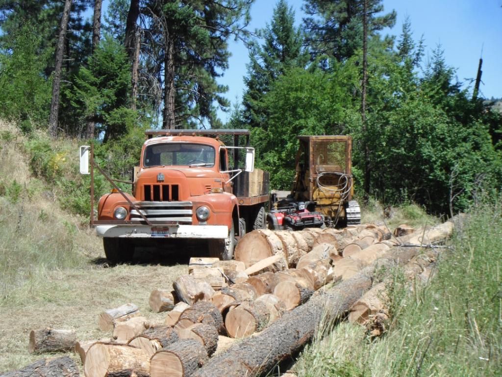

Thanks guys,
I am a long ways from building a hangar. My neighbor will mill rough lumber for 8 cents a board foot. Twelve or so red fir trees should do it. Hopefully I'll have the concrete slab poured this summer. The green wood will be chinked and dry for construction next fall.
My current project is to have another neighbor with a mini excavator dig a 320 foot ditch for power-line conduit. I'll set the 3 inch/ 10 foot conduit pipe and backfill with my tracked loader. The power company will move the pole for big $$$$$ OUCH. As far a the hangar construction goes, Idaho County does not require any building permits and thats way cool for me. I think I can build a 42 x 40 wood frame hangar for about 7 to 9K. A comperable prefab would be 19 to 21k.
Anyway next spring I'm planning on a airstrip grand opening-luau, and potluck. I hope some of my backcountry.org friends can make it too.

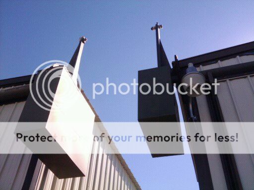

I think these doors were at Idaho Falls? This seemed like a good idea to me. I never liked the thought of all the weight of those big doors hanging from little cables. The doors were one piece and just pivoted up. These were metal boxes filled with concrete. They are counterbalances for the door. A 55 gallon drum should work good.
