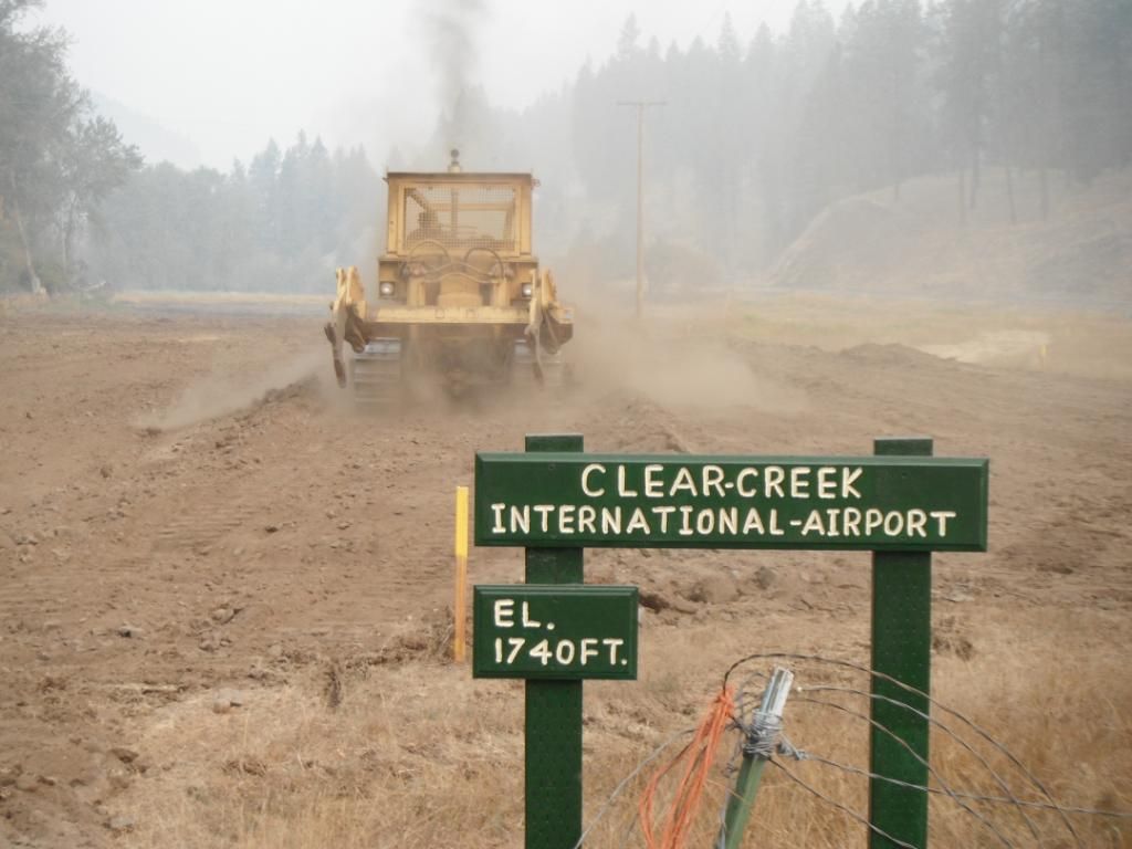

Thanks for the advise. I think I will go with my own rough cut lumber construction. I like the thought of utilizing our own timber and would rather support my neighbor's lumber mill. He is the same guy with the D-8 and road grader that finished my airstirp.
The problem I see with a lot of new construction is that people go cheap on the eves and make them too short if they have any eves at all. My plan is for a steel roof with two to three foot eves. This should keep the snow and rain away from the foundation.
I have a tendency to overbuild, and plan on lots of rebar and steel mesh in the six inch slab. The lumber is real 4x4 & 2x4 inch all red fir. And 58 Skylane, I agree that a stained solid wood hangar with a metal roof would look a lot better than the prefab metal versions. I do think I will hire a pro for the door construction.
This will be a big project for my 13 year old son and myself. I bet we will both learn a lot. Going to do some more seeding this weekend, and maybe a little hunting too.

You're making great progress fellow, that cat is getting some serious work done. Great idea using your own lumber and if you ever have a hangar party, let me know and I'll head up your way and pound nails for a couple of days. Just my 2cents, but consider the bifold door, they are just a great design especially if you have to deal with any kind of snow. I know at 1700' that may not be as big an issue, but those times it is, boy are they nice. Come look at our bifolds hear at 8S4 and I'll buy you breakfast too. Keep up the good work fellow at CCIA.
