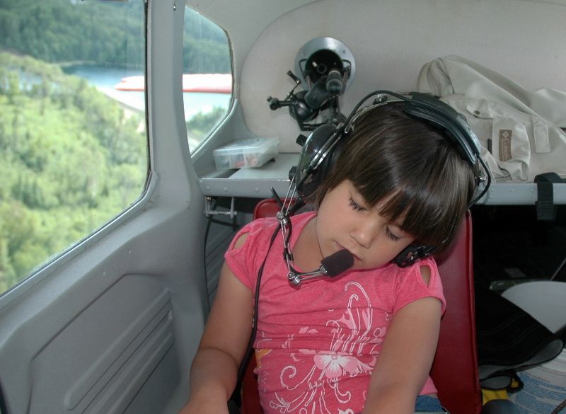

I have the Atlee Dodge rear seats in my C180H. I usually only have one installed because it is rare that I have flown with four people in the plane. They fold up against the side of the plane, but I prefer having the extra cargo space and reduced weight of just leaving it out.
The seat is so comfy my grand daughter easily falls asleep in it. :lol:

Hey nofate, do you have anymore info/pictures/details on that fishing rod storage I see in the picture?

Jeredp wrote:Hey nofate, do you have anymore info/pictures/details on that fishing rod storage I see in the picture?
The rod tube was in the plane when I acquired it in 2005. I'll have to check the logs to see if the supplier is identified. A quick Google search turned up this... http://airmetalfab.com/sites/product/op ... _tube.html
I always carry a couple of rods and some tackle so that if I have to spend some time on a lake while waiting for the weather to improve at least I can do some fishing.
