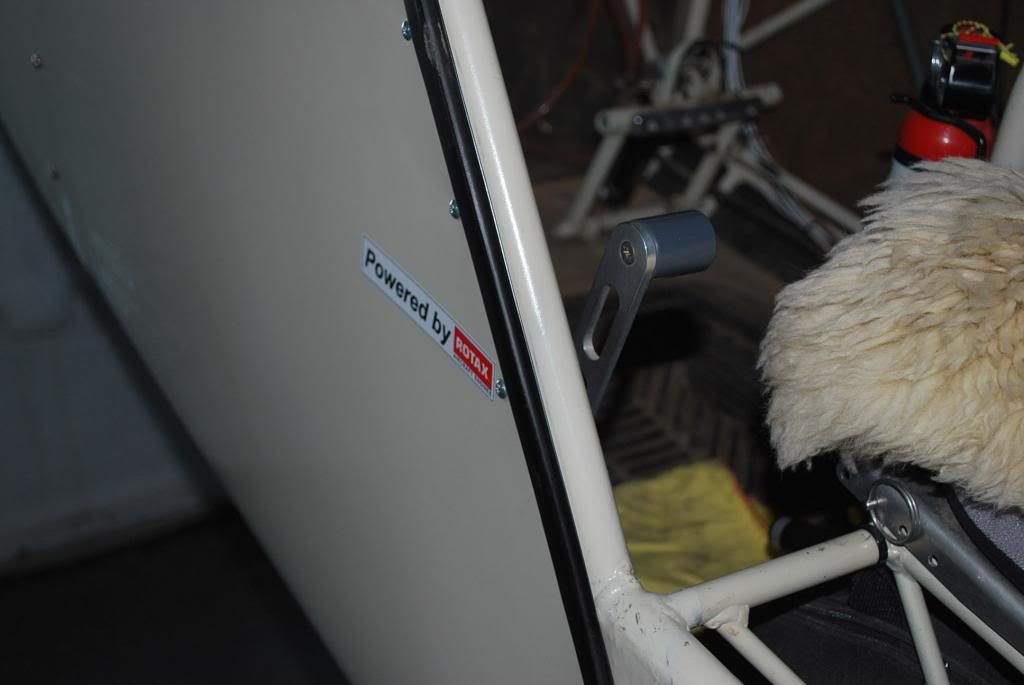

Here's how I finished my boot cowl/door intersection: some rubber molding from Spruce that glues to the cowl and has an offset that the door closes against. It was a super easy way to make a perfect fit at that important juncture, and have a little give of rubber. Part# 05-01700 The Rotax sticker covers up a scratch that happened during final assembly. Another thing is the fire extinguisher location, much more out of the way then on the floor, and even more easy to reach quickly, that open floor space is too valuable real estate to clutter up. ImageImage
