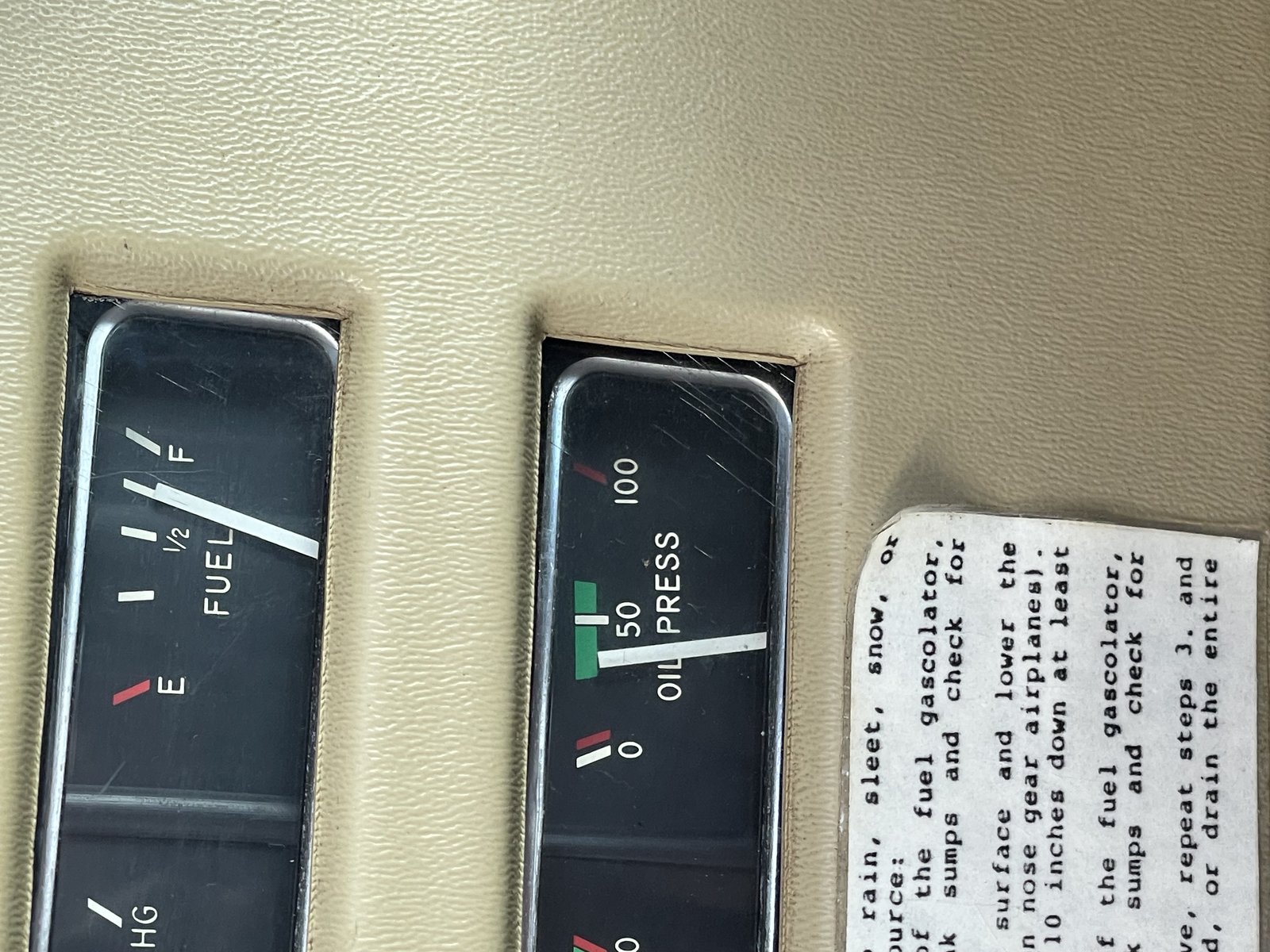

Put it all back together and now the oil pressure is ~30 in cruise. (In green arc but barely). About 10 PSI less than it was before the engine work. I have pictures from cruise in July showing oil pressure right in the middle of the green arc in cruise then pictures of it the day after the engine maintenance bottom of the green in August.

Current cruise oil pressure now

It’s posable you have introduced some crud that got under the seat of your oil pressure regulator. I’ve only seen this once myself but in a late case Ponk’ed 180.
Pull the pressure regulator, ha ha ya I know, then get a mirror and I light and look in the hole. The one I found was a tiny chip of metal from an unknown source laying inside the bore/seat.
If I recall this engine made pressure until the oil warmed then sat at the bottom of the green or a couple needle widths bellow.

I think the first thing to do is hook up a proper manual gauge and compare to the Cessna gauge then assess from that point.

Provided the engine appears to be running well, my first step would be to hook up a test gauge and find out what the oil pressure actually is.
