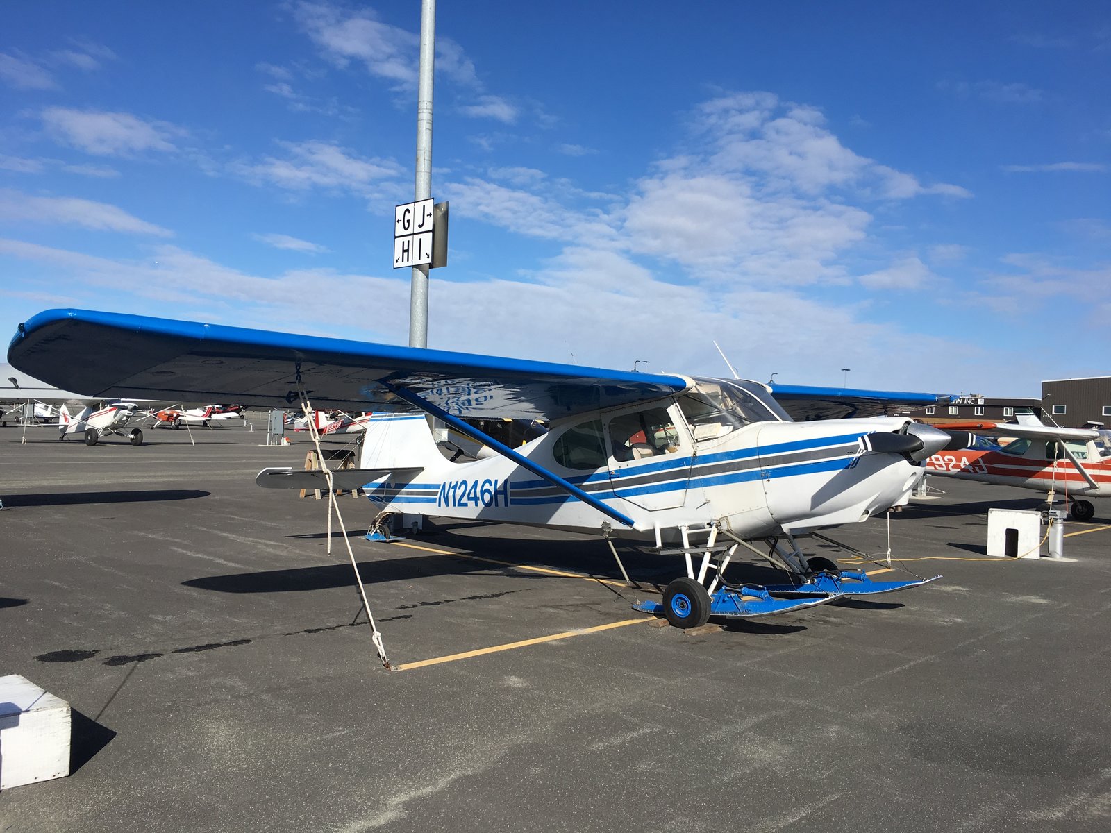

Re: Sedan on wheel skis ?
Sedan on wheel skis
Very nice, but that's no 0-300 under the hood
