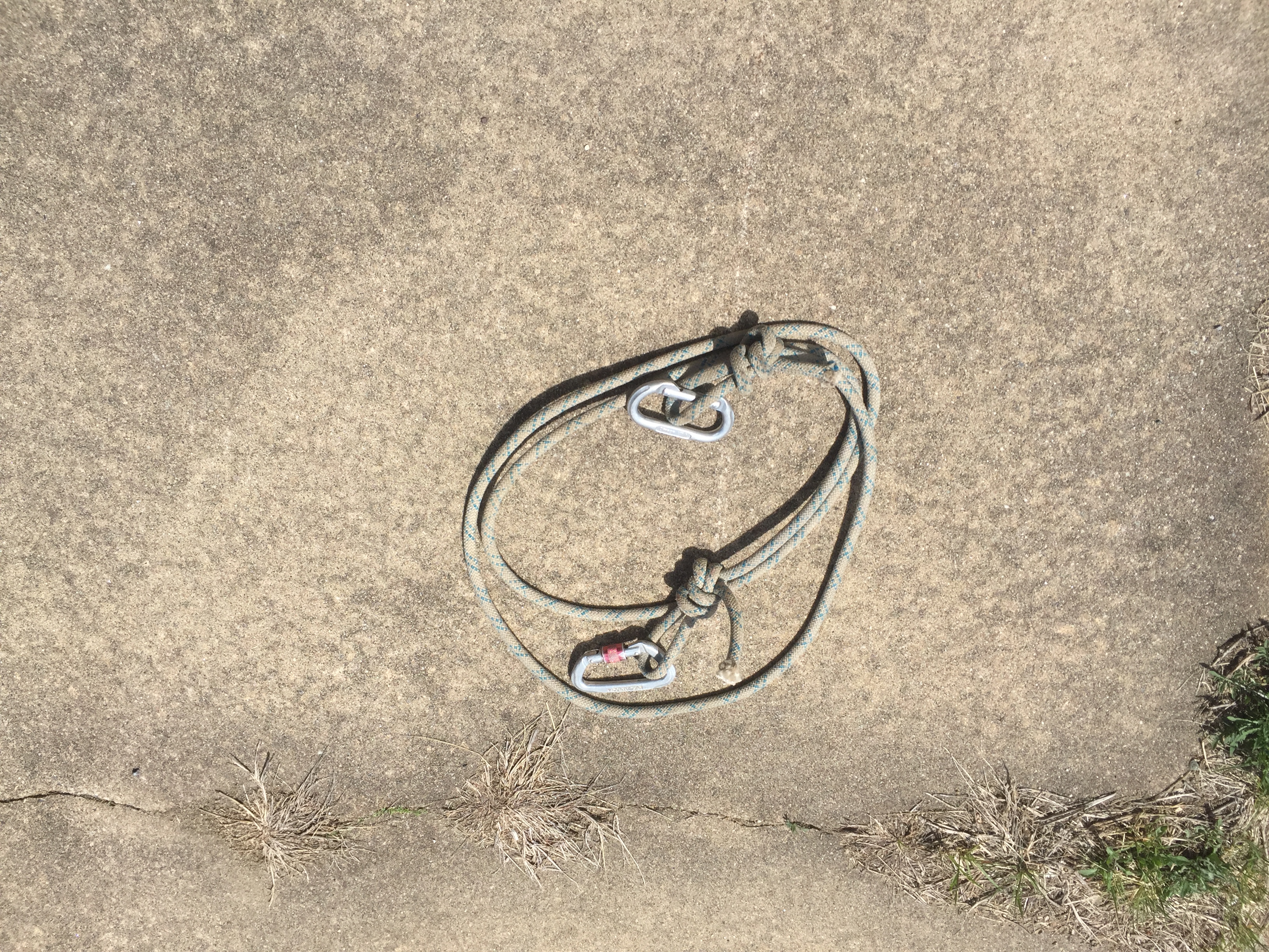

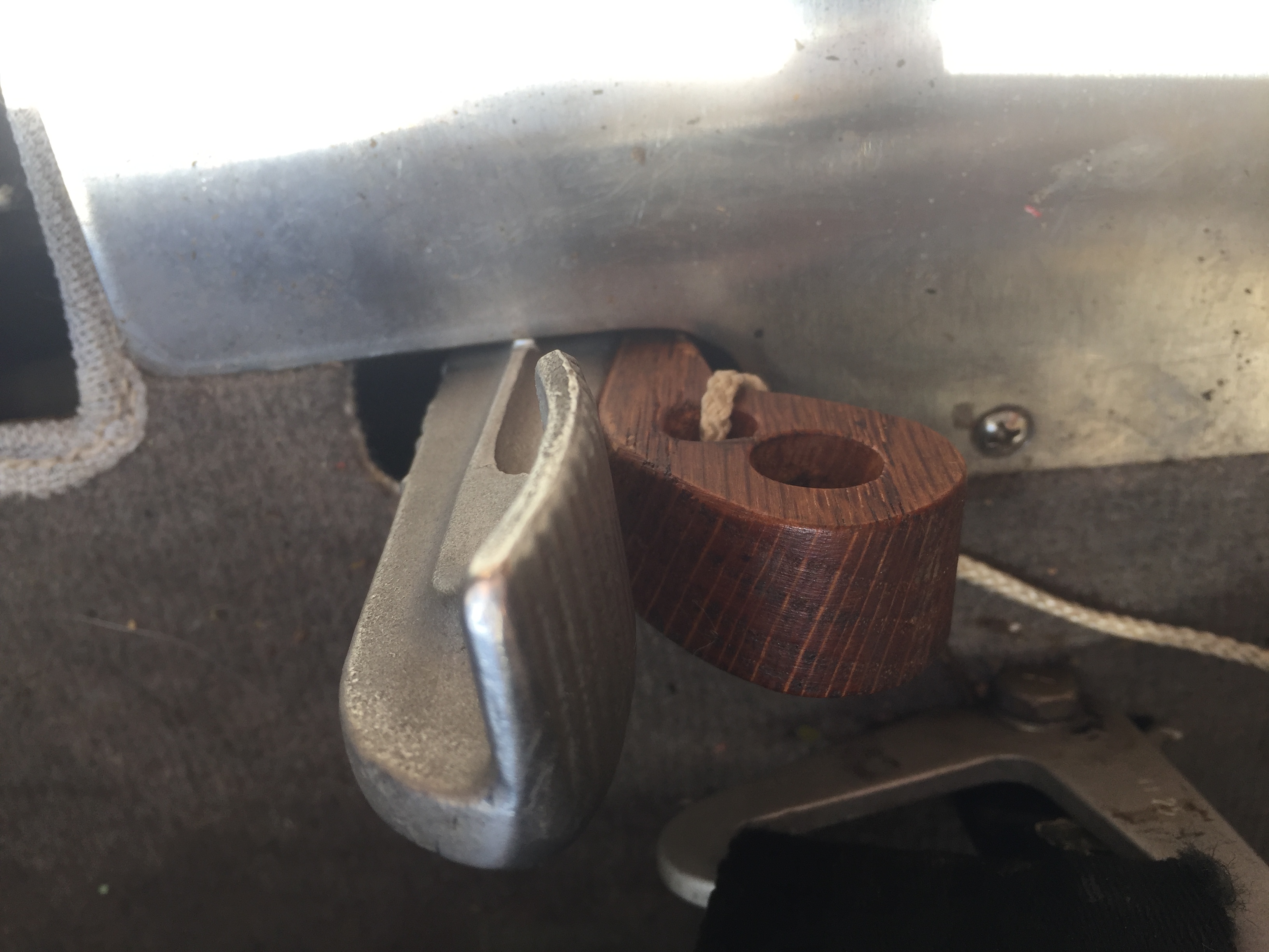

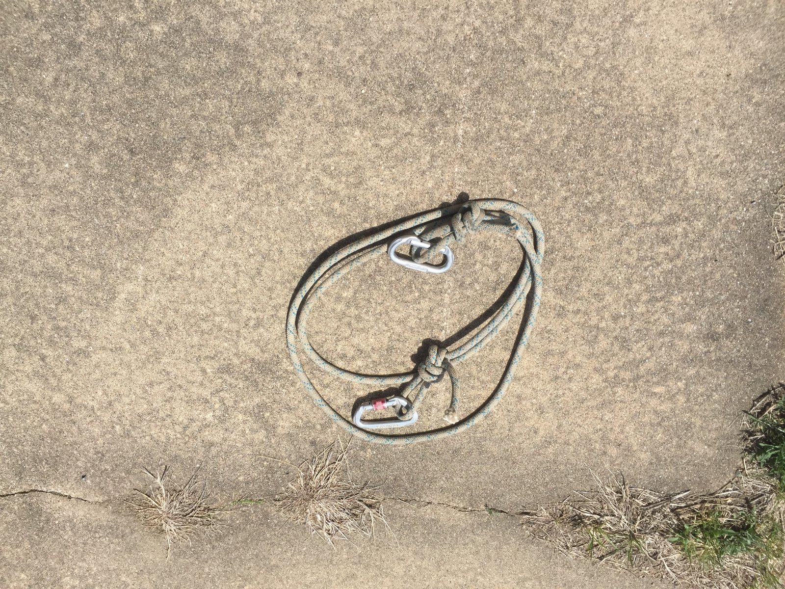

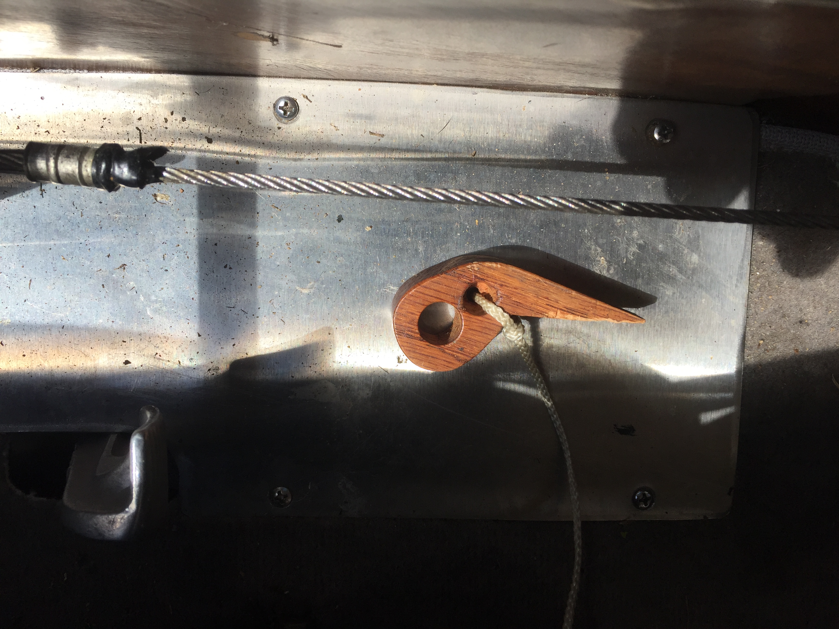

It’s already been said, but I watched a guy hand prop a neat old champ with a set of wheel chocks that had a long line tied to them. He had the free end in the cabin, and when he got in and got settled he yanked the line and put the chocks behind him.
I wonder if tying the tail can be done similarly with a long loose end that you can pull to release from the cabin. I think you’d leave the line behind in that case but if it’s your home field you might could get it back after you return.

1st year for me handpropping and I have tied the tail or received a prop every time other than when I couldn't turn around with skis on once. If I am stopping somewhere that no one is around I will make sure I park next to something I can tie to. I carry a length of static line with a carribiner on each end. Once it's in idle it won't move on grass and can be easily handled on pavement even though I sweat it out every time. My plane also came with these cool parking brakes although I haven't had to use them yet. They actually work. So far so good. The 65's start easy unless you flood the thing.
