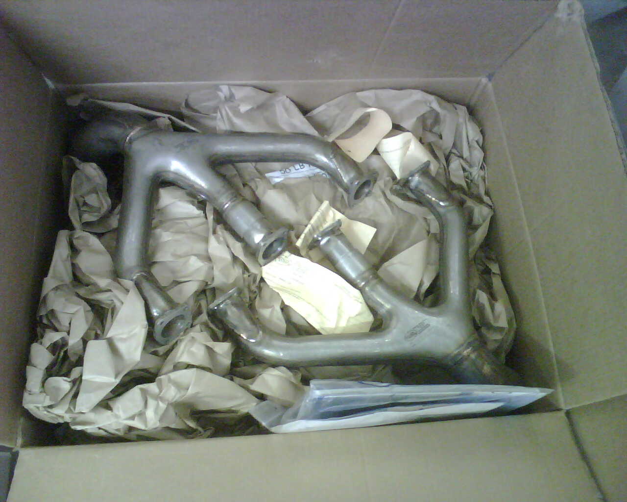

Mapleflt wrote:Glad I'm asking the hard questions now. How about Acorn I've heard good things but no operational intel.
Get in touch with Atlee Dodge in Anchorage. They make quality stuff, and they know what works on those engines.
I THINK Acorn is a repair shop, as opposed to a manufacturer. That said, I’ve had them “repair” a piece of an exhaust system, and the “repaired” part came back new, with one little bit of the original attached.
Acorn manufactures new product. Darn nice stuff that lined up exactly with no fuss. No core charge or items given to them for repair, they just took my money and sold me these new mufflers a couple weeks ago and shipped them to me in CA. Got a $0.00 invoice from FedEx about a week later saying no duties or taxes were due. Sweet!
They even sell brand new shrouds and shroud spacers. I'm really impressed with their products.

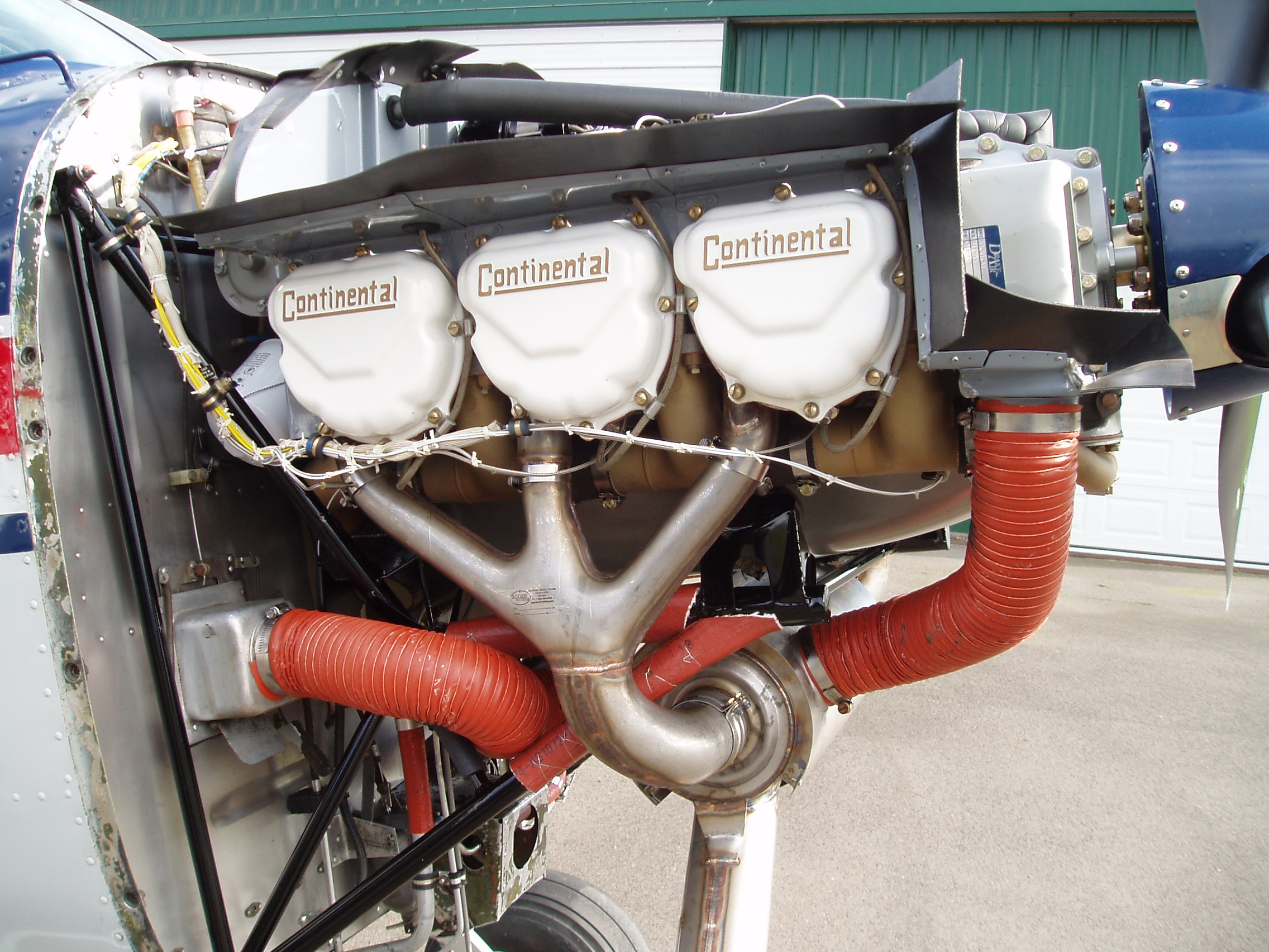

More engine porn courtesy of Aryana. :wink:
Posts: 2380
Re: This is exhausting
Ok, I'll post up the full view if you're enjoying it!

Aryana wrote:Ok, I'll post up the full view if you're enjoying it!
Are those pipes STC? Or what is the advantage of going out the back like that? Less drag so a bit faster? I like the idea...
Posts: 5218
This is exhausting
Yes, Doug Mueller owns the STC for the tailpipe extensions.
They have a number of advantages.
- lower cowling removal and replacement is 1000% easier
- no more exhaust streaks to clean
- reduced possibility of CO in the cabin
- sounds great
- lower cowling more streamlined with no tailpipe holes.
- more power from improved exhaust scavenging
Contact Doug here: http://www.bmflyingservice.com/

Aryana wrote:..... Doug Mueller owns the STC for the tailpipe extensions.
.....Contact Doug here: http://www.bmflyingservice.com/
Are they still called the "Bartone exhaust"?
Posts: 10600
Was Bartone, then Benham (or was it the other way around? [emoji2371] )...
Now called "Mueller exhaust"

Aryana wrote:
John D Benham was one of the 170 Assn founding fathers,
he had an IO360 Continental powered A model.
Guess he had the swept exhaust on it.
By the time I came along (1997), Pat Bartone was selling them & everyone called them the Bartone exhaust.
Great that Mueller has an STC, I kinda recall that they used to be a field approval.
Posts: 10600
Yeah, Doug spent a bunch of cash (tens of thousands of dollars) to correct all the paperwork problems with the FAA. The reason I never bought them before is because the STC was incomplete. Not any more!
