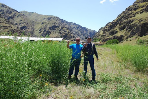

Here's some tall grass...
Low and slow flyby's are key. Walking it is even more important. Dont think I would ever land in tall grass that I am uncertain about. Way to many things can be hidden. Just does not make sense.
