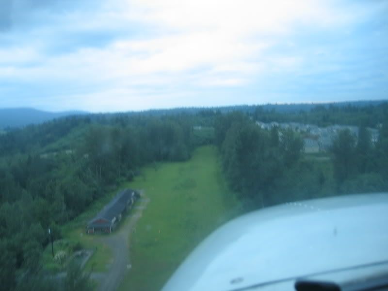

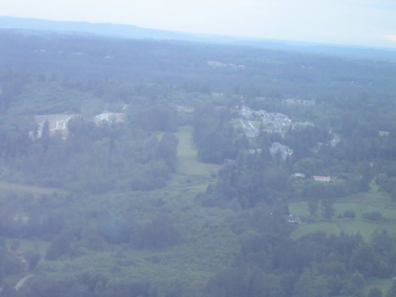

Here are a couple of crummy quality pix that I snapped during low passes at S86 yesterday. First one I got down pretty low and had to herd some horses off the runway, then I went around again...and the horses were still on the runway, so I went elsewhere. Notice how tall the trees seem off to the starboard side...they are definitely taller than the swath is wide.

Minus the horses, it looks like a fun strip. Good luck with it!
That look like a fun strip!
