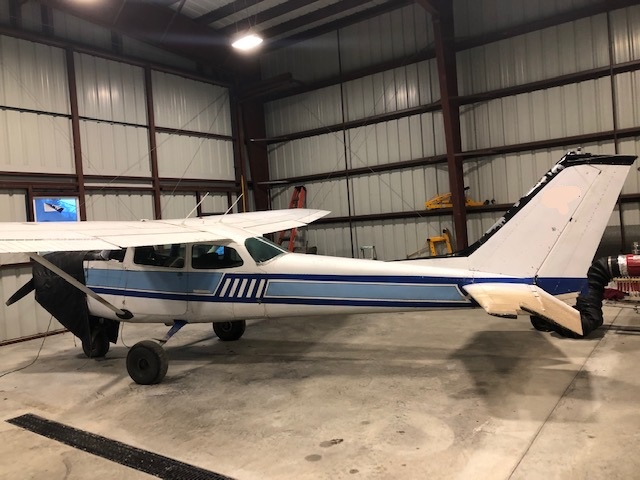

Good point. A 180hp 172 then? I instruct in an old 172K with an O360 conversion that straight leaps off the ground. We have 850s on the mains and I'd take it anywhere that I would've taken my C180. Sure, that's probably because I cared about the condition of my 180, but still, this 172 performs. It cruises at 120kts burning 9gph, and has the same cabin width as an early 182. Off the runway in a couple hundred feet at sea level with 10deg of flaps, the extra 20hp in 172's truly add a lot. I formerly instructed in a newer 172S with the injected Lyc IO360 which also performed great, and I'm a sucker for fuel injection, but being seen in a brand new 172 is akeen to being seen in a trimaule.
See the mud on the horizontal? That doesn't come from paved runways.
