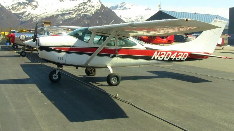

This first pic are the 7.00 x 6 on the mains and a 6.00 x 6 on the nose?
Or 8.00s and a 7.00 on the nose?

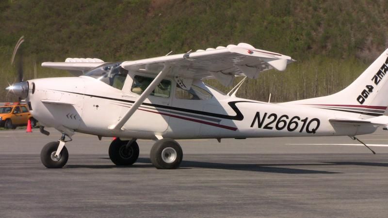

6.00 x 6 on all thre tires? or 7.00S and 6.00 on the front?

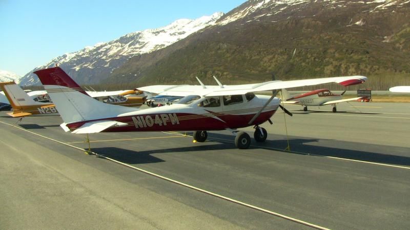

And this one? (too big for my operations)

I'd say the last one is 8.50x10s on the mains and 8.50 on the nose. For what I've seen of your operations I'd say this is the perfect setup for you.

I say the first pic is 8.50 all the way around?

Terry wrote:straighttail has the 182 heavy fork, he would know what would fit.
Looks like it to me.
Re: What tire sizes are these? (bought a fork :) )
When you put a 8.50 x 6 on a Landis fork it "fills" the fork. No room for any bigger tire.
You can see the tire "fills" the fork on that first picture.
I agree it has 8.50's all the way around.

In the first photo the nose gear linkage looks pretty colapsed and the tail is still low. Need to cut some of the lower strut off to keep the plane level and the strut up where it should be?
