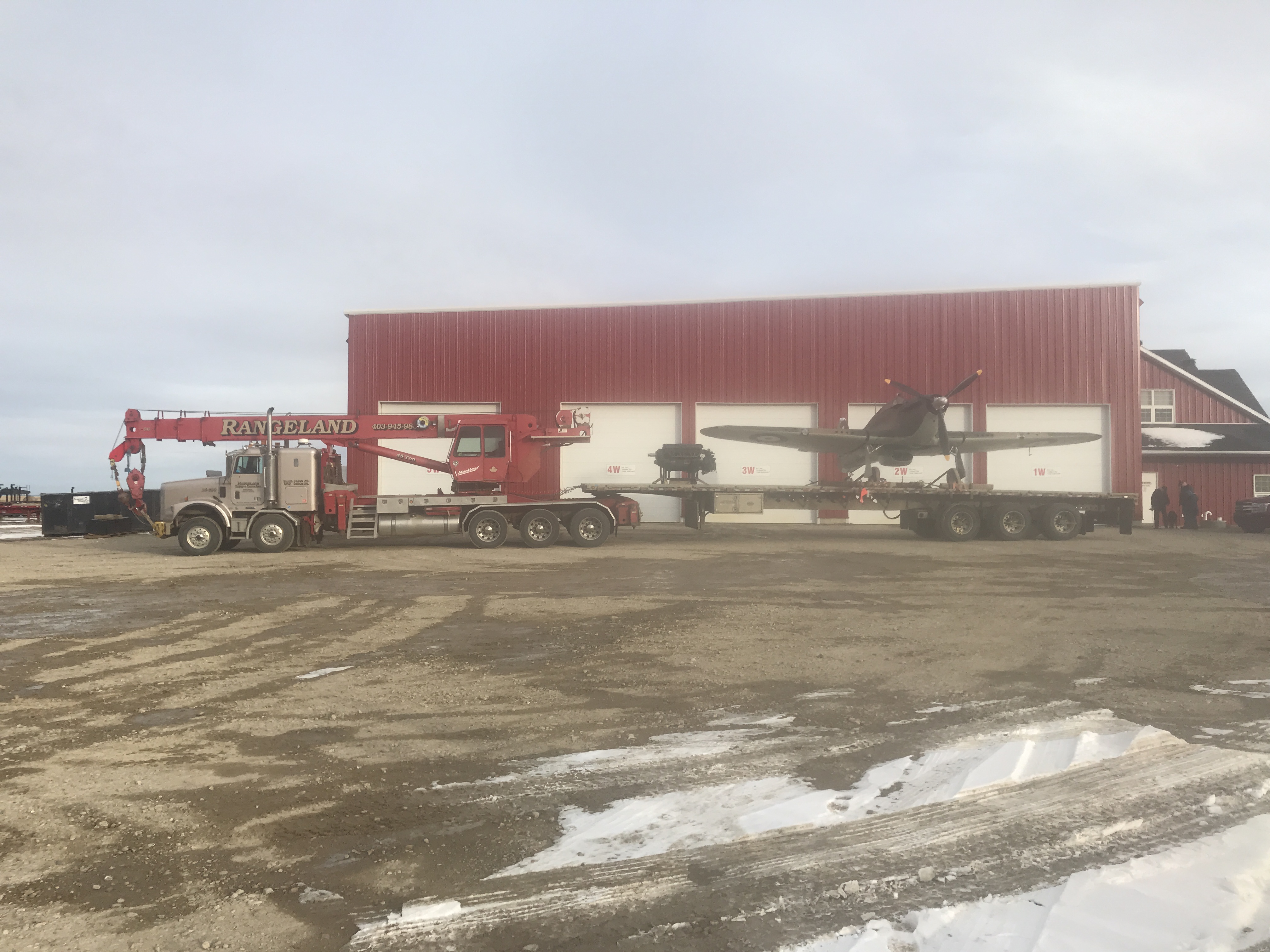

like a little bit of the plane on the crane.
Some plane on the crane on the plain!
Here’s some plane on the crane on the range for you! :D
Yes. The Hurricane is the real deal.
Pinecone offline
Posts: 996
Location: Airdrie
Re: Why so much nose down attitude on skis?
Great pic! Looks like a 60 or 80 ton Manitex?
The untold story about the picture I posted of my rig in front of that range, is that all four of my stabilizer pads are still there! I had driven 2.5 hours that day, stopped to take the picture as just the day before I was screwing around the same area in the plane, then drove another 30 miles to the jobsite and THEN found I was missing a pad. For all I knew at the time, I could have lost it anywhere along the drive, it wasn't until the next day that I looked at the picture and saw the pad (right rear) was still there! That narrowed my search area down tremendously, to the last 30 miles, so I drove up in my car, couldn't find it, then flew up a few days later, no dice. Put up reward signs in the area, no luck. Ordered and received the new one, and 2 days later got a call, someone had found the old one! I flew back up to get it, had the $250.00 reward money in hand, and the guy refused to accept it, it almost got ugly when I insisted, but he wouldn't budge, so I told him OK be that way, and flew home. Now, I have a spare pad, which means I'll never loose one again of course.
45 ton Manitex. 96’ boom. 32’-49’ foldaway offset jib. Two winches. 2007 Freightliner. 550 C15 Acero. 18 spd. auto shift so I could talk on the phone while I eat a sandwich and not have to hold the gear shift too! I seldom drive it anymore.
All that crane, and can still scale a 44,000 lb. payload! 137,000 lb. licensed GVW.
