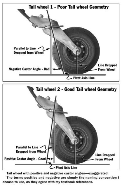

I am having shimmy problems with my new 180K. Before I start trying a bunch of things I thought I'd see if someone can give some advise. I understand the geometry thing and it doesn't look bad and the 1.125 inch tail spring doesn't look sagged out. I have been wheel landing and holding the tail up. I did put a new XP Mods 1 inch spring tailwheel with 10 inch tire on my old 1954 180 and that doesn't shimmy much----just once in a great while. Should I start with tightening the castle nut on the bottom or are those set screws that can be tightened or????? Thank you for any advice!!!!
Re: 180 tail stinger re-arching?
There’s another recent thread that deals with this:
https://backcountrypilot.org/forum/tail ... lit=shimmy
Tail wheel spring geometry is addressed here:
