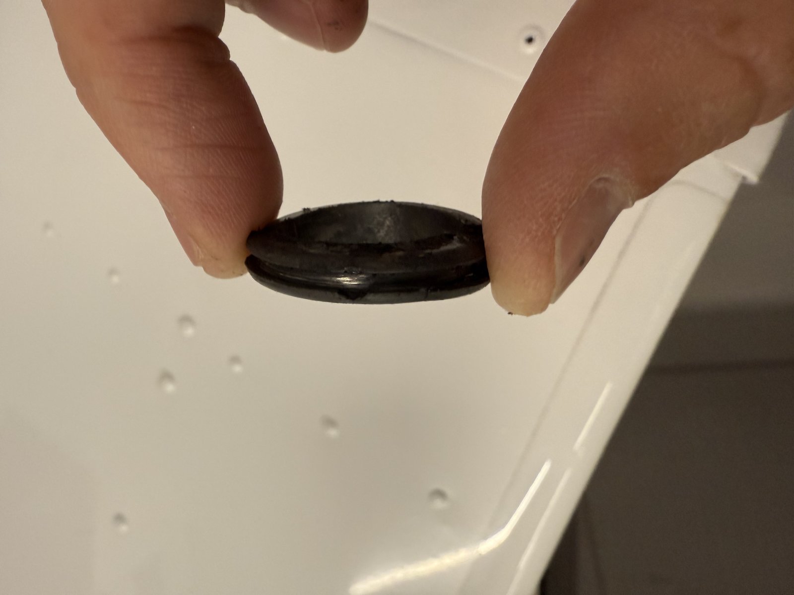

I have a 73 180J model and am in need of the bushing where the control yoke tube goes through the panel. I read a couple threads about some sorts of a Teflon ball bushing but this is something different. Ill see if i can get some pics uploaded. Does anybody know where i can source a couple of new ones? I found my current one laying in pieces on the floorboard on my last flight. Not Good.

Here is a pic

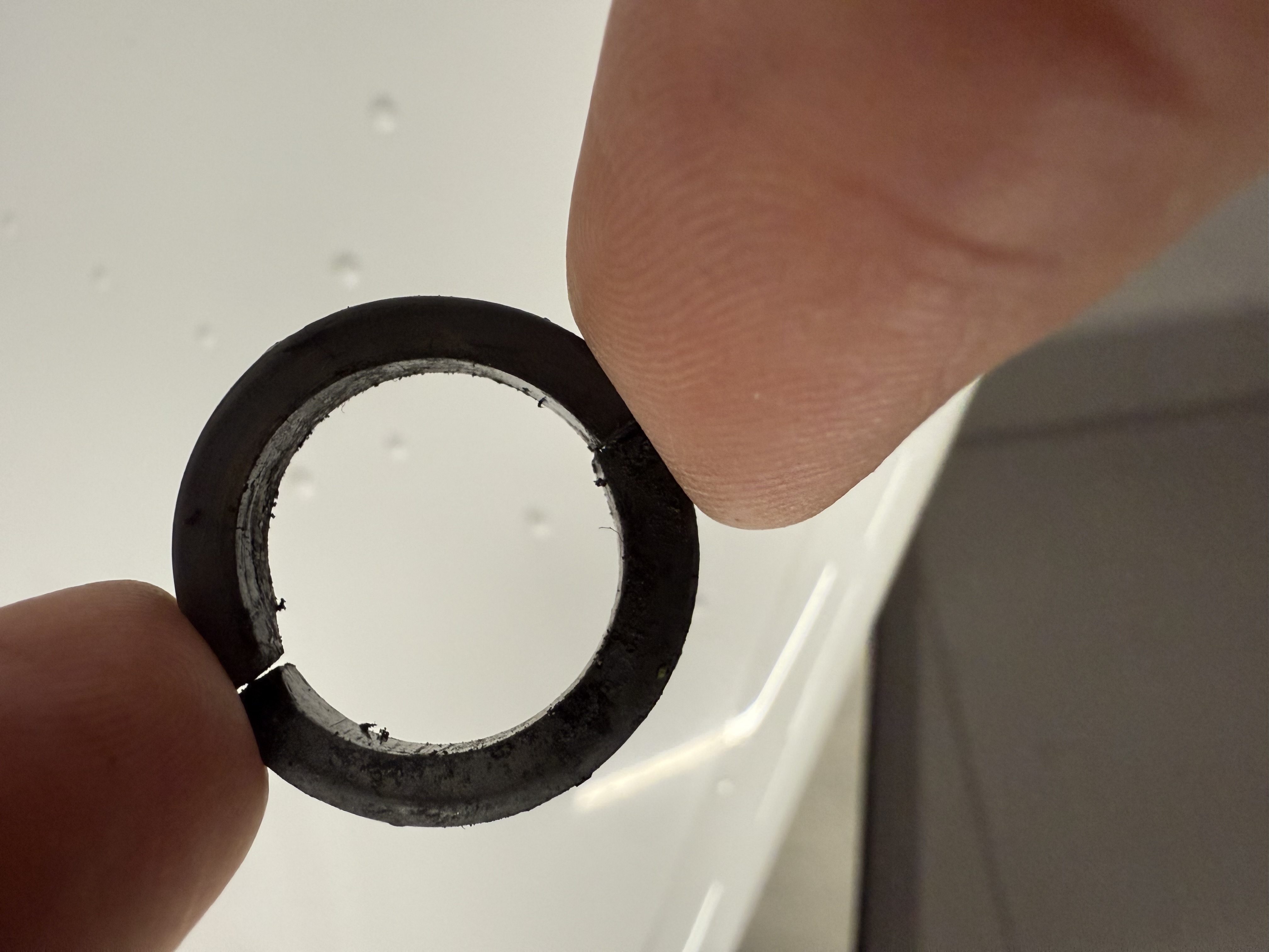

Re: 180J Control Yoke Tube Bushing
Pic

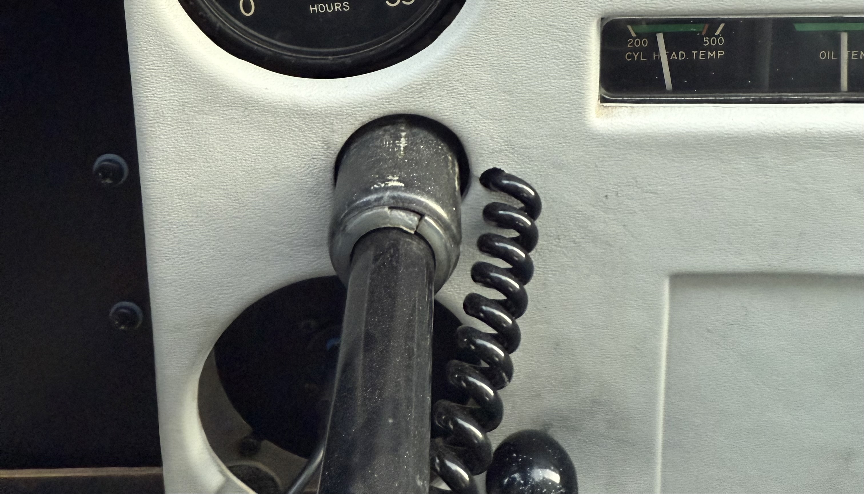

This is what it looks like installed

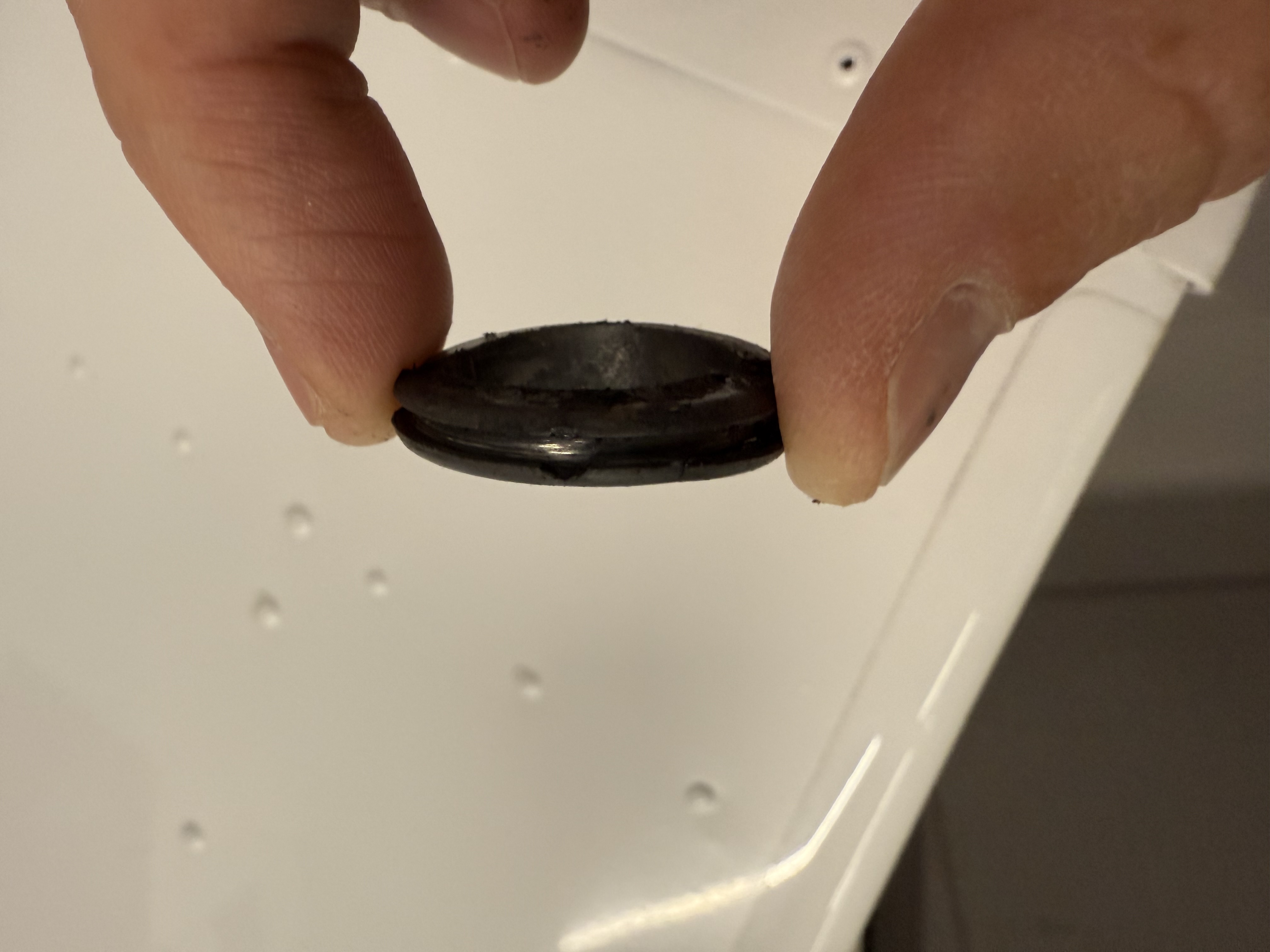

Order right from Yingling. Find the P//N in the IPC
Posts: 2358
This is the part number 0513056-3
At $20 each (need 2) ridiculously expensive for a part costing less than 25c to make
