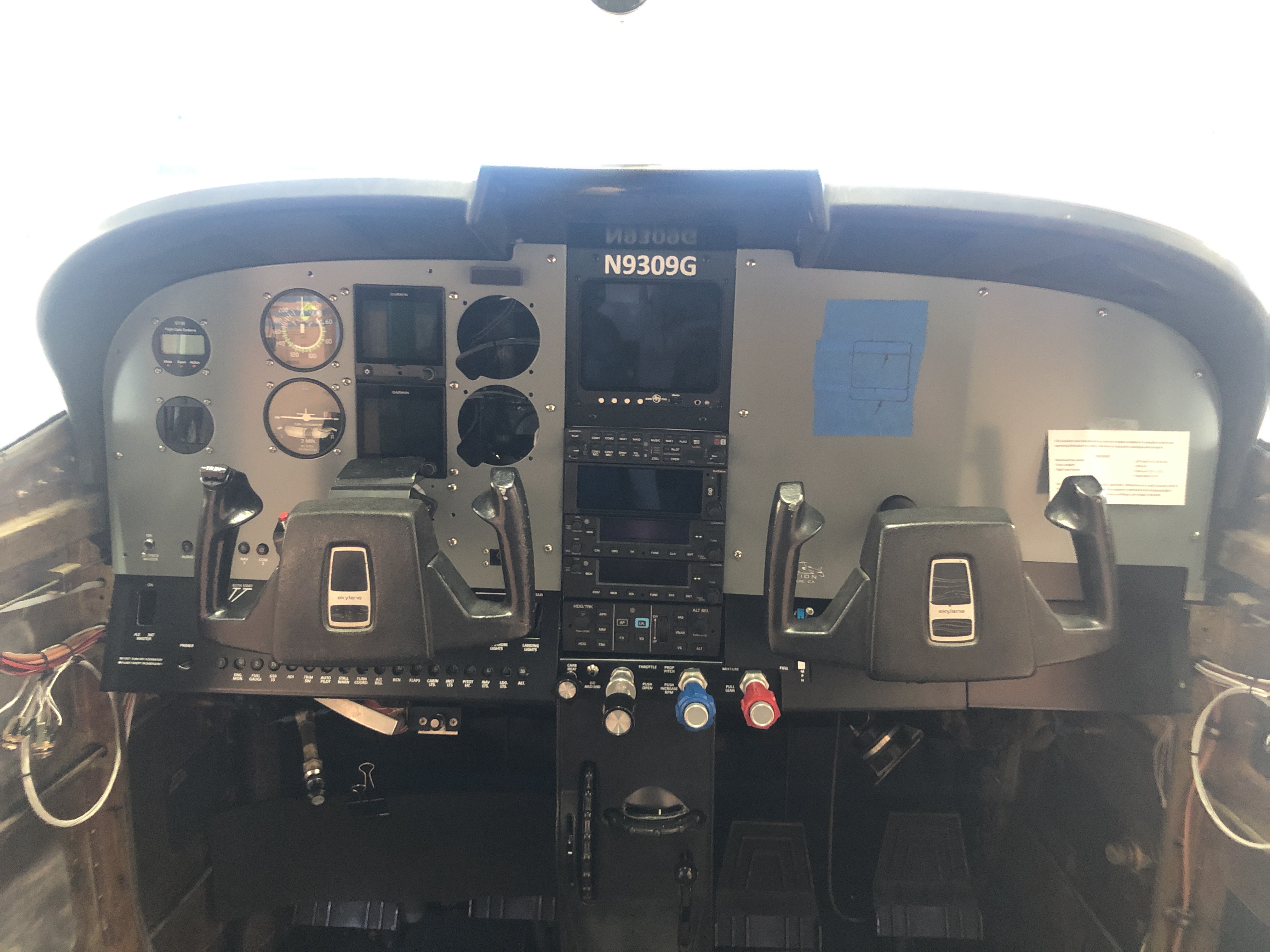

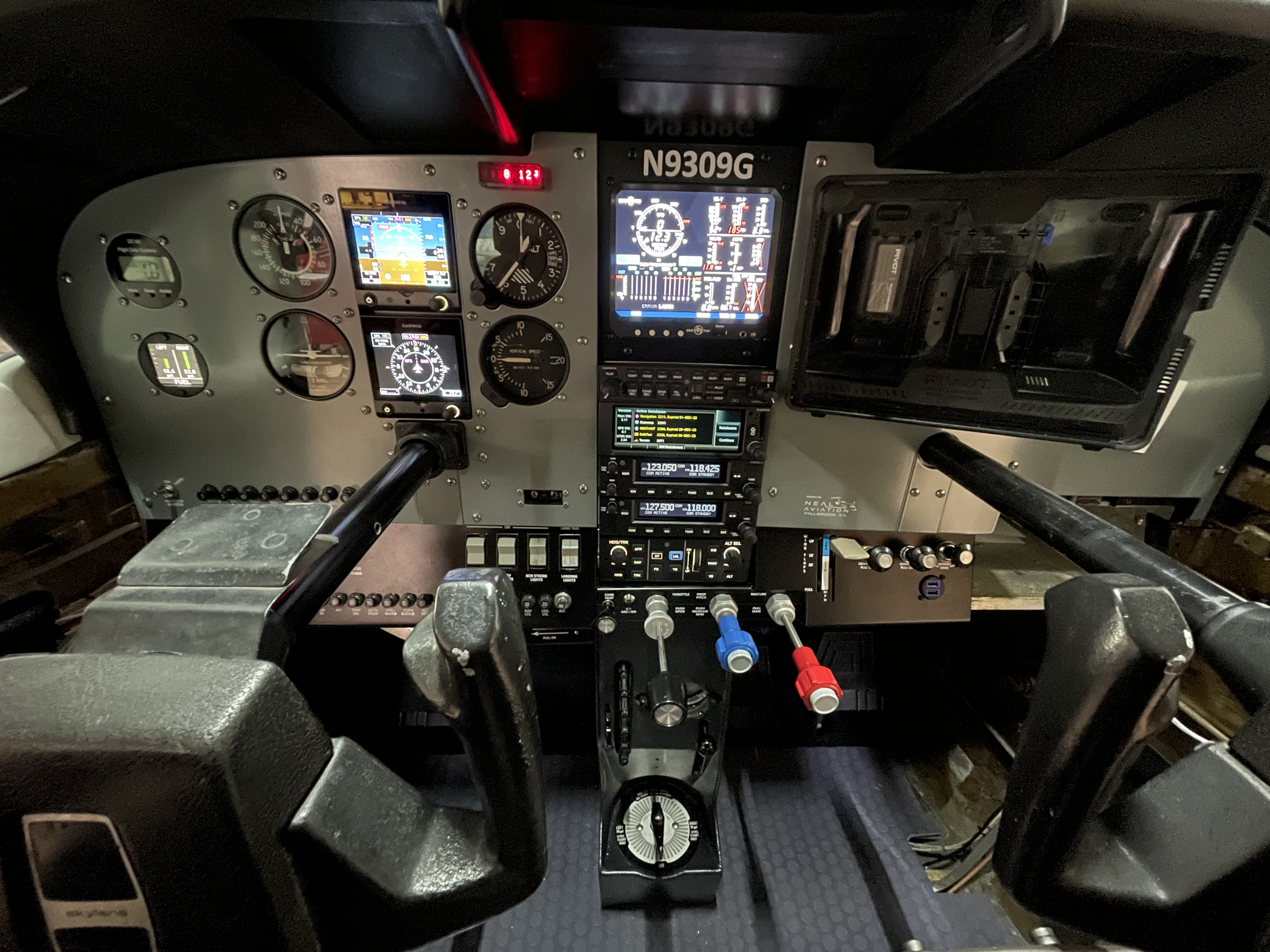

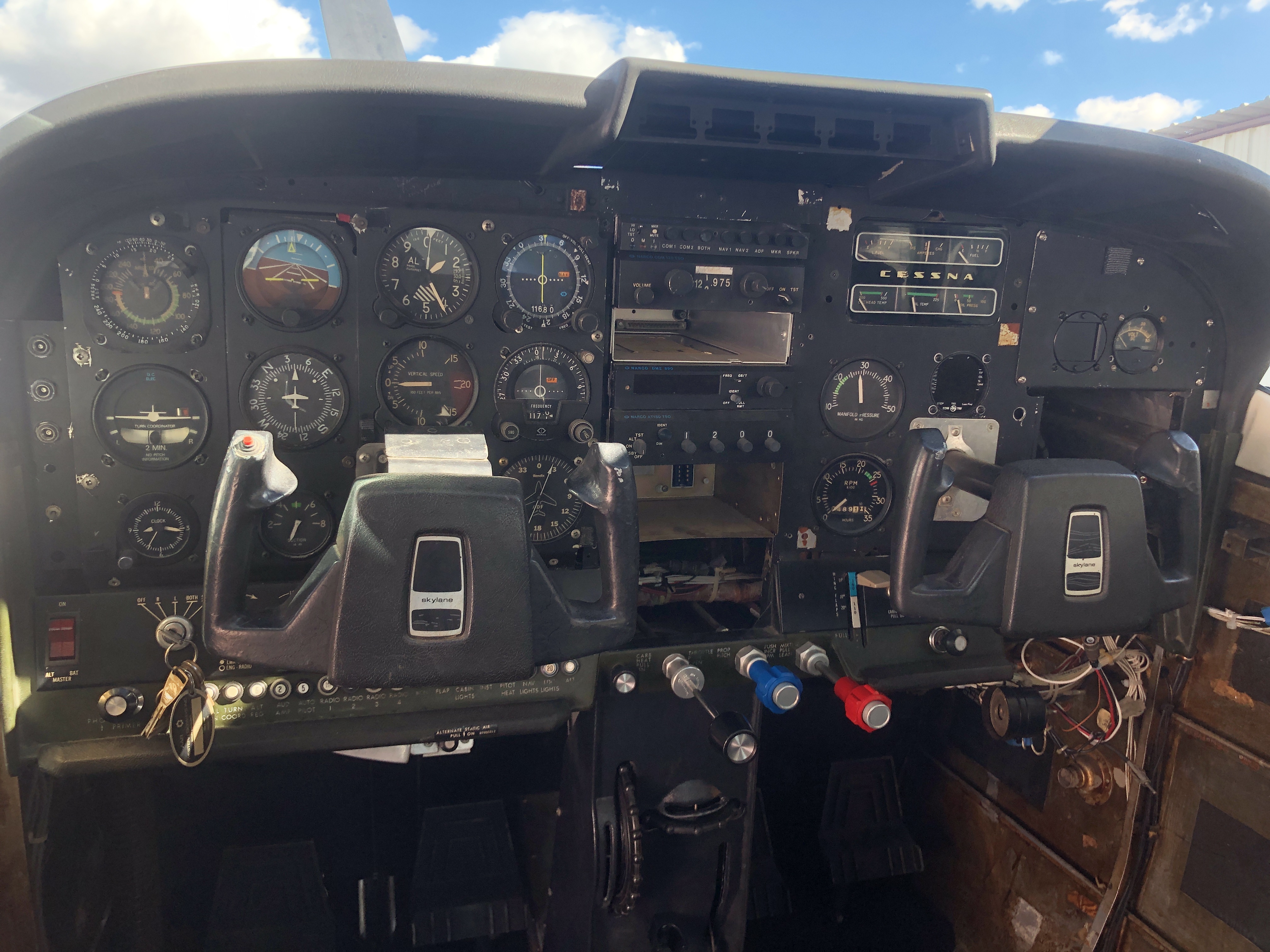

This turned out nice so I thought I would share.
Any guesses what 70’s IFR panel weighs?
Less the following: VSI, ASI, altimeter, turn coordinator all remained….

Perfect. Good work dude! What’re those things on far left?
Posts: 1533
Re: 182 Before/After Panel
asa wrote:Perfect. Good work dude! What’re those things on far left?
Thanks asa.
Chronometer, Aerospace Logic fuel gauge.
New CiES fuel senders with new Monarch main tanks feed the gauge.
I wanted isolated fuel info separate from JPI 930.

Re: 182P Before/After Panel

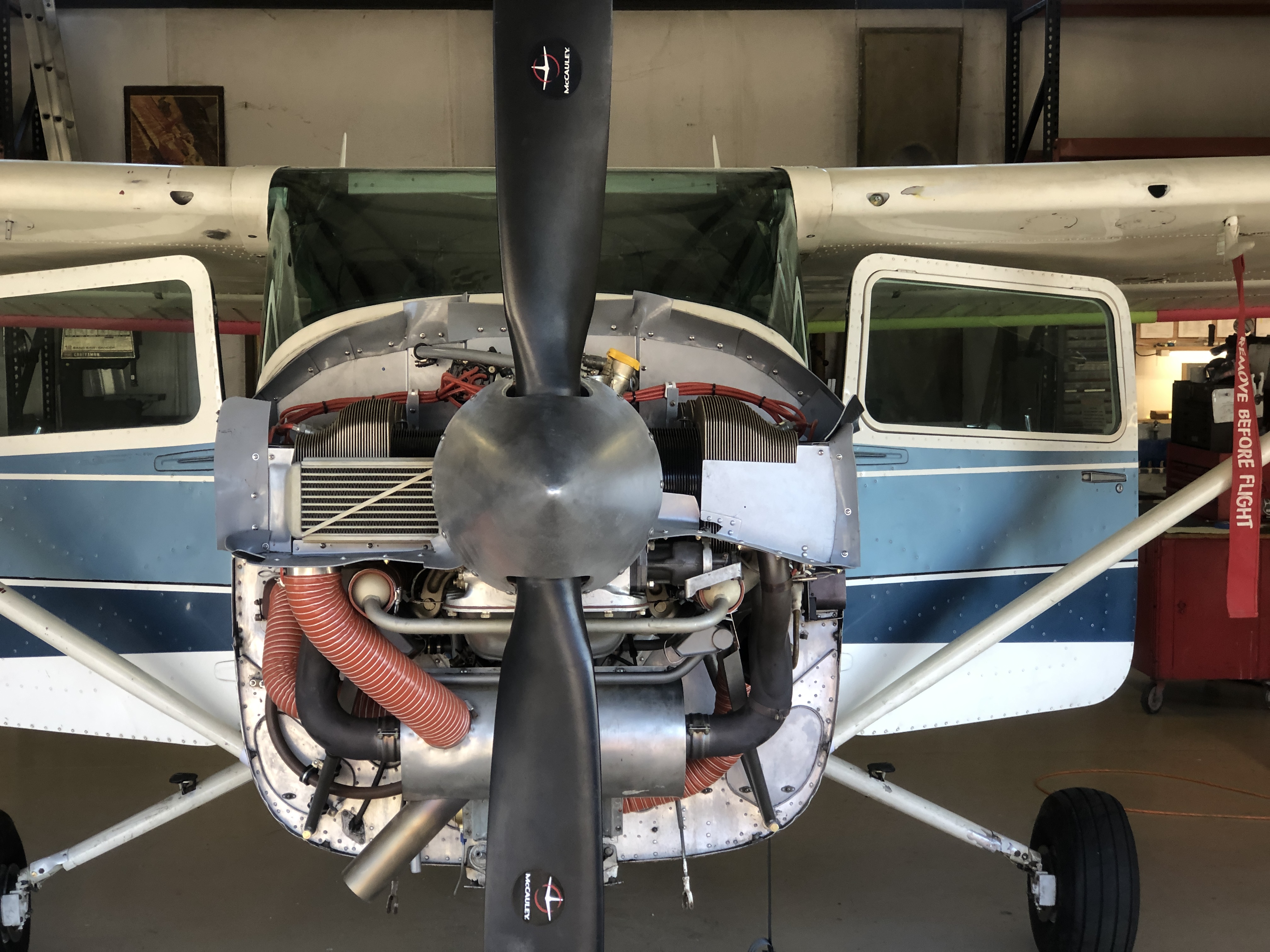

Firewall forward all refreshed also.
Nice job! What did you do on the lower panel? Is that an overlay or fabricated replacement. I find that to be the hardest part to decide. One big panel would be nice but a ton of work to remove the thr,pr,mix cables and make holes for ALL those switches.
frstnflt offline
Posts: 108
Joined: Wed Oct 30, 2019 4:07 am
Location: Mooresville
Aircraft: Cessna 185
frstnflt wrote:Nice job! What did you do on the lower panel? Is that an overlay or fabricated replacement. I find that to be the hardest part to decide. One big panel would be nice but a ton of work to remove the thr,pr,mix cables and make holes for ALL those switches.
It is an aluminum overlay which is a fabricated replacement.
All the plastic has been removed.
Needed to be done after spending what I did on the rest of it. Another 10% brought it home. Glove box door remade in the same aluminum.

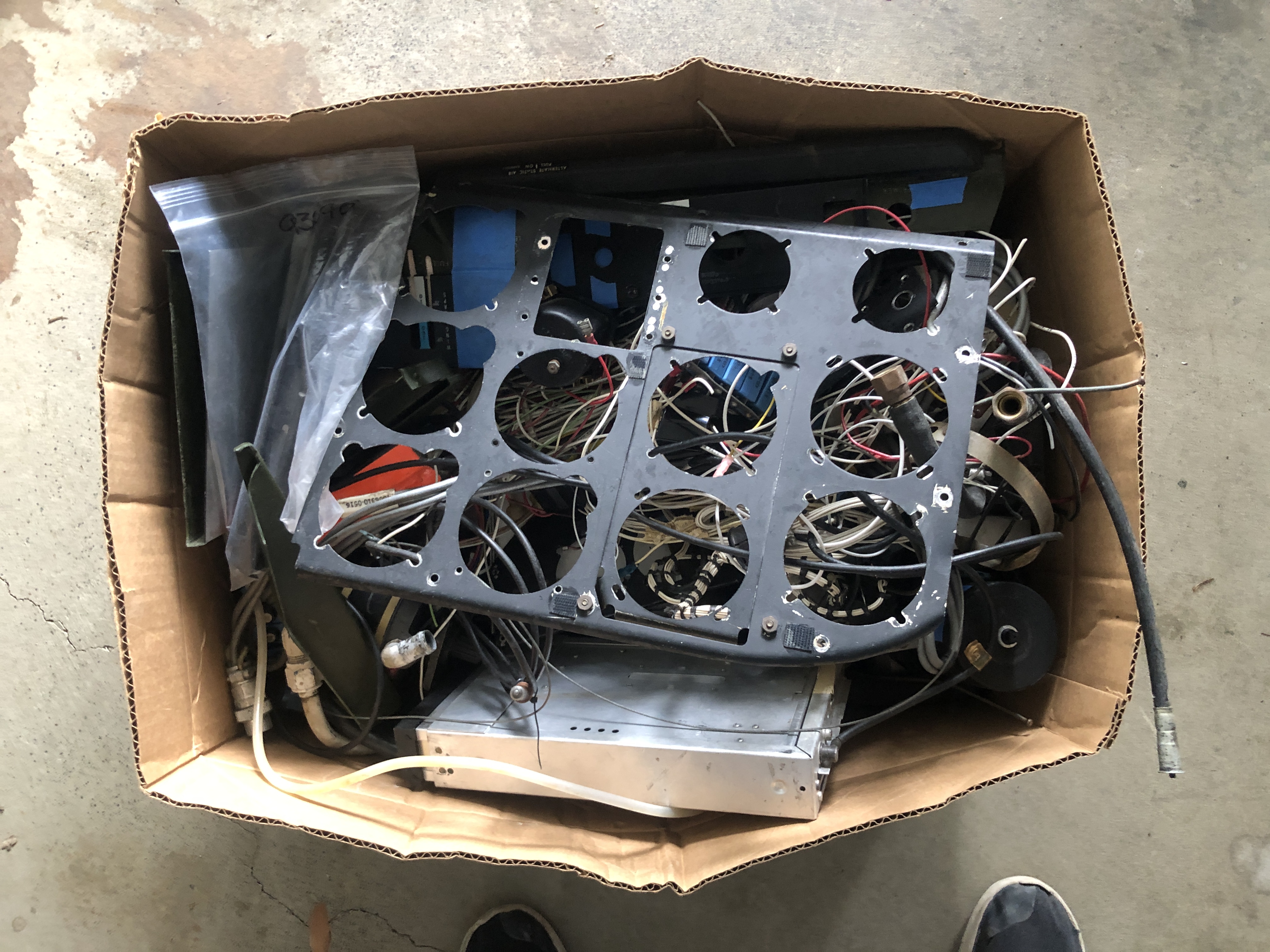

Guess the removed 70’s IFR panel weight?
skyward II wrote:Guess the removed 70’s IFR panel weight?
No idea...shot in the dark...32 pounds!
Posts: 2060
Great guess. 52 lbs including vacuum pump. It’s a heavy box.
Should help a bit with weight forward CG without passengers.
skyward II wrote:
How much did/does all of the new stuff weigh?
BigBen offline
Posts: 71
Joined: Thu Mar 11, 2021 9:36 pm
Location: Ephrata
Aircraft: Cessna 206e
I did not weigh the new parts and wire. I’m assuming I saved 30 lbs plus between the firewall and panel. Added servos in the tail are less than 10 lbs.
We did a new weight (weighed with scales) and balance once it was ready to fly.
You’re killing me Smalls. Really nice. I wish I could do that, but first up will be a FWF - over 1500 on my O470 with no problems, but …….
Simie580 wrote:You’re killing me Smalls. Really nice. I wish I could do that, but first up will be a FWF - over 1500 on my O470 with no problems, but …….
Hey, you only need one kidney, right? Life is short….
This aircraft was hangared in 1984 until I bought it in 2020. It had 485 hours on factory zero time engine and now 1 hour on IRAN so all good on that front. 2,7XX AFTT.
It’s been a 2 1/2 year journey.
Now all clear to finish up 170. Wings on this past week.
Yes, I’m crazy….
