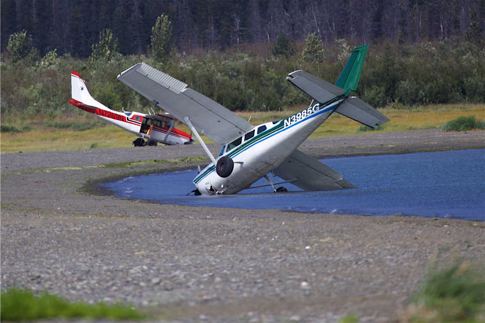

Wild Cessna 206's seen grazing in their natural habitat. Both have 850 nose and 29" mains.

asa wrote:Wild Cessna 206's seen grazing in their natural habitat. Both have 850 nose and 29" mains.
Ooofff that's a bad day. I feel like there must be a good story to go with that photo!

One of them had a gear failure while landing, not sure about the other one.

Hmmm, news article that the picture came from is a little different story, but either way, the nosewheel airplanes were inadequate for the conditions which should be a learning moment for anyone wanting to explore with a weak link up front.
"Both planes hit soft sand while taxiing."
"In both cases, the planes were on wheels and pilots were taxiing to move the planes to a harder surface."
https://www.homernews.com/news/two-bear ... nitna-bay/

Must have been a pretty brisk taxi for 85G... seems like a lot of bent metal.
