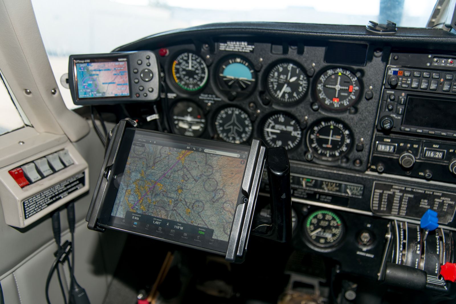

Lots of stuff we don’t NEED
This worked “good enough”
This is silly IMO, wonder if he watches the king videos while flying lol
